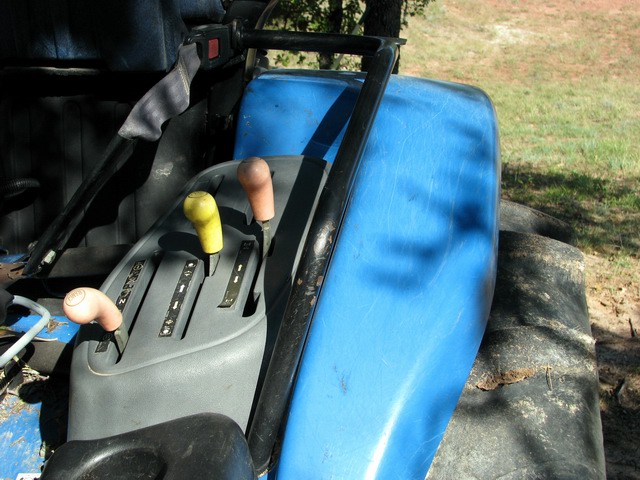

Okay, I didn't forget. . . a major accomplishment at my age.:eek:
The first picture shows the fender bolts attaching to the left fender. You can clearly see the rubber grommet "damper" between the fender and the washer. On the underside of the fender, the bolt head has a large washer on it but no damper. The rubber damper is only on one side.
The handgrip is quite different from the newer models. It gets its stiffness from the hard attachment to the ROPS. You can also see where the older style taillight and flasher mounted before I removed them. I just couldn't see letting the brush play T-ball any longer with my lights.:rolleyes:

That's my tractor in all its "glory." The scratches are from a limb lopper I carry behind the seat. Since the fenders are fiberglass, I don't have to worry about a scratch starting to rust. One of these days I'll build a proper holder for the loppers. . . probably right after all the paint gets scratched off.:eek:
