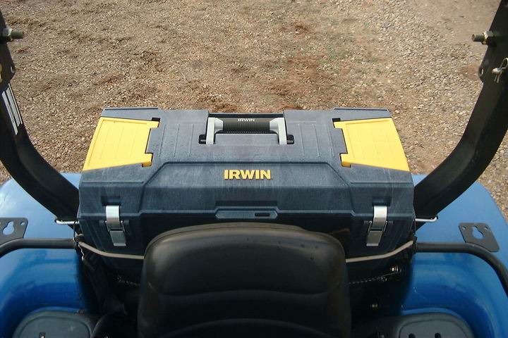

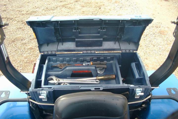

I know you are talking to Greg because his toolbox is diamond plate and mine is not, but I hope you don't mind me inserting a comment. I mounted a toolbox on my tractor (see attachments) and thought it would be great. I finally have removed it and will not put it back on. The darn thing was just too big and impossible to see behind the tractor. My boxblading improved 100% since I removed it. If you decide to add a toolbox behind the seat, make sure it isn't too big like mine was.

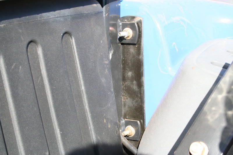

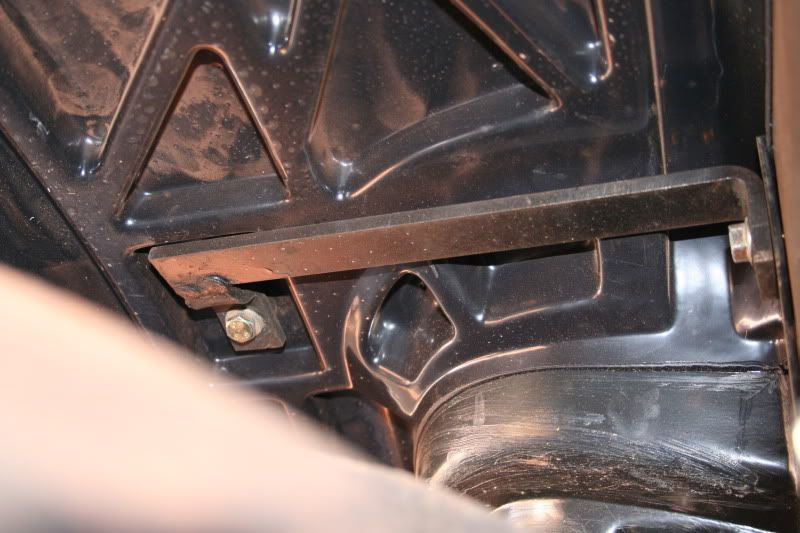

Sorry for the delay in getting the pics of the new fenders. They added a brace under each fender for support. I can really tell the differance when getting on and off. I have till June to work it hard and then the warrenty is up. I think this might do the trick.
Same brackets on the inside:
New bracket added under the fender:

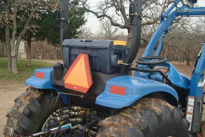

Flatheadyoungin: here's a better pic of my tool box. I can see over it to hook things up if I really lean back and raise up off the seat. Any wider and I wouldn't be able to do that. I really like the box as I now have a place for the BFH. :D

Does the brace have a NH part number or it is something the local dealer just made?
I see where it bolts on the bracket by the rops but did they drill a hole in the fender for the horizontal part of the bracket? Or did it bolt into the grap handle?
