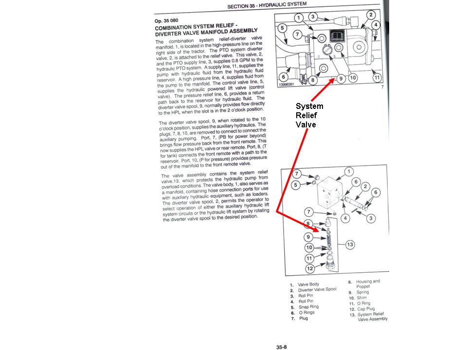

/ TC45DA Hydraulics Quit Working #8
Here are some illustrations and a photo that may help you. The first is the diverter valve under the right side operator platform. The red arrows point to the location of the system relief valve on the bottom of this block. You will have. Where 7,8, and 10 are shown on the top illustration, you have piping because this is where the loader attaches to the hydraulics.
The photo shows the main and PS hydraulic pumps (the big pump on the left is the main pump). I would not recommend trying to open the lines at the main pump as J_J suggested because they are flange fittings and you cannot attach a gage there. Do all your pressure testing at the diverter block or other piping with normal pipe connections.
If you have to remove the hydraulic pump, the pressure line on the bottom and the mounting bolts are a challenge. You'll need a 3/8" shallow socket set (metric of course) and a universal joint adapter because the 4 bolts holding the bottom flange on the pump are a bear to get to. You'll need a box end/open end wrench to get to the back side pump mounting bolts because it's a tight spot with the fan and belt interfering. Also, there is an oil line (pipe) behind the main pump that attaches to the engine block with a banjo fitting. The bolt has to be removed from the banjo fitting to allow the main pump to be pulled out of the drive flange on the engine.
