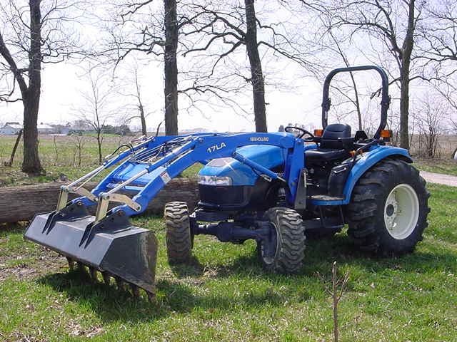

i was just wondering if any of you guys get your tractors dirty? ....tgello

tgello,
<font color=blue>i was just wondering if any of you guys get your tractors dirty?</font color=blue>
Yup, thats why no one has ever seen mine. /w3tcompact/icons/wink.gif Mom raised me to believe that it is socially unacceptable to allow others to see us or our possessions in a less then desireable condition. /w3tcompact/icons/crazy.gif/w3tcompact/icons/wink.gif/w3tcompact/icons/hmm.gif
Here's a pic after some cleaning ...

   / TD40D SS...Detaching 17LA FEL with tooth bar #17
Very nice, Dave! ...and did your mom also tell you to show off your supersteer every chance you get? /w3tcompact/icons/laugh.gif/w3tcompact/icons/laugh.gif
