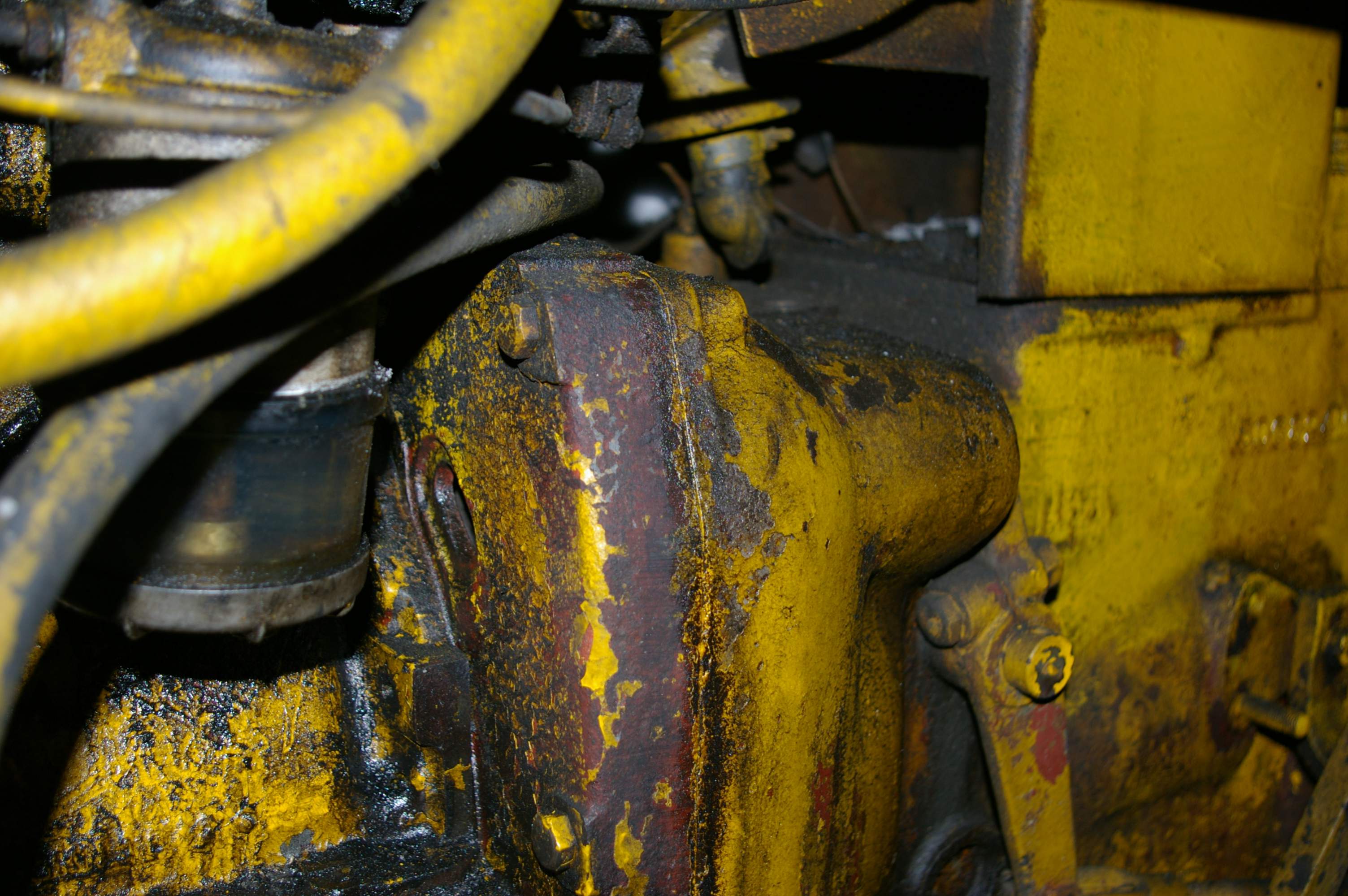

I'm just back from checking how the marks align and according to what you said the pump drive gear would be one full tooth off. With the 24 degrees mark aligned in the oval hole under the rubber plug on the engine adapter plate, the squared end of the circlip comes near the A mark in the pump and I can see the B mark a bit farther at the bottom inside the pump. If I get it right, it wmust mean that the engine as it is now was running with crazy static advance but that's good news since I may just get along by unscrewing the gear and trying to mesh it back on the right tooth. If somebody has been able to put it wrong with the timing cover installed, I may be able to undo the gear and put it back right... I hope...
Here are some pics in case it helps somebody someday. I have to say I had a badluck that turned to be a luck. The starter broke (too) so I checked the flywheel marks in the starter hole so I see better. I would have never found the marks looking in the timing hole because its location is so unconvenient... Here are the said marks:
Here is the timing hole hidden under a fuel filter... Good idea... I marked the 24 degrees mark with paint and it's the only way to see it.
So this weekend when it's bright outside I'll try to put the timing back on the right tooth and reinstall the refyrbished starter and see if there is a difference in the engine's behaviour...

G'day Gravvsy.
I appologise ,When i checked my shop manual I looked at the perkins 203 four cylinder engine ,yours is a three cylinder as said .
So engine on compression ,24 degrees before top dead centre number one cylinder, the front cylinder, looking through the pump inspection hole the letter E should line up with the scribe mark on the circlip ,the scribe mark is in line with the centre of the hole in the circlip, note the only way to reset the pump timing is to remove the front of the tractor to access the timing cover, the gear cant be JUMPED a tooth with everything in place, the pump drive hub has a slot and the gear has an alignment pin ,this is so that the pump can only go in the correct position but in saying that I have looked at a tractor that had the pump replaced and the installer had lined up the pump hub wrong and had tightened the three pump drive retaining bolts and FORCED the alignment pin back out through the timing gear ,may be worth checking if the pump timing is out, again if the engine is running as you say it sounds like it may be addicted to "aerostart" easy start , ether etc, Long time ago I found a good use for these products generally they are excellent for cleaning pump internals ,carburetors alternators etc but definitly should not be used on the perkins engine even when the outside temp is below freezing,with a GOOD strong battery these engines will start very easily.

I looked back in my manual and found too that it was the E mark on three cylinders. Hopefully I haven't dismantled anything yet. I also thought I may not be on the compression stroke so I'll recheck it tonight by giving another flywheel turn: I'll have more time since I don't have to plow today. The pin pushed back hypothesis is to be considered for sure. If there's not enough space to jump a tooth in the timing cover that's the last thing that could be wrong, but the manual says to wedge the gear when removing the pump so it doesn't move... If tooth can't be jumped what is this precaution for?

If you have to remove the access plate to get to the pump drive gear ,the one with the engine oil filler cap when you look inside you will see what I mean, it may be refering to the damage that would be caused if the engine was cranked with the gear disconnected ??.

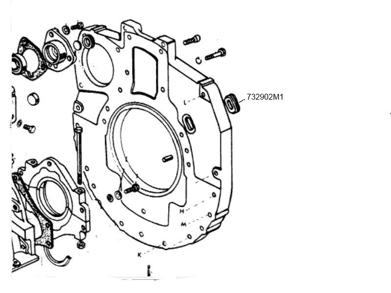

Hi,
I'm new to this forum and to tractors as well. My brother in law dropped me an old MF 135 with a loader in front and a snowblower so I can clear my parking with it this winter. I'm a heavy road truck mechanic so he expects me to make this old thing run better when he gets it back at spring.
I have to admit that I think this tractor is an absolute pile of junk, for it looks like it has never been maintained at all in its whole life, except when something blew... Everything is loose and leaks and every hose looks like it will blow soon. I'd mostly like to have the engine working fine at first and that's why I'm here.
I'm trying to check the fuel pump timing (it is a Perkins AD3 152), because the engine is almost un-startable, it smokes badly when I give it throttle, it runs like crap (certainly not on all 3 or it is de-timed) and it sounds like it exhausts in the intake at low RPM (I can't say idle because it's too rough to be called so). Somebody cut a hole in the end of the air filter so it stops to be thrown out of its housing!! I've been told the fuel pump has recently been removed and supposedly the tractor runs bad since then.
I'd need advice to find the timing marks; I can't use the crank pulley key for reference since the hydraulic pump drive parts would need to be removed and to do so I need to dismantle the whole front of the tractor (parts are all welded together...!?) and I have to work on it outside in the snow bank... No crane, no cherry picker, no hoist... The manuals I have states there is a TDC mark on the flywheel but doesn't show an picture of it. I tried to find something by looking in the big hole under the flywheel housing but I can't find a mark...??? Am I looking at the right place? Is there another hole in the flywheel housing for timing? Does somebody have a picture of this timing mark? Does it really exist? Also, id there an intelligent way of turning the engine other than by the crank pulley?
Finding timing marks on the flywheel is my last chance to check if I can make this thing work "not too bad" so it can be used as a snowblower again. If I can't make it start in the winter and it's not powerful enough to use the snowblower I'll just send it back in the woods where it laid before it took space in my yard...
Thanks in advance for your help!!
To answer this question: the flywheel timing marks on the Perkins AD3.152 can be viewed by removing the Timing Hole Adapter Plate Plug (rubber). The plug (part #732902M1) is located on the Transmission Adapter Plate as shown: PerkinsAD3-152_TransAdapterPlate.jpg

Hi, I had one of those pumps apart recently off a 4cyl Perkins to clean water, rust and all sorts of ugly c**p out of it, washed it up and fitted a seal kit and transfer pump vanes, back onto engine with filters and cleaned-out fuel system .... runs like a Swiss watch. I also learnt to overhaul them during my apprenticeship (decades ago) but this is only the second one I've dismantled since then.
I believe I can understand what is causing the puzzle regarding injection timing. Those lines are marked A through to H. Line A is currently on the circlip. Turn the engine one full revolution and line up at 24deg again - then line E should be on the circlip lower end. Loosen the pump and set it to correct position if necessary, but in one of those engines the timing would need to be way off to cause what you are describing. Everything else Shona said about them is correct - they are almost indestructible and only neglect will kill them.

thank you for posting this schematic... we have just re-started our AD3-152 after a top end clean up.... tank was removed and cleaned, the new plugs, wires, points, condensor and cap plus a new coil were added and she fired up but seems to need timing... -and I could find no marks like others --- now will look for the rubber plug and bring our timing light to the farm, to try to smooth this old girl out... We're able to use non-ethanol gas so I think we'll get this in proper tune once it is timed. Many thanks.
