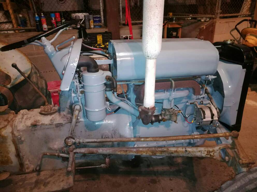

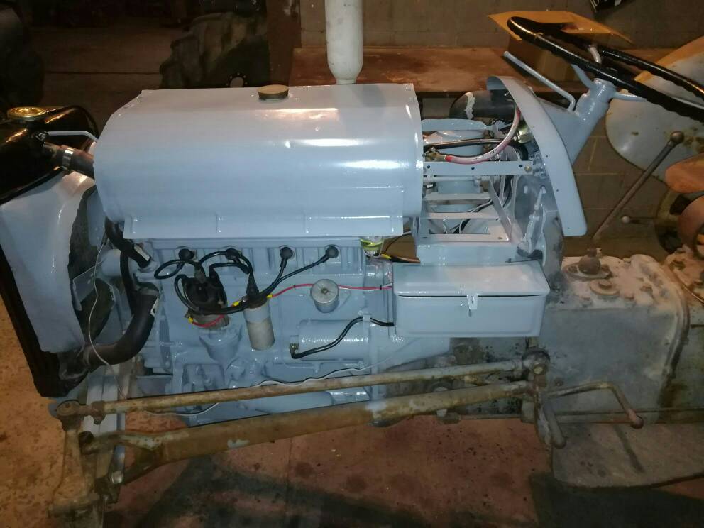

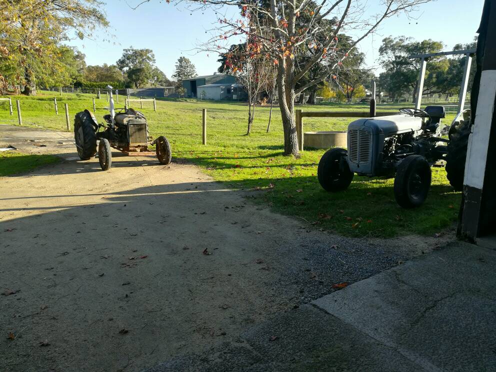

Put the sprayed rocker valve cover and tank back on.
Add a nice pic I like of both the tractors out front of shed. IMG_20190624_195446_resize_7.jpegIMG_20190624_201008_resize_36.jpegIMG_20190608_153605_resize_19.jpeg

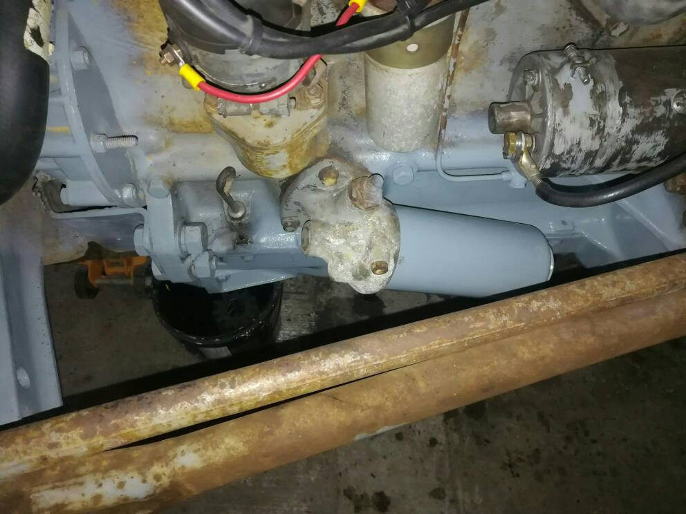

This weeks update;

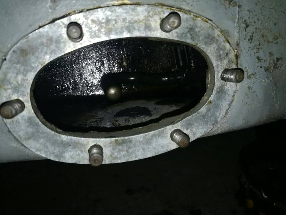

Decided to drop the engine oil and change oil filter. All went well until I put the sump oil plug back in. Previous owner had stripped the plug
Called around many places and unfortunately getting a tap which was 1" is just to cost prohibitive. Currently solution is Permatex ultra black on the inside of sump and on the bolt. I'll find out tomorrow if that doesn't work....
Anyone else have any ideas? Would love to hear how people get around this!!IMG_20190629_160146_1_resize_77.jpegIMG_20190629_160216_2_resize_36.jpeg
   / TEA20 Grey Fergie Restoration
#13

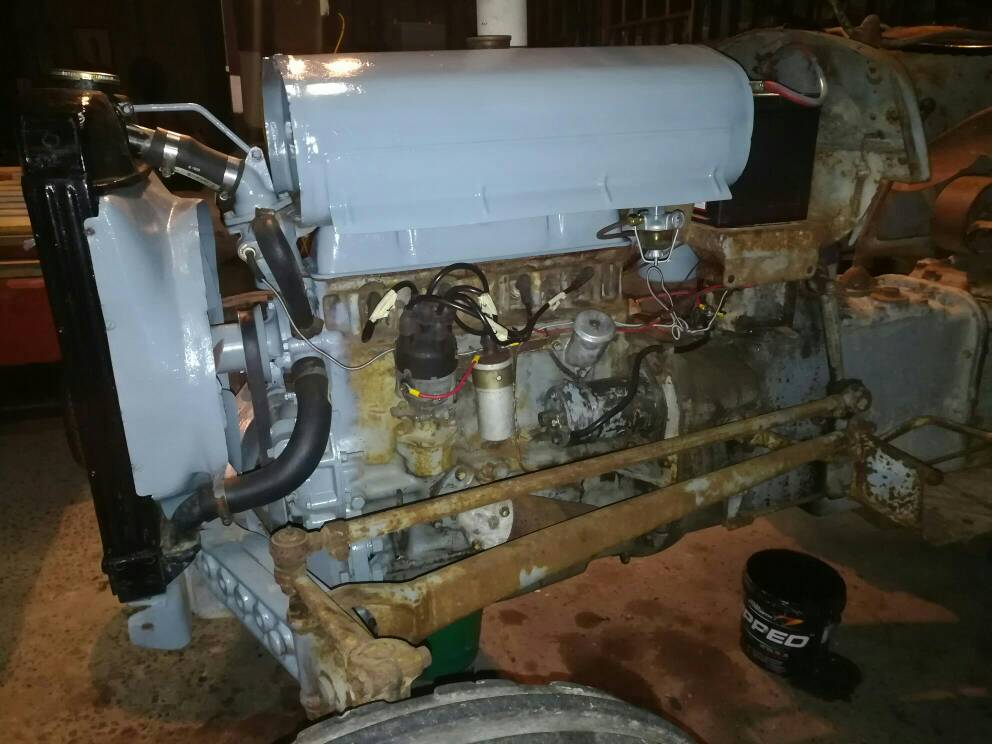

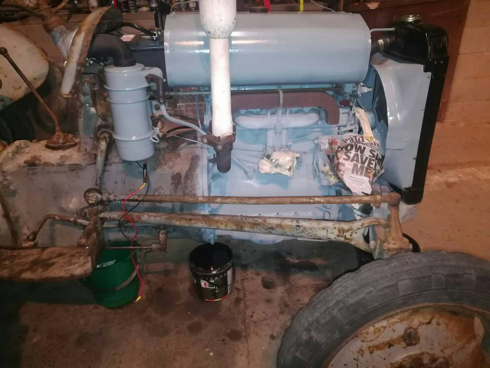

Quick update.
I used Permatex ultra black gasket maker on the sump and plug and it's holding up and not leaking. That's a bonus!!

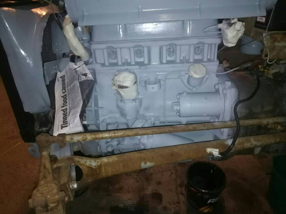

Also sprayed the engine with primer ready for top coatIMG_20190705_201853_2_resize_17.jpegIMG_20190705_201905_2_resize_58.jpeg

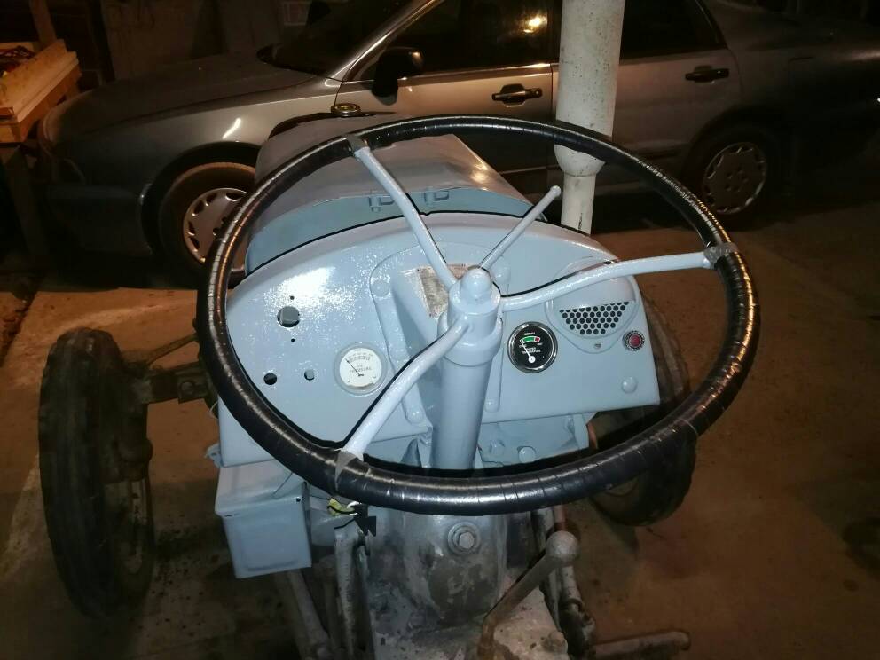

#15
Thanks wagtail
Did a bit more prep work and this time primed the dash and battery tray areaIMG_20190707_174045_1_resize_90.jpegIMG_20190707_174101_2_resize_33.jpeg

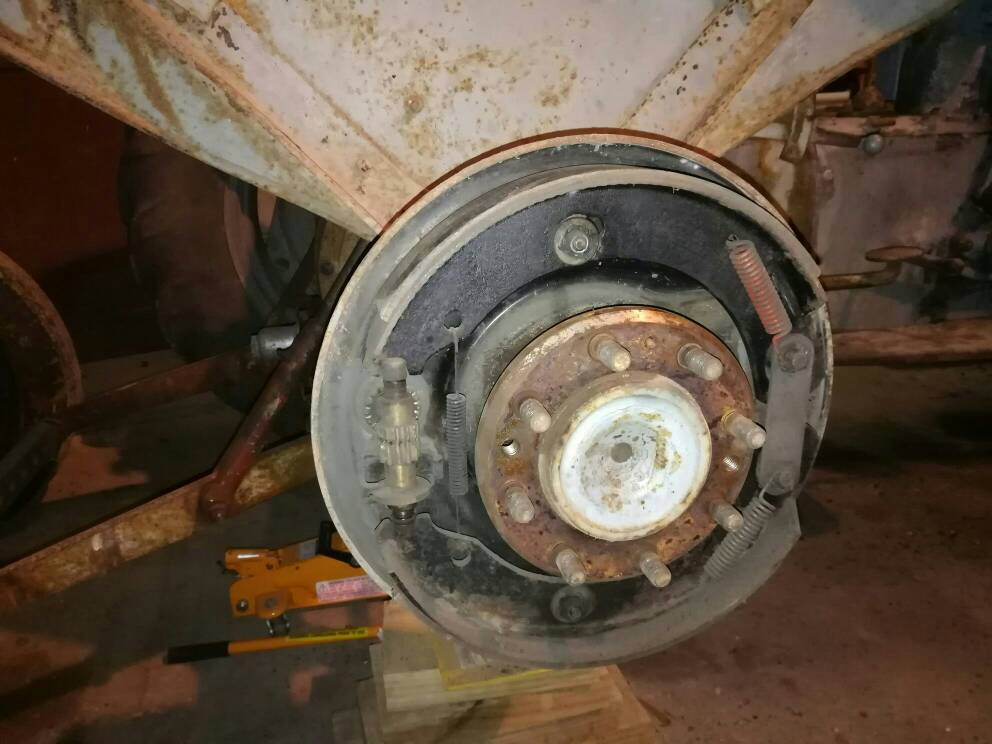

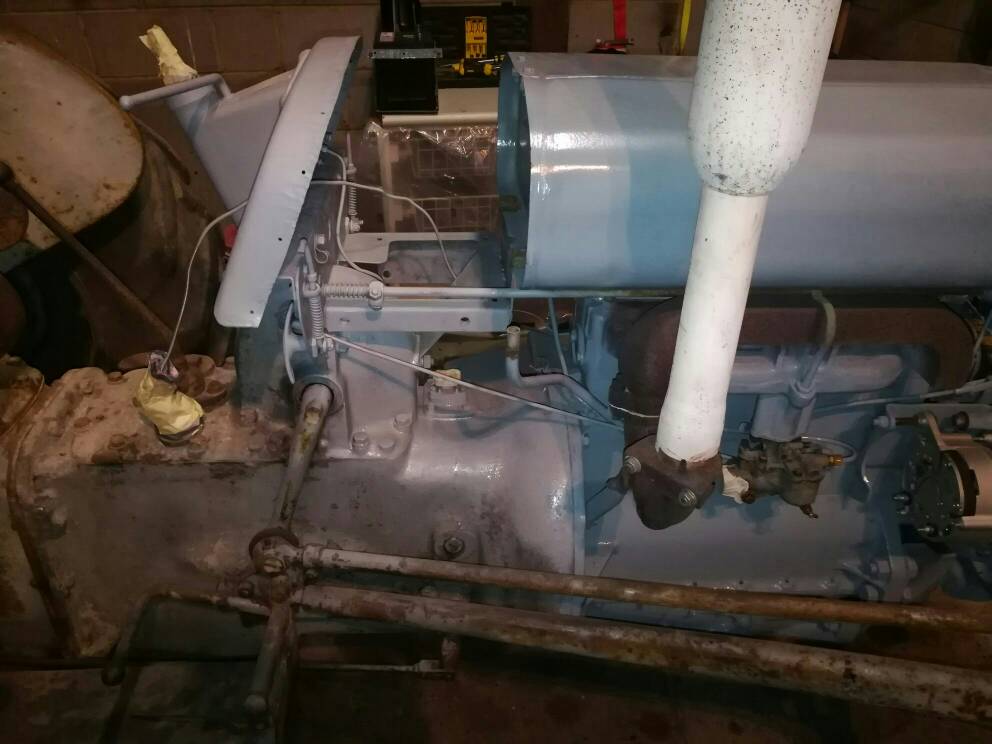

#16

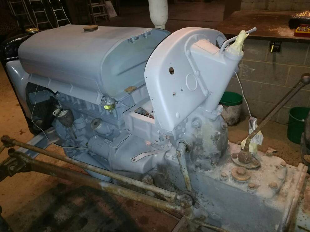

Sprayed the upper half and starting to put it all back together.

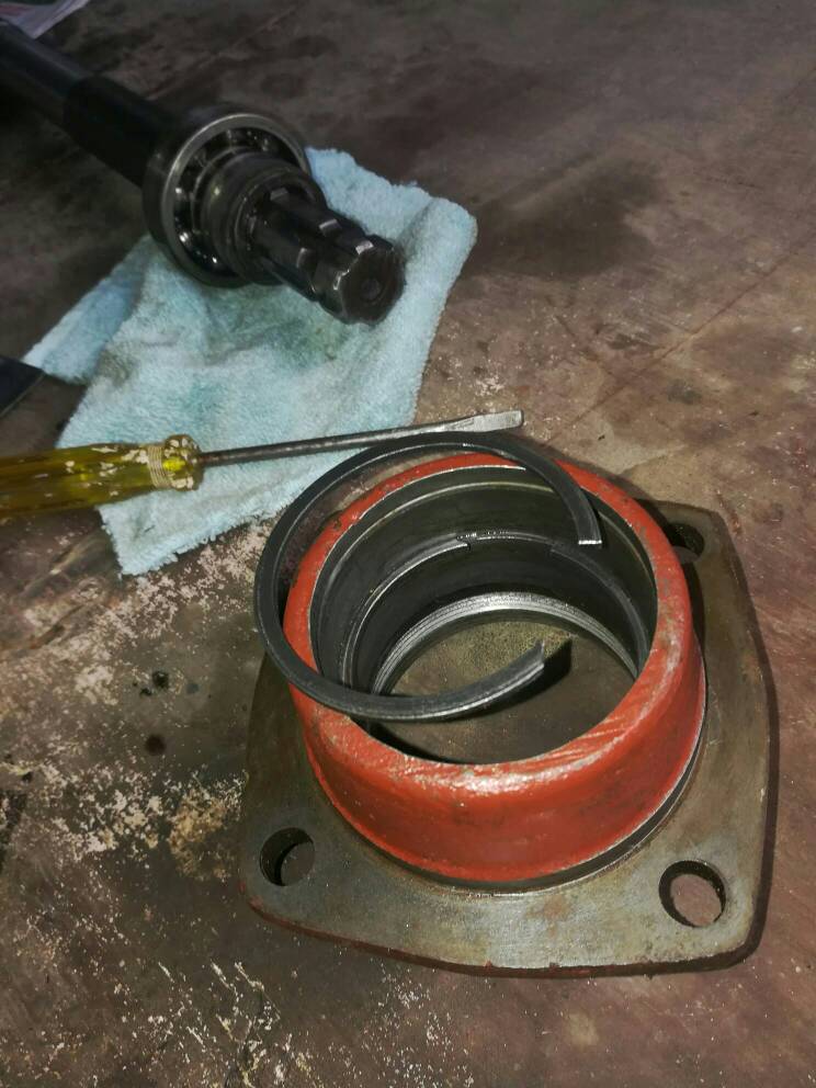

Also removed rear wheel so I can fix a puncture. Surprisingly the brake shoes still have life left in them. There is a slight leak though so once I move onto the rear I'll address that. IMG_20190709_210957_1_resize_82.jpegIMG_20190709_211035_1_resize_67.jpegIMG_20190709_211013_1_resize_30.jpegIMG_20190709_211027_resize_30.jpeg

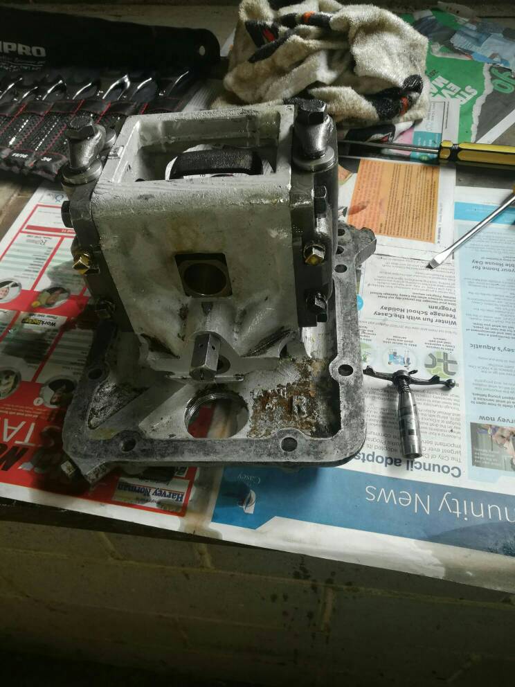

- the pto arms were stuck up and when turning on the tractor would remain up. Pulled the side covers and found the control valve had separated from the forks. Problem was I couldnt pull out the control valve by hand so I had to drop the pump.
Couldn't believe how Much debris and mineral deposits were in the bottom of the casing. Cleaned it up and relubed the control valve. Feels perfect with some resistance.
- had a leaking pto shaft so in the process of replacing the seal

- got the gaskets I need the hydraulic pump housing so I put everything back together also with a new seal for the pto. That's done the trick with no leaking and also I have fixed the issue with the arms stuck up
