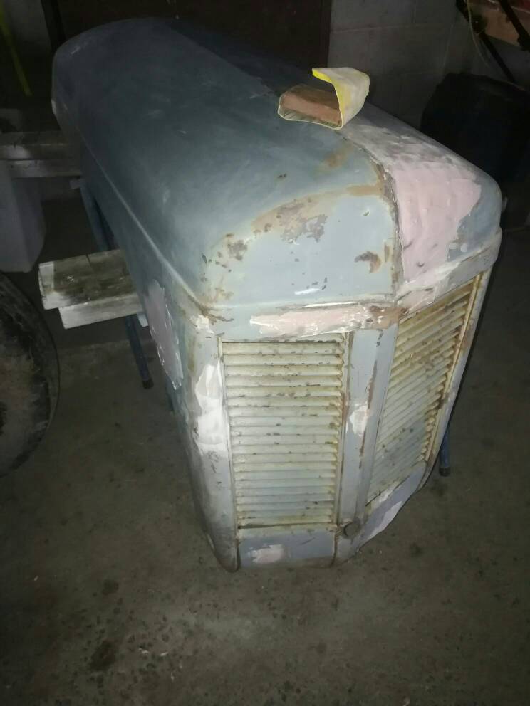

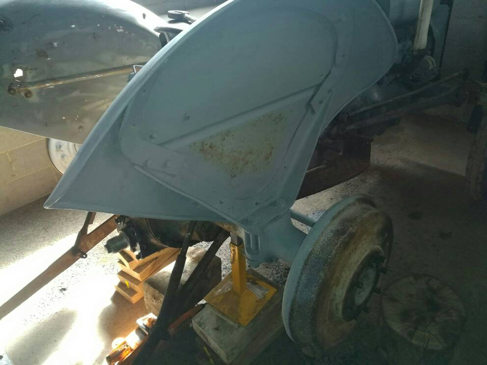

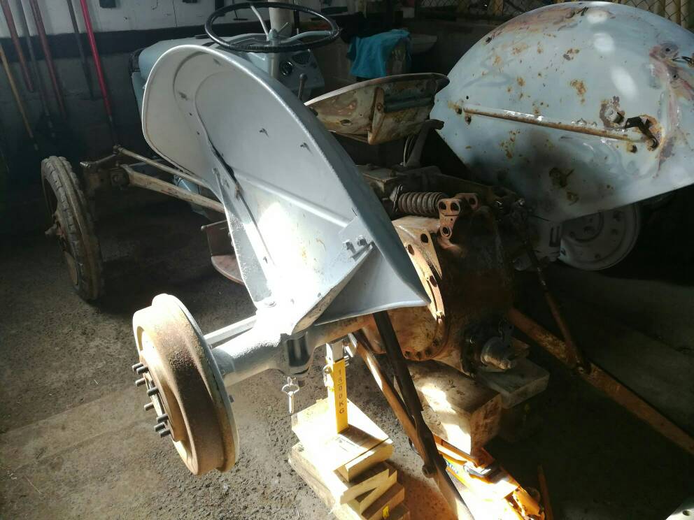

Did a little more this weekend
- cleaned and and roughed up the who body ready for painting. Got a little primer on the guards
- while I had the wheels off I noticed quite a few studs had come loose and hence the reason for the leaking hubs. One of the bolts was snapped but I think I'm going to leave it for a while. There is only a tiny leak as it's the very bottom one. Nothing major. IMG_20190818_125456_resize_12.jpegIMG_20190818_125508_resize_59.jpeg

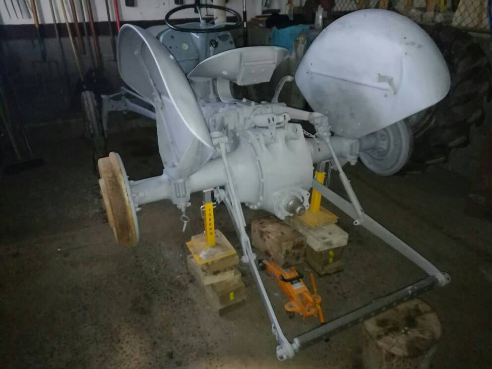

#23

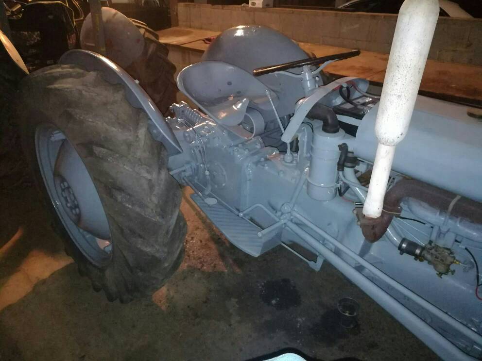

Sprayed primer on the body...Next will be the wheels and the hoodIMG_20190823_173748_resize_22.jpegIMG_20190823_173737_resize_31.jpegIMG_20190823_173801_resize_83.jpeg

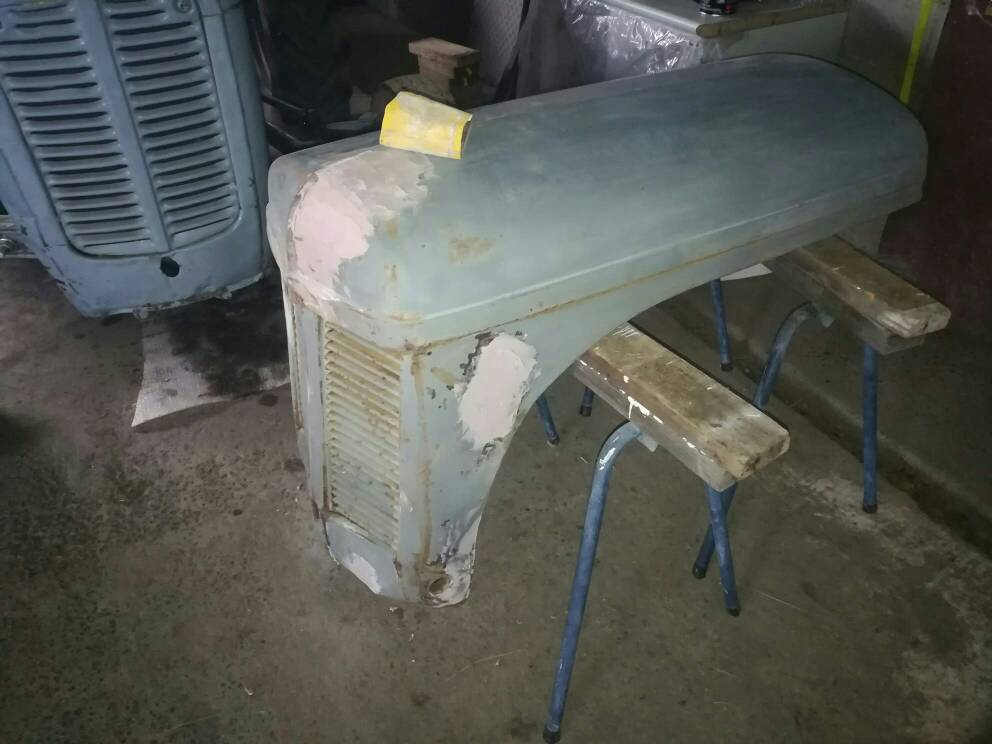

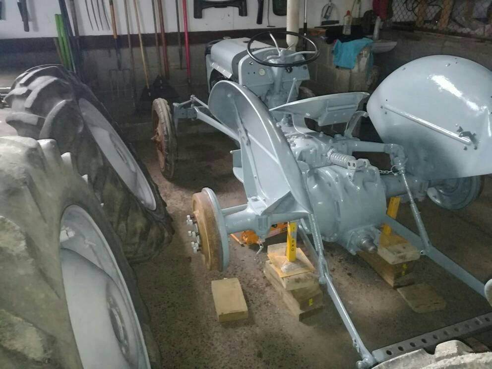

#24
Final coat on the body
Primer on rear wheels
Then just need to do the front wheels and hood and we are done
   / TEA20 Grey Fergie Restoration

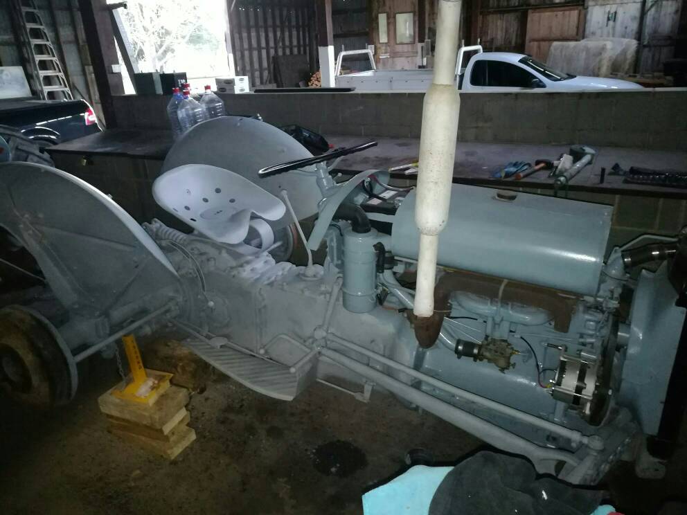

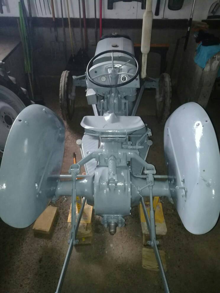

#26

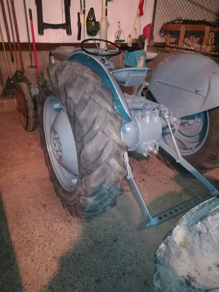

Sorry about the poor lighting....Sprayed the wheels and a few little bits and pieces.
Just have the front wheels and hood left to do. And also buy some new chains for the lower arms for the rear. IMG_20190825_205838_resize_62.jpegIMG_20190825_205827_resize_56.jpegIMG_20190825_205805_resize_87.jpeg

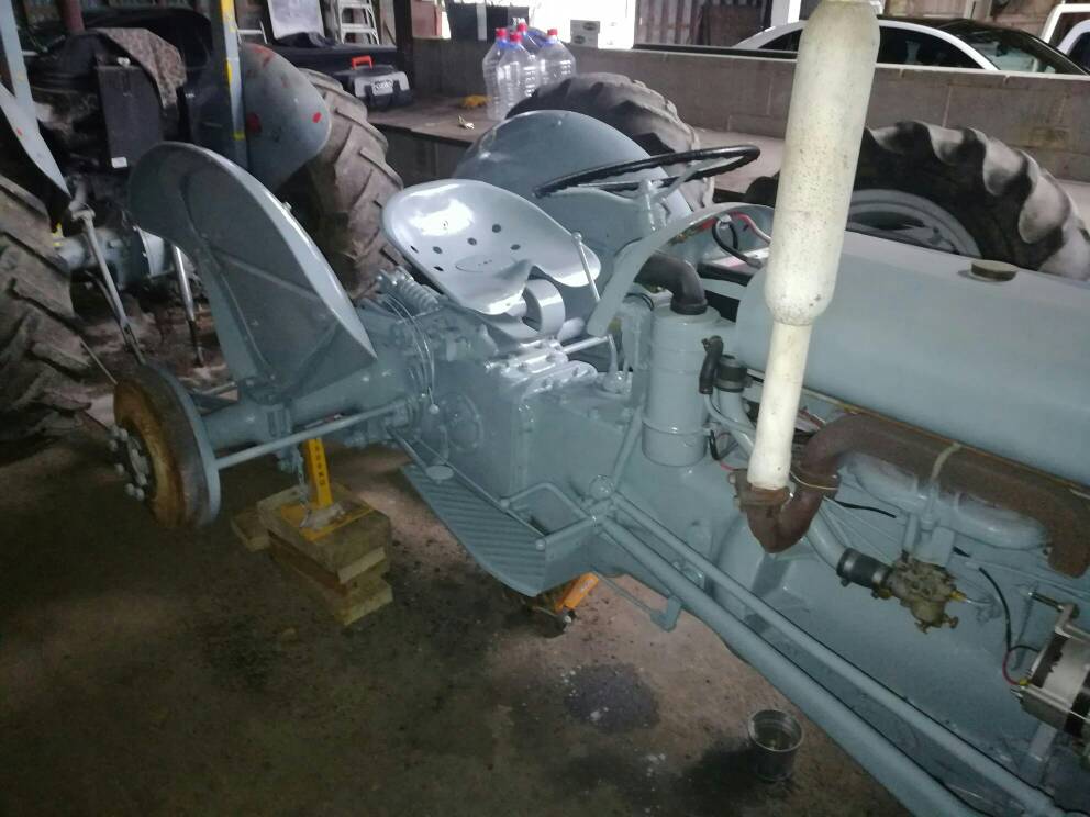

#27
Got the wheels primed and started to prep the bonnet as well. Had to weld new metal to where the headlights were because the brackets had rusted through.
Also got new stay chains for the lower arms but don't have a photo yet. IMG_20190901_075318_resize_94.jpegIMG_20190901_075329_resize_31.jpegIMG_20190901_075308_resize_95.jpeg

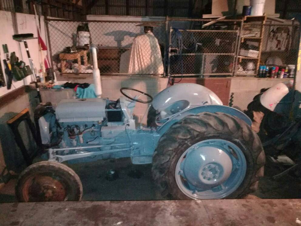

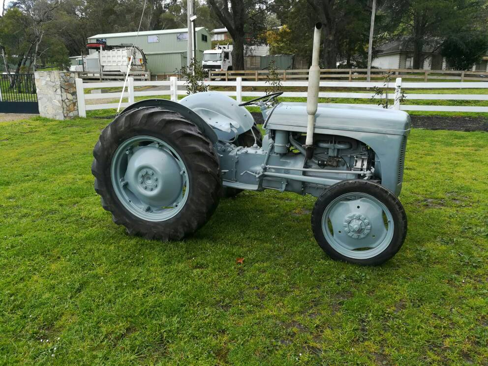

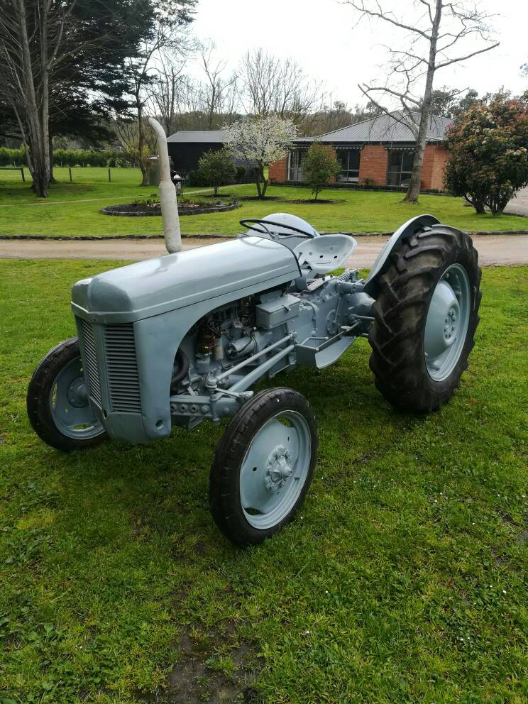

#28

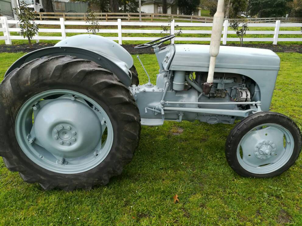

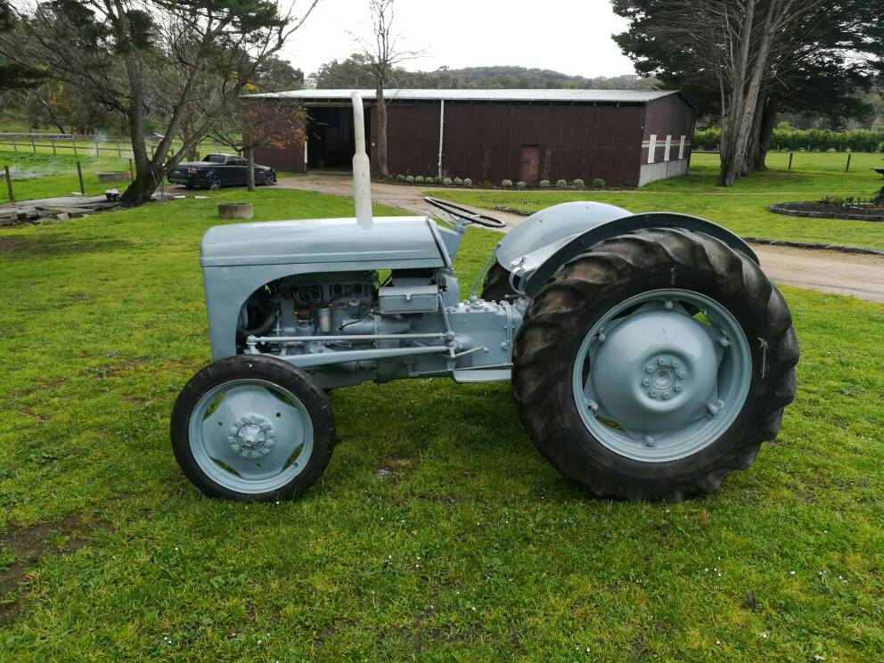

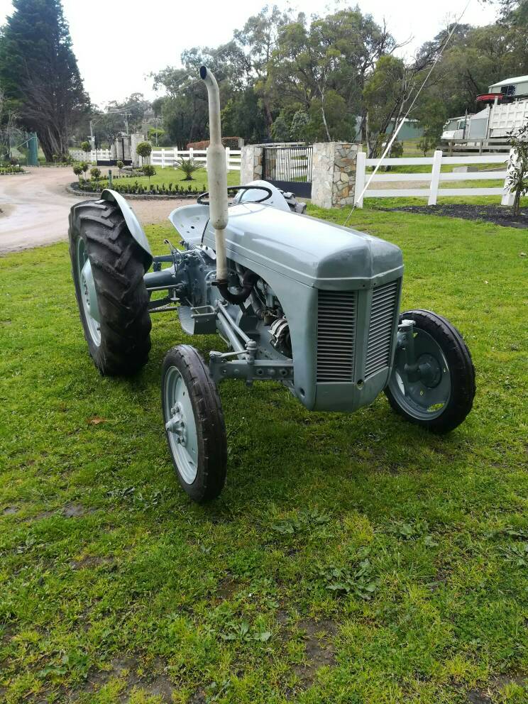

Well today marked a major milestone!!! I have finished the restoration and I can safely say I'm quite pleased with the results.
Is it perfect? No. Does it have a few dings? Yes. It wouldn't make a purist excited but I have plans to use it through the drier months her in Australia rather than it sitting in a shed collecting dust.
I'm sad to have finished but now maybe the mf35 will get some attention
Thanks for everyone following!IMG_20190907_162741_resize_57.jpegIMG_20190907_162734_resize_44.jpegIMG_20190907_162726_resize_38.jpegIMG_20190907_162824_resize_38.jpegIMG_20190907_162814_resize_84.jpegIMG_20190907_162748_resize_77.jpeg
