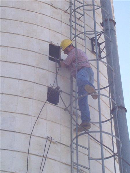

I had a couple taken down, not a problem, 2 ways to do it. One guy took a sledge, knocked out every other block in the direction he wanted it to fall, only half of the silo though. Then strung a heavy steel cable, hooked to a 100 hp tractor, thru the dia of the silo and started to pull. By pulling he popped out the remaining blocks, the silo laid down with a crash,,,,,,,, make sure you use plenty of cable though, If this makes you nervous, maybe you could get that ex to drive the tractor.
Later, I'll post a better way to do it.

We attached a cable at the top, caught a couple of hoops.
