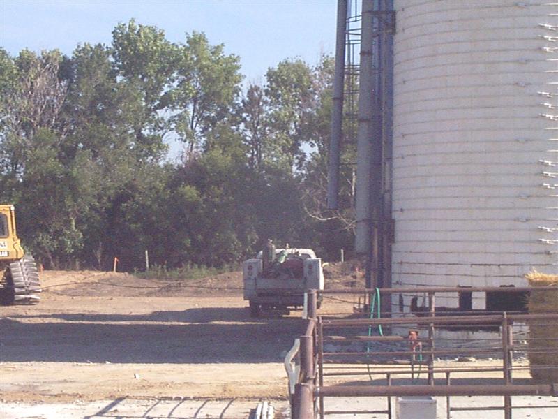

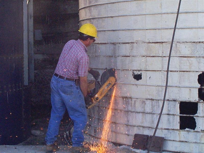

Next we cut some of the bottom hoops, note the hole opposite each other, only one shows in the picture as the other is on the other side. We fed a cable thru the holes, had a small crawler on the other end, this popped the staves out.

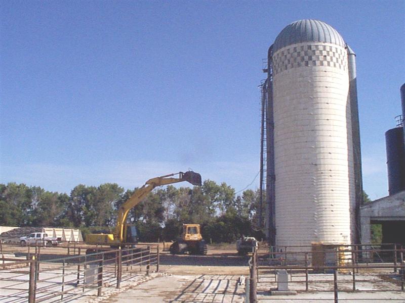

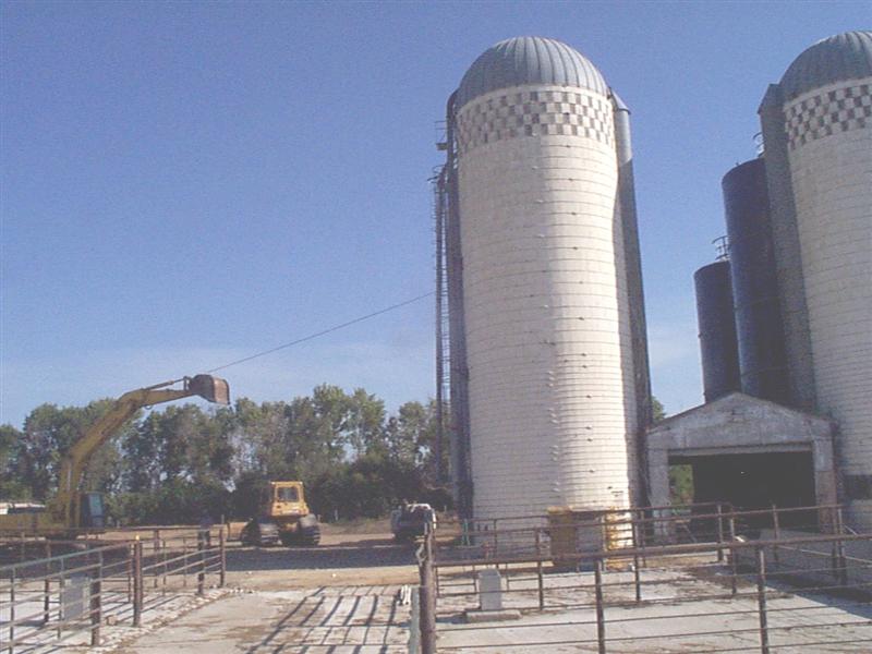

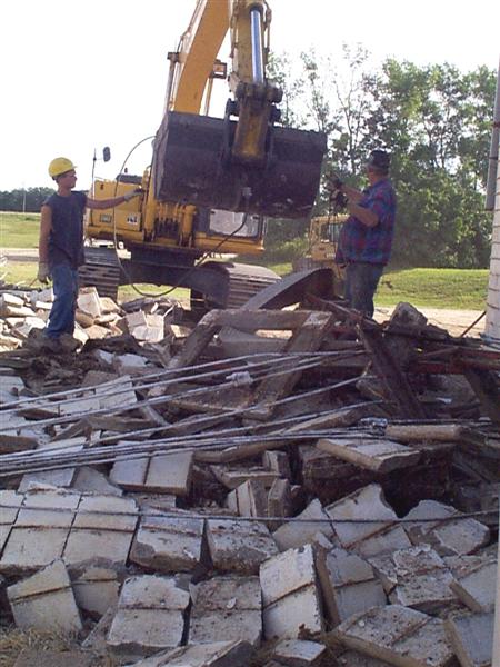

Next we attached the cable from up above to the excavator, to direct the fall of the silo.

   / Tearing down cement block silo..... #33

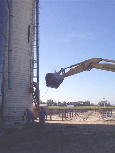

Cable at the bottom

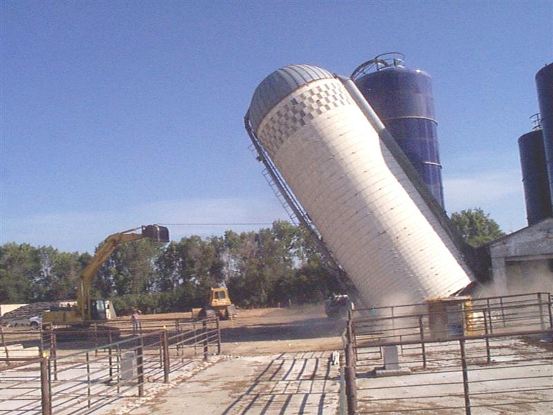

   / Tearing down cement block silo..... #36
Staves popping out

   / Tearing down cement block silo..... #37
The excavator came in handy here, maybe a bit to close though!

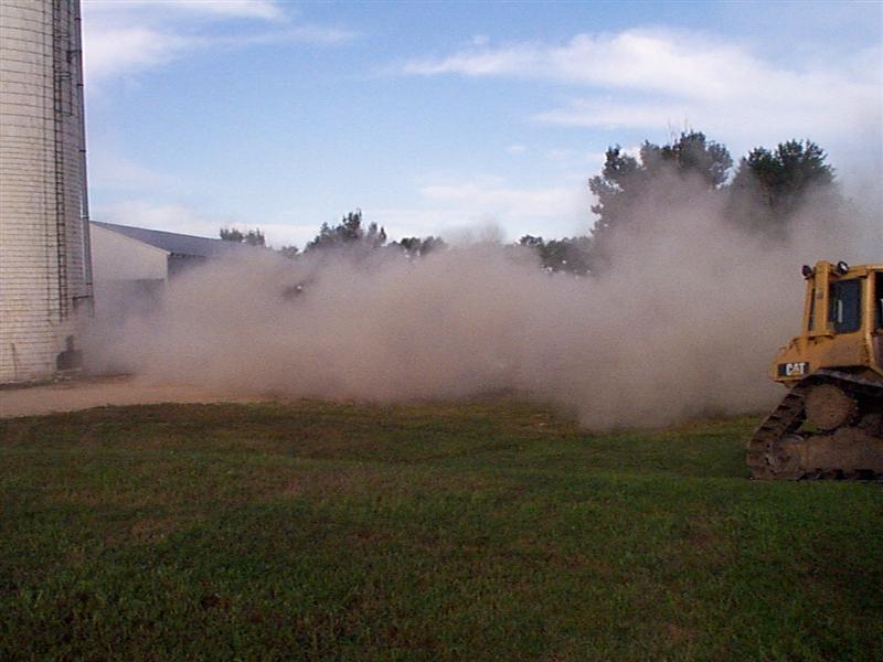

Makes a little dust

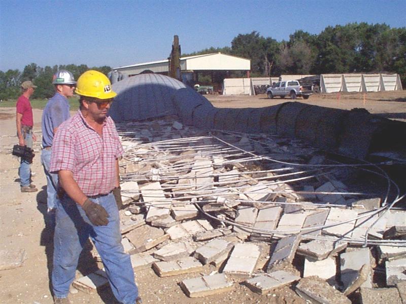

after the dust settles
   / Tearing down cement block silo..... #40
an 18' x 70' made about 4 trips to the dump
