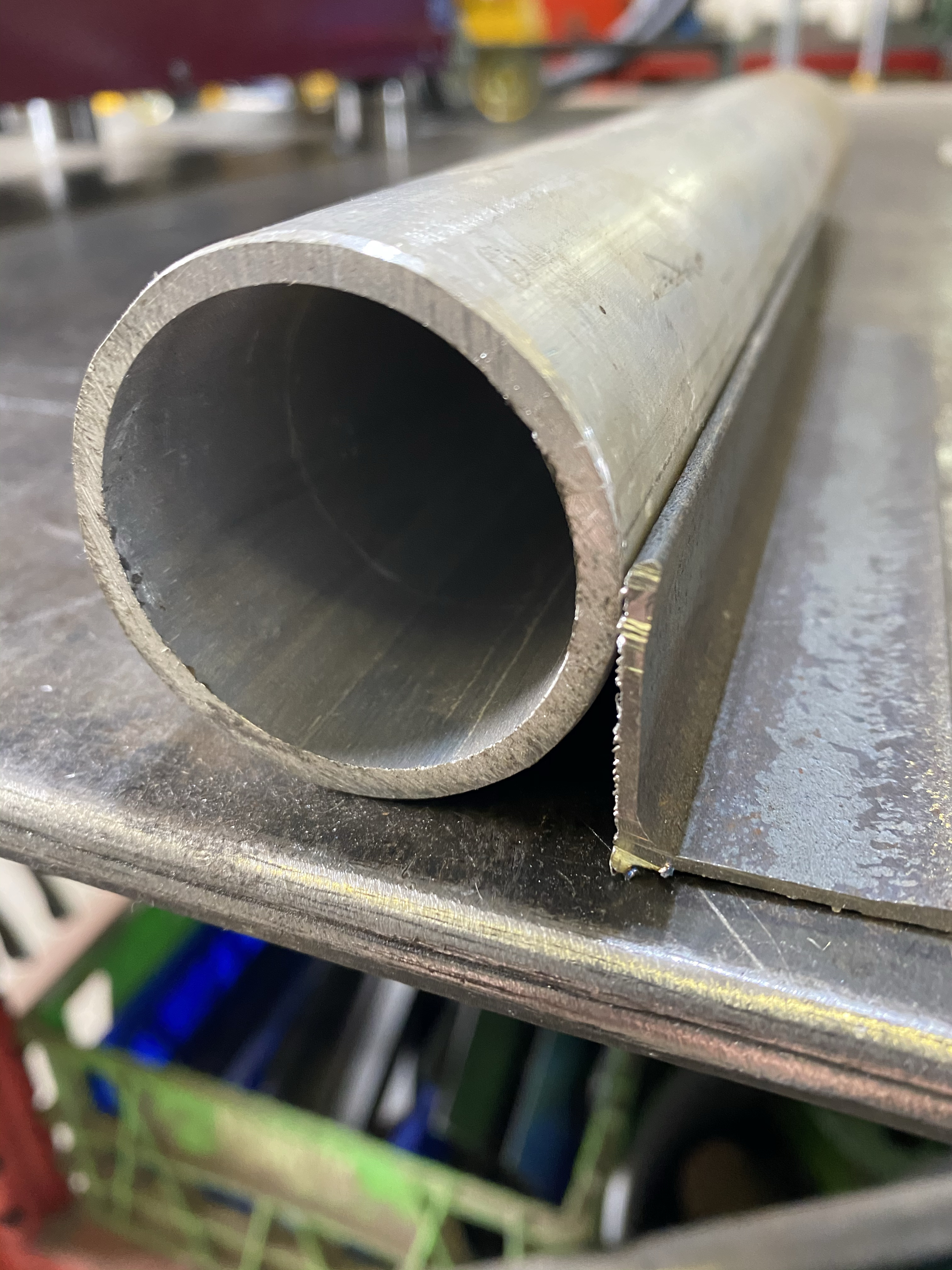

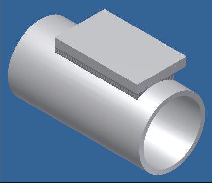

I need to weld about 3" length of 1" OD DOM tube to a flat piece of steel using MIG/GMAW. Both approx 1/8" thick. The contact area is very small and the V groove is quite narrow and 'deep' so I'm not sure what the right method would be. Basically like this diagram, but the plate is wider than the tube so it is harder to get to the point of contact. I've already ground a flat into the side of the tube but only a moderate one. Wondering if I should make a deeper/wider flat on the side of the tube to make that valley more accessible and less 'deep'?

Bend the flat plate to a closer match to the tube,,
then, it is simply a butt weld,,

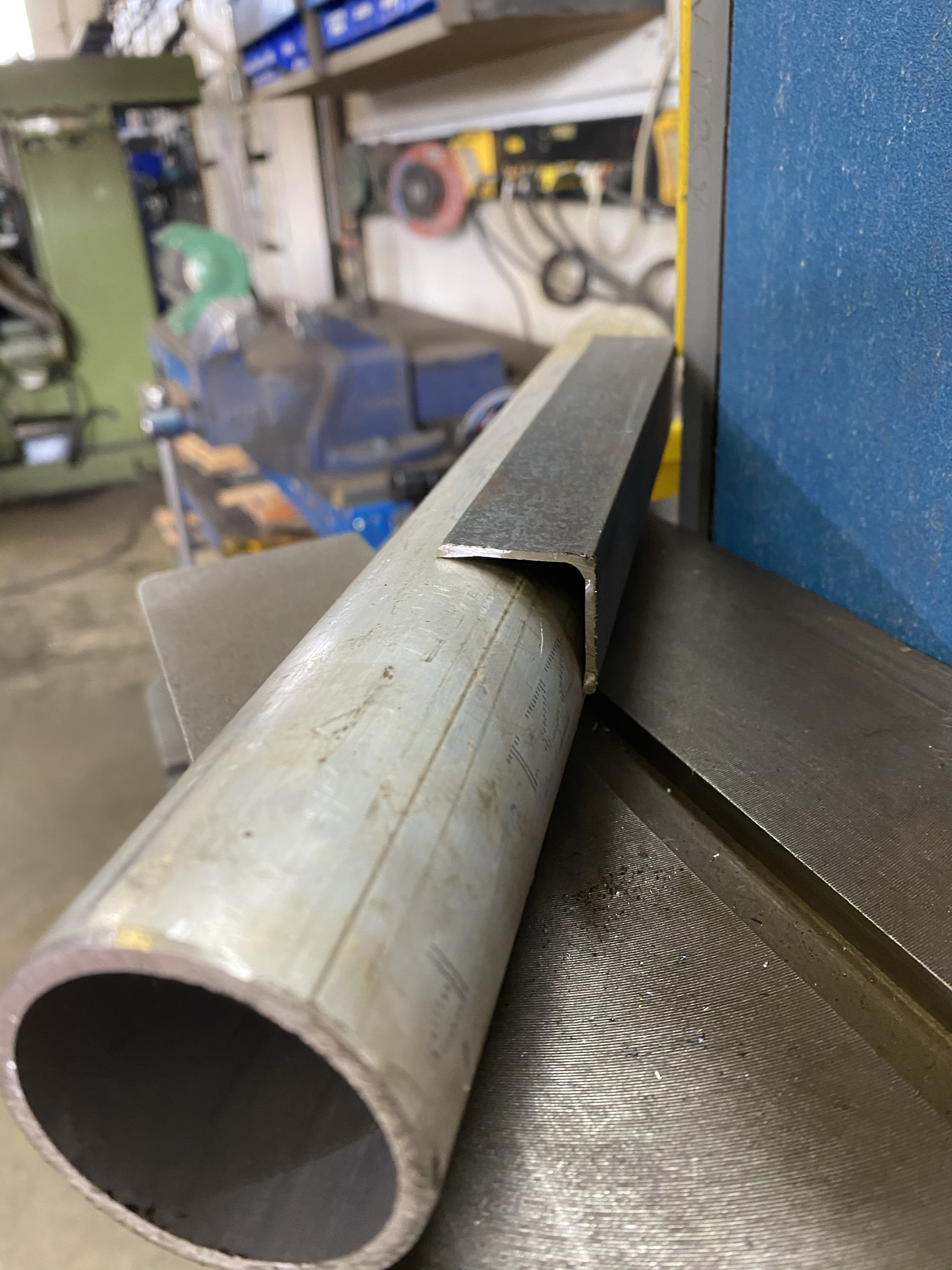

Here are a couple actual pictures.
   / Technique to weld DOM tube to flat plate
I can't alter the flat plate. It needs to stay flat.

Could you not add a piece of angle iron?
   / Technique to weld DOM tube to flat plate #6
Unless carrying a tremendous load, I don't see the problem? I'd tack it in place in 4 places. Then weld it.

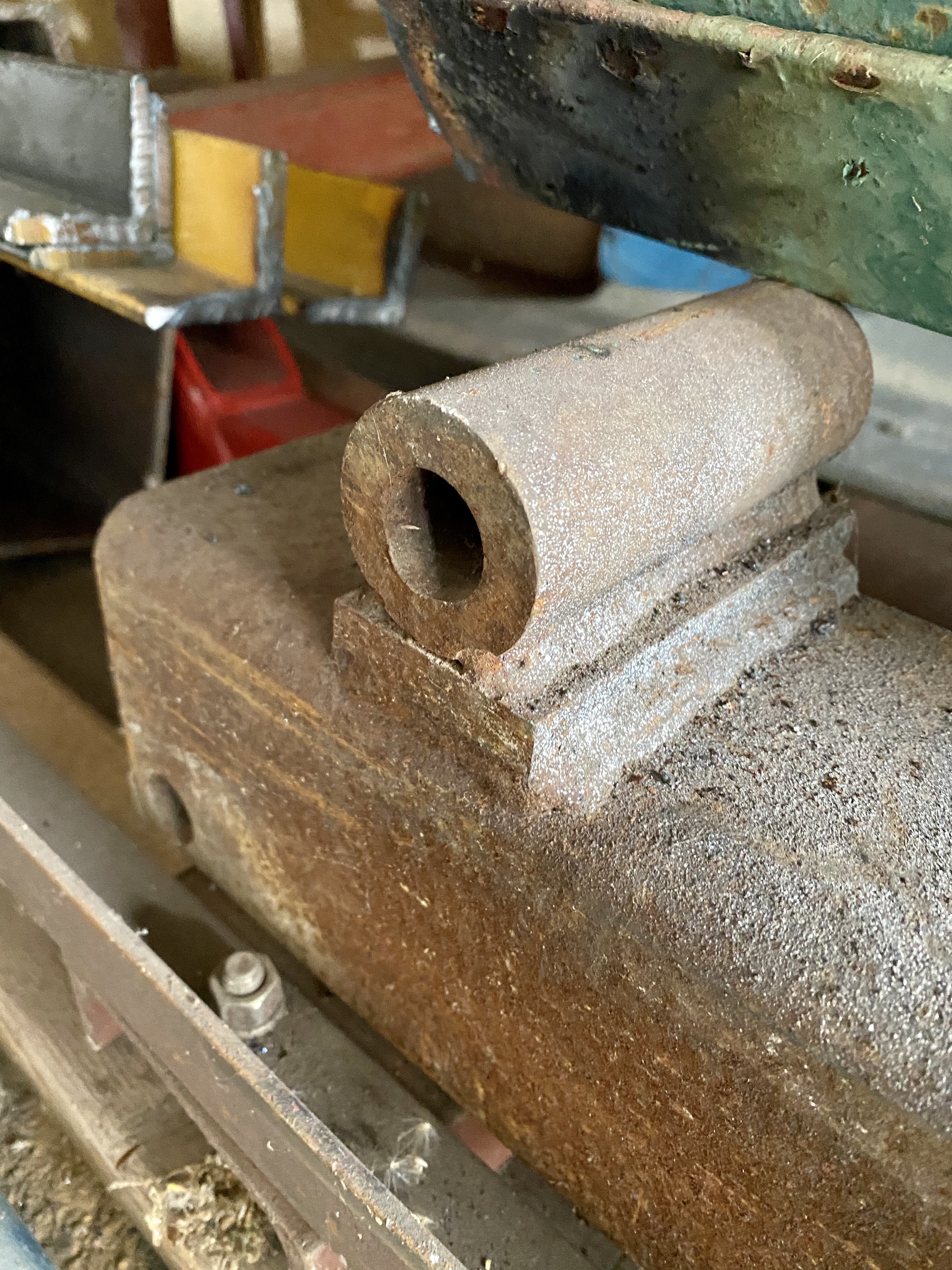

If not a tremendous load I would do what you said. No need to OVRWLD though. Maybe 3/4” -1” beads on each end both sides for a 3 inch length of tube.
Edit. I just reread and material is only 1/8 inch so I would assume light load?
   / Technique to weld DOM tube to flat plate #10
Yeah, I thought of that later too. Must not be too much load.
Just weld it on, being careful to keep it aligned in the proper position.
