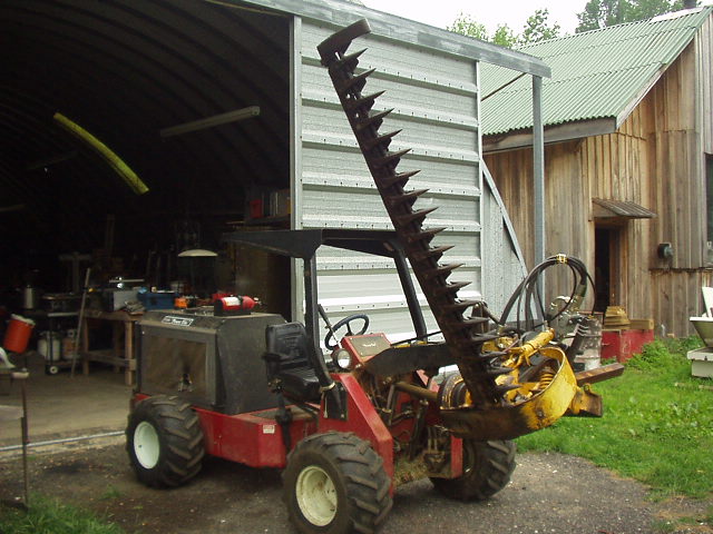

I had the knuckle boom mower on my 1845, I sold it. It was a lot of weight out front with the counterweight and the mower. The counterweight was probably 300 to 400 pounds and I believe it was necessary as when the boom mower was fully extended it seemed to make the opposite side pretty light feeling. The cut was too small (30 inches) and you had to make numerous passes and it did not cut tall weeds real good it seemed to knock some over instead of cutting them. There were a lot of hoses to hook up to control all the functions and they were very responsive to just moving the controls slightly it would shake the whole machine. (probably because I only used it several times). I decided it was just too big, to hard to hook up and too hard on the power trac to keep. I have a 6 foot sickle bar mower on my farm tractor that is much easier and faster to use along my trails and the 6 foot mower will reach almost as far as the 10 foot boom mower would. Power trac used to make a sickle bar mower for the power trac's but discontinued making it for some reason. I would try to find one to demonstrate before buying, I know I would never buy another one. The one I had was part of the unit I bought used and they would not separate.
