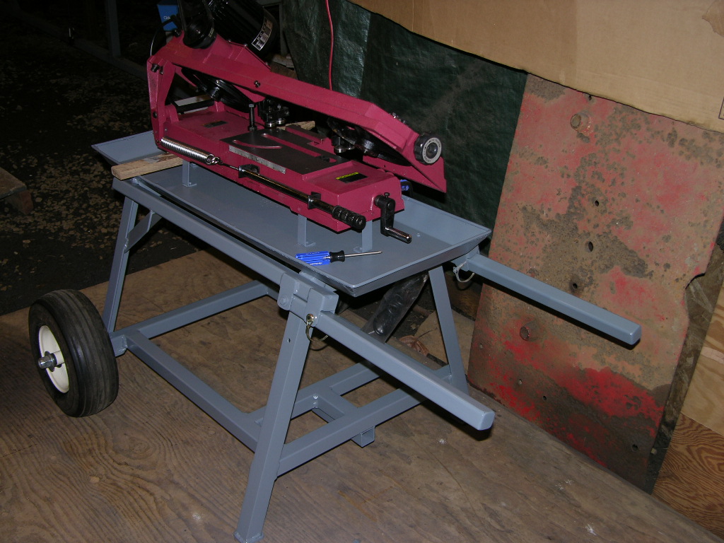

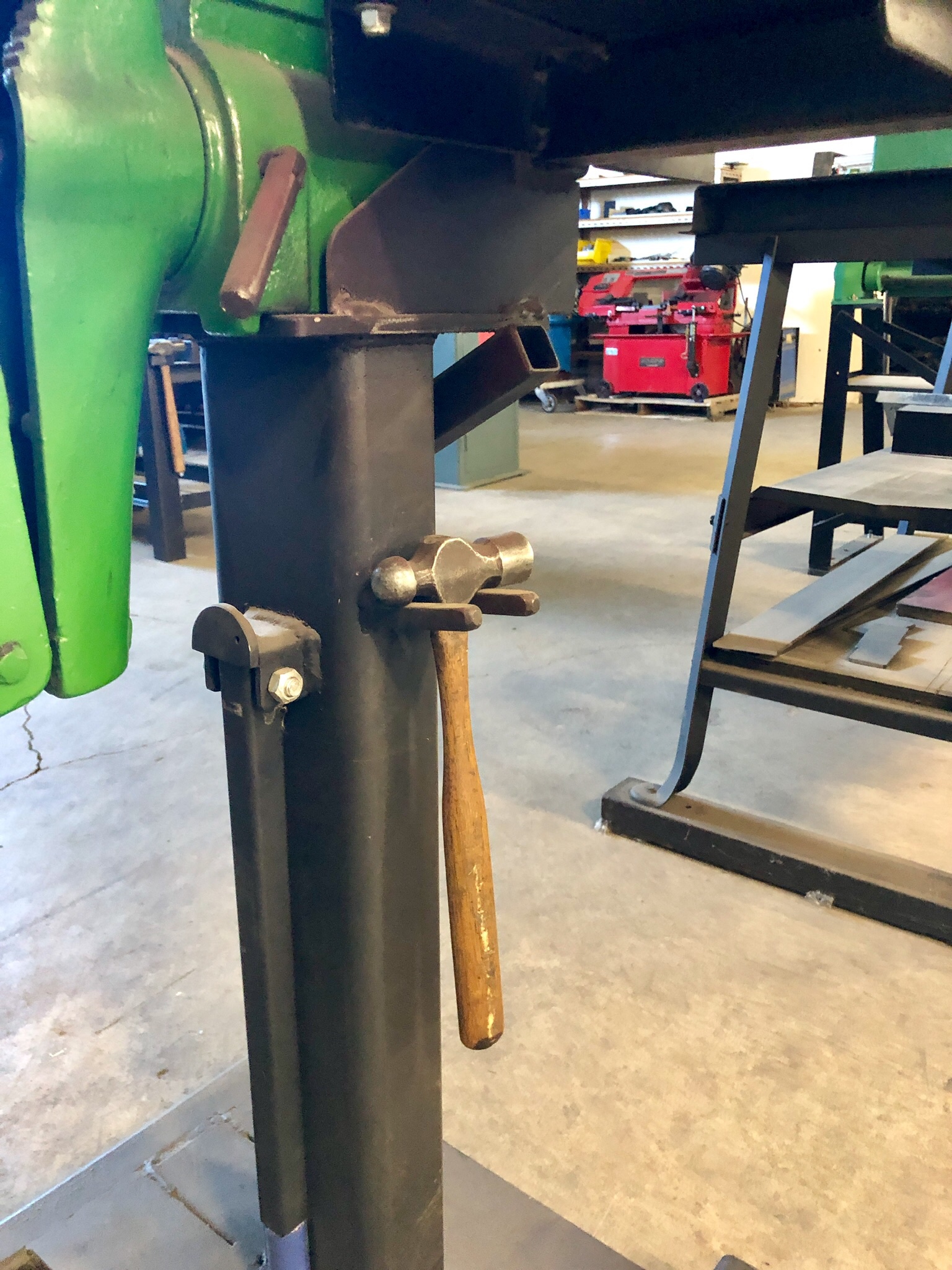

I have three frames in my driveway. One is my poor excuse for a welding table and has a vice mounted, one is simply a table, and the other is a heavy duty receiver hitch carryall that has been converted into a scrap iron basket. All have wheels on one end so I can lift the other end and move them around. I need to weld a couple of the larger tubes on the sides on one end of each frame so I can slide a pair of 3/4" tubes into them making handles. This will make them easier to lift and push without my legs bumping into the bottom of the frames.
The workaround is to weld angle iron into the appropriate size rectangles and slide the pipes into them, or use a hole saw to cut 3/4" holes into flat bar and weld it onto the sides of the frames. Either of these methods should allow me to more easily push the carts a round and to use one set of handles for all three carts.

The older I get, the more I tend to forget where I left the "other half" of "wheelbarrow handles" - these days, I tend to do more "captive" solutions, like my "offroad bandsaw" project (and yes, those ARE flat free tires :laughing: )
Those handles also pin in the DOWN position; there's also a "trailer tongue" that pins into the bottom receiver, so I can tow it with either my golf cart or ZTR. Couldn't think of a way to stow the tongue so I wouldn't keep tripping over it, so it stays separate... Steve

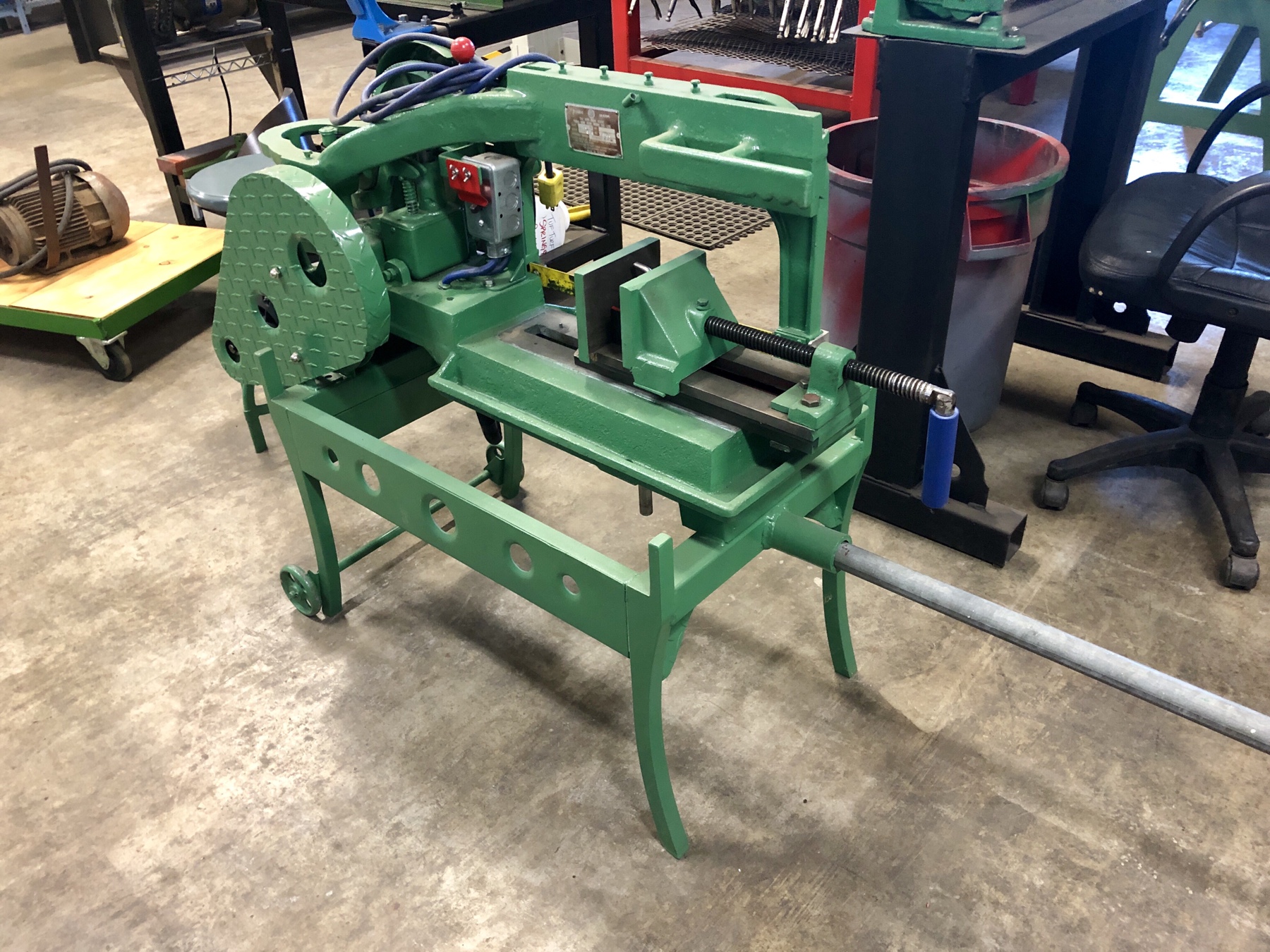

I wasn’t smart enuf as Steve to keep the handles captive when not needed, but in my defense I had a piece of pipe handy to use for another project in an “emergency”. Okay, maybe more than once. ( I’ve since given up painting the handles). Lol

Geez Terry, with THAT particular saw, all ya need to move it is an anchor point, a couple pieces of chain (with GRAB hooks), and some REALLY FAST HANDS :confused: and you could let the saw MOVE ITSELF...
Directions -
Fasten one chain to a tie-off point (fairly sturdy)
Fasten the second chain to the bow on the saw (keeping the "grab" end in your hand
Turn the saw on, and (quickly) move the grab hook up to the next chain link each stroke of the saw
I’m having difficulty understanding, Steve. Perhaps you could purchase or borrow a power hack saw and have Mrs Bukit video whilst you demonstrate?

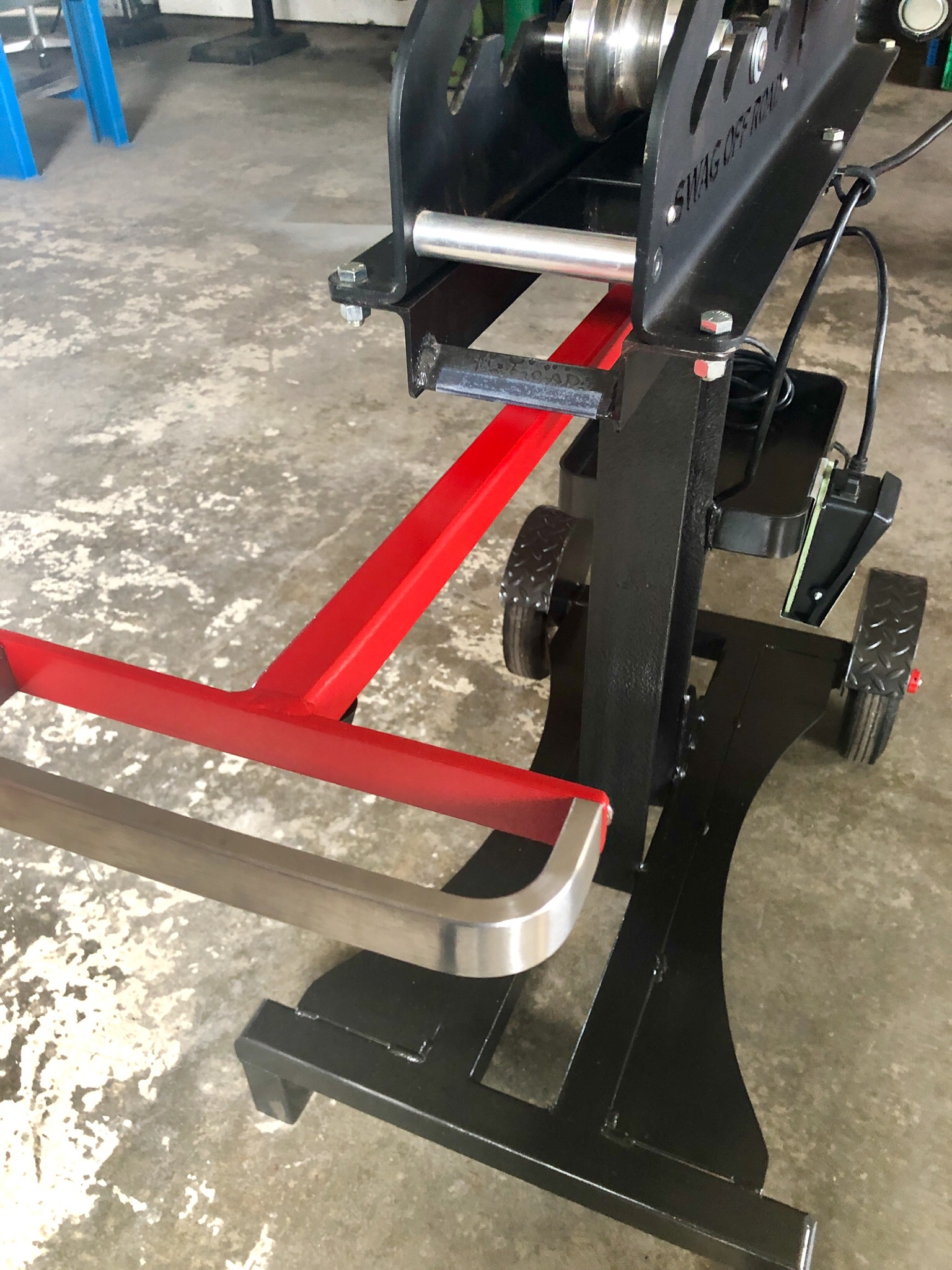

A non-welding solution to "wheelbarrow handles" is to bolt black iron floor flanges to appropriate vertical surfaces and thread black iron pipe into the flanges. You would have to size the pipe/flanges so they could support the load. Big box stores carry flanges from 1/2" to 1-1/2"; plumbing supply houses have larger. If the pipe is too large to grasp, reducing couplings and 6" nipples could provide handholds .

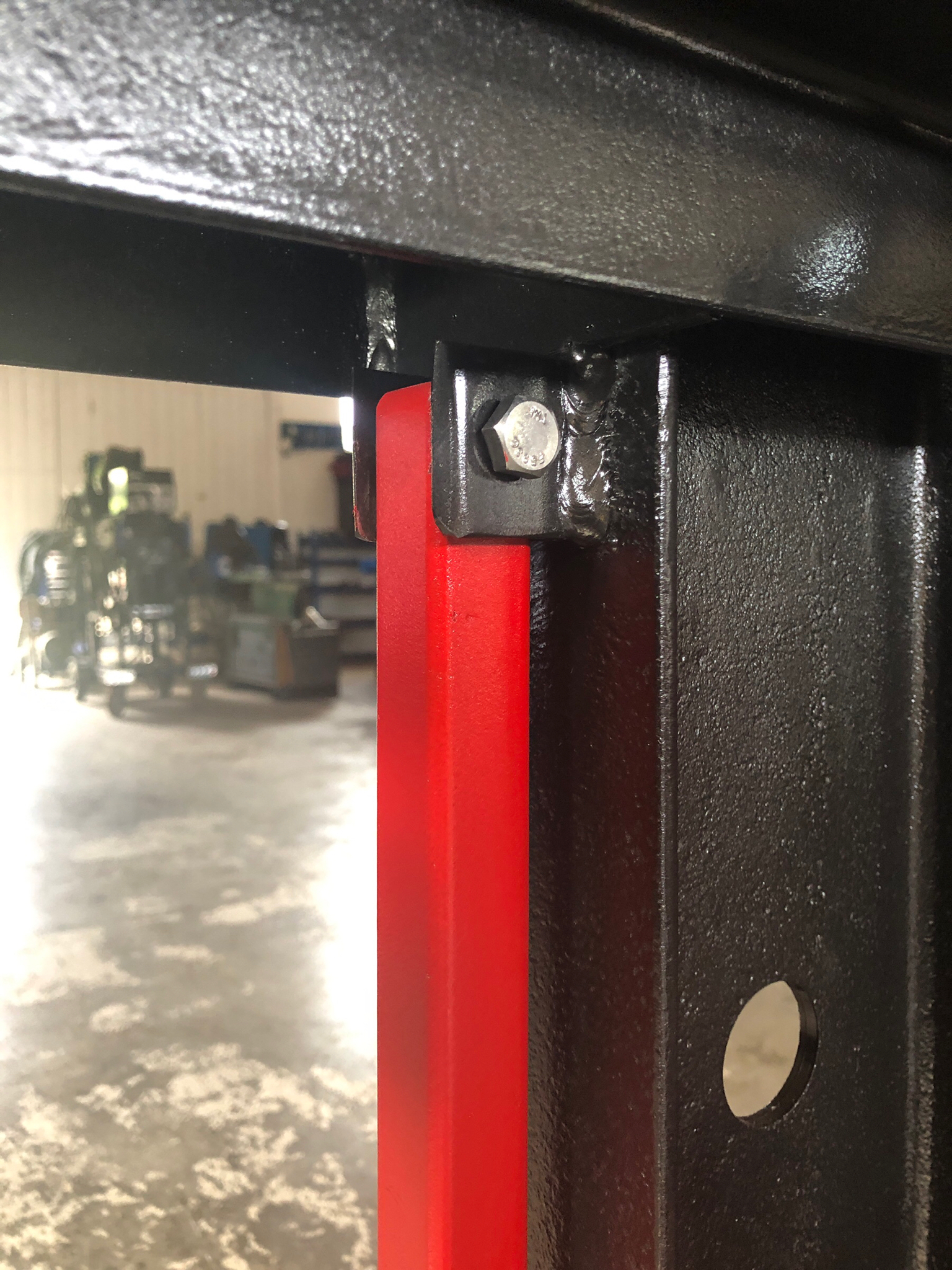

Thats a solution I didn't think about. I've already welded 1 1/2" angle into tubing and attacked it to two of the frames. Even with my sorry welds, they work as well as I'd hoped. I'll consider your idea for the last frame if I run out of angle. Thank you.

Stuck another way you might consider is a single hinged handle. Not certain if that would work in your case or not though.

Then maybe two hinge handles may work like the pic Buckit posted.
