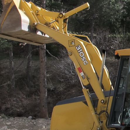

Our JD310 only has a safety latch on one FEL lift cylinder. It is quarter inch steel and very stout.
The safety gets a lot of use since on that model the hood can only be opened when the bucket is raised - which is one of the the disadvantages of having a single bucket tilt cylinder right in the middle.

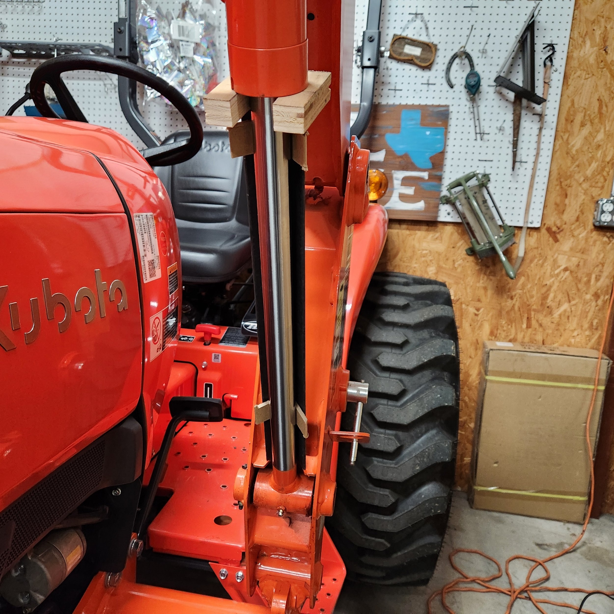

Thinking I saw some dudes utube vid from Australia with a 3901 (same FEL)? He claimed it came with locks/stops, has storage under the station or something.
Never did find the parts, rigged some DIY fashion.
