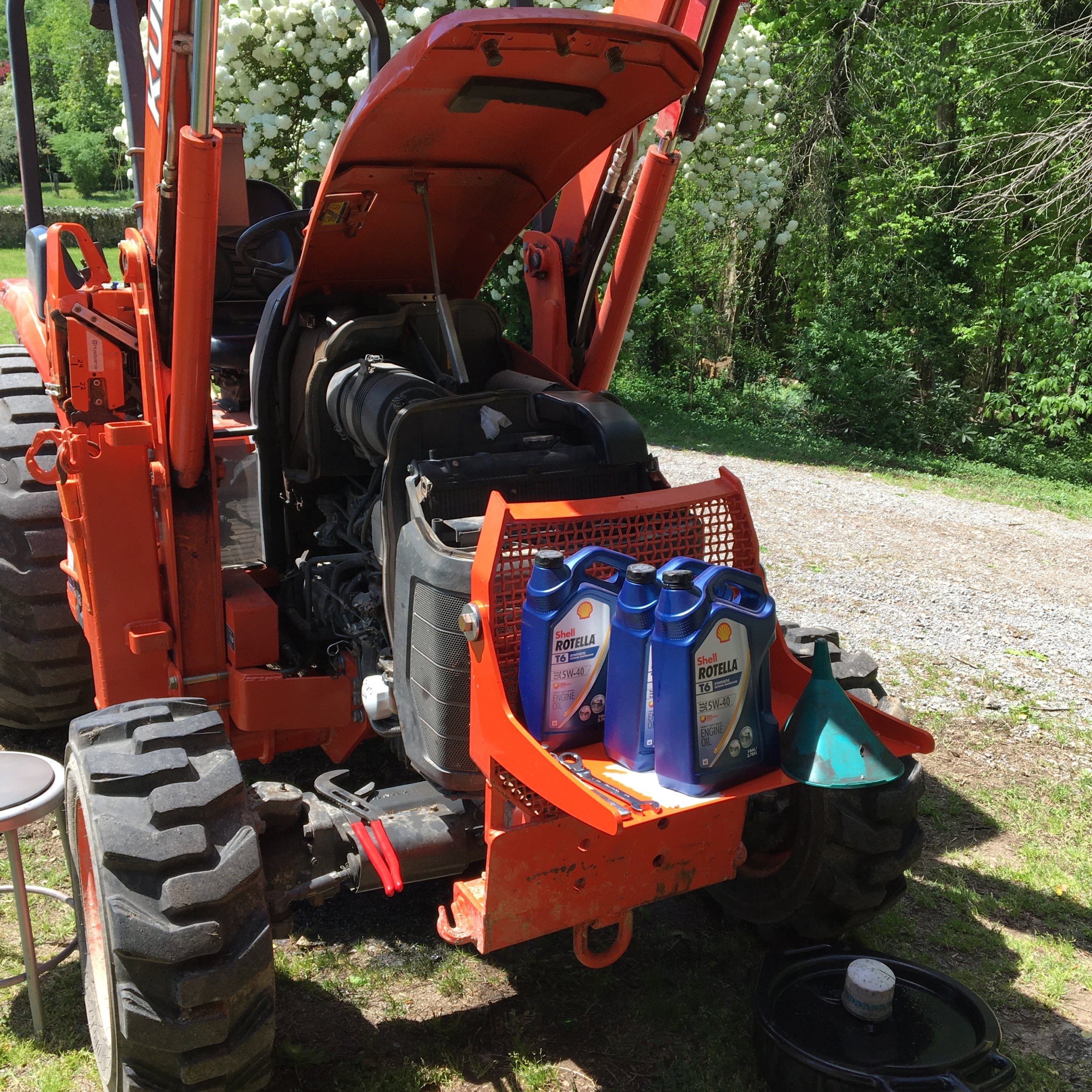

Do you apply any pressure/weight at the contact point(s) from the FEL once in place?
   / Tell me about cylinder safety locks #16
Do you apply any pressure from the FEL once in place?
No. Raise the loader (FEL), secure the brace, shut off tractor and lower the loader down on the brace(s). Relieve any line pressure on lift circuit.
Word of caution. At this point of bracing the lift arms, you need to decide whether you want the bucket tilted back and it will stay OR put the bucket in full dump, shut off engine and cycle the bucket circuit to relieve pressure.
IF THE BUCKET EDGE HANGS DOWN LOWER THAN 6'6" +/-, HANG FLAGS OFF OF THE EDGE OR PUT FOAM CUSTIONING ON EDGE!

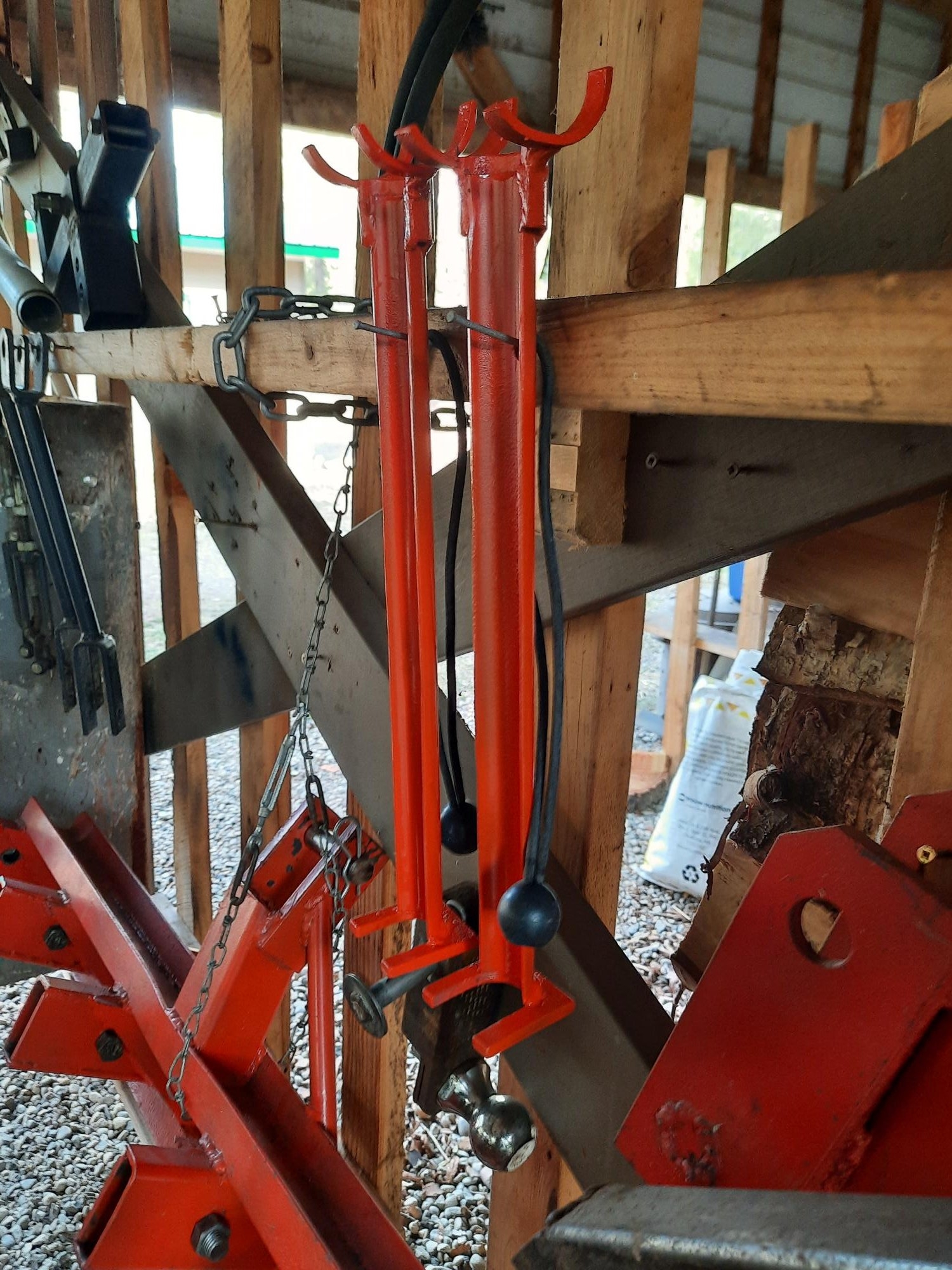

If you are going to use the cylinder safety locks, definitely use 2. With only one, when you decide to lower the loader while having a brainfart, your loader could look decidedly different than when you started. Ask me how I know.
These are the ones I use on a BX23.
   / Tell me about cylinder safety locks #19
Thanks for the pics, I'll be copying your design Very soon. Are those supports mad of 1/2 sections of pipe? They don't look like angle iron.
   / Tell me about cylinder safety locks #20
Yep, that's exactly what they are and the curved ends are the outside shells of euchered bearings.
