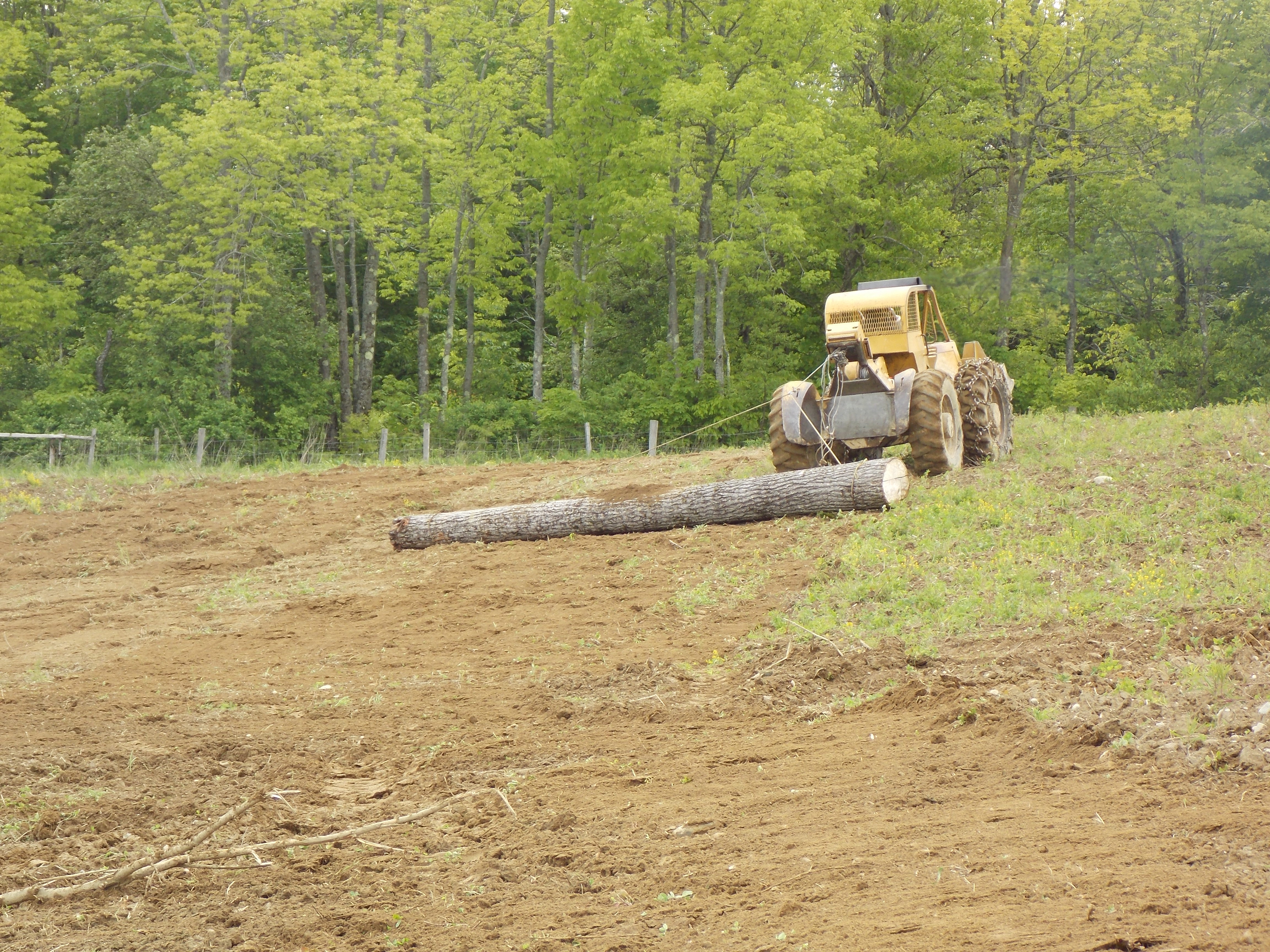

I use a roll-over plow, then I drag a log sideways over the field.
The deep tillage really fluffs up the soil and allows the soil to be moved about. And the log, with its shape, presses rocks into the soil.
The bigger and longer the log is, the better grade you will get. A smaller, longer log though is better than a short one, because the longer the log, the smoother your field will be. You will just have to make more passes over the field the lighter the log is.
For years we would use a disc harrow and it was silly; all it did was kick rocks up so we had to pick more rocks, and marginally graded the field smooth.
In this picture I am using a bigger tractor to pull the log, but the concept is the same no matter what you tow the log with.

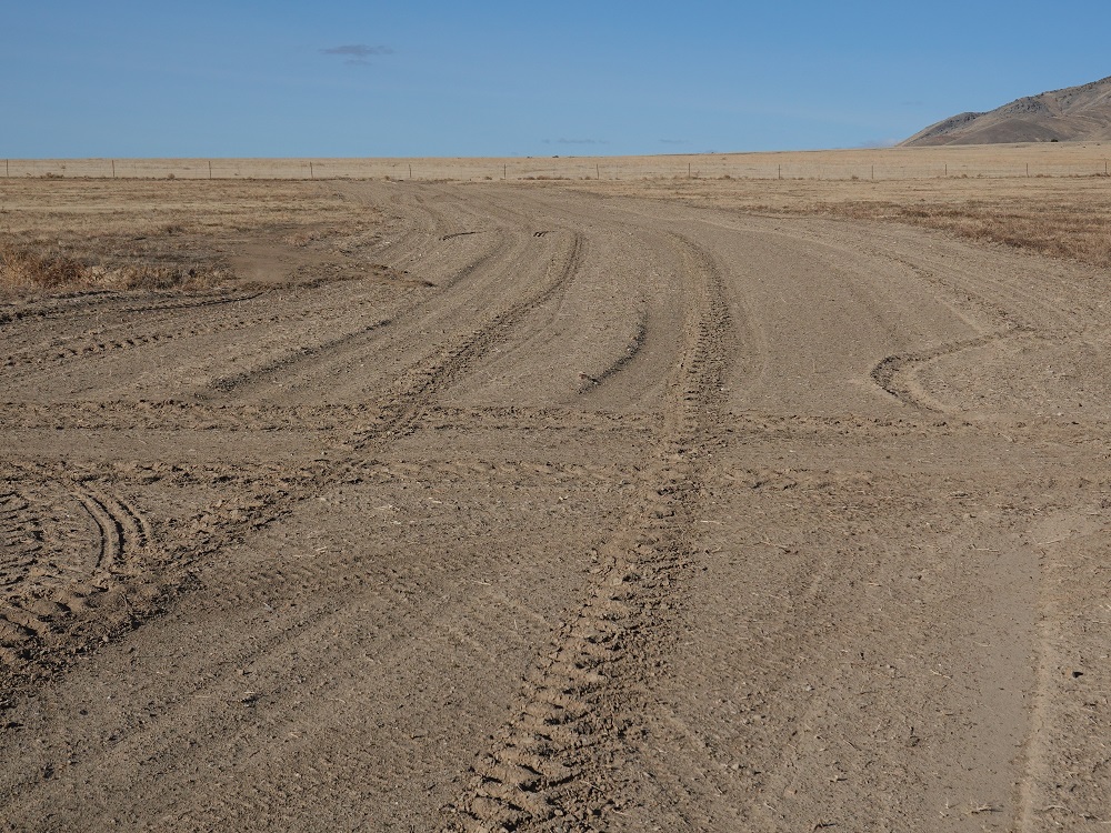

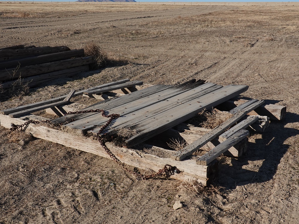

1. Mow first. Otherwise the vegetation will bunch up and tangle up in whatever implement you use to level with.
2. Make at least one pass - more if that's what it takes - with a disc to loosen up the top layer of soil.
3. Pull a large drag of some sort over the ground. It will shave off the high spots and drop the loose material in the low spots.
With several passes you can make the ground smooth and level.
Years ago I made a drag out of 4 railroad ties fastened together and spaced out by large thick planks I had laying around. It measures about 9' x 9'. I use it several times a year to maintain my fire breaks. Here's what the drag looks like. Kind of dilapidated now...I'm going to get some new railroad ties and build a new one this spring:
This is what the firebreak looks like after discing and dragging. The land to the sides may look smooth but it is anything but!
