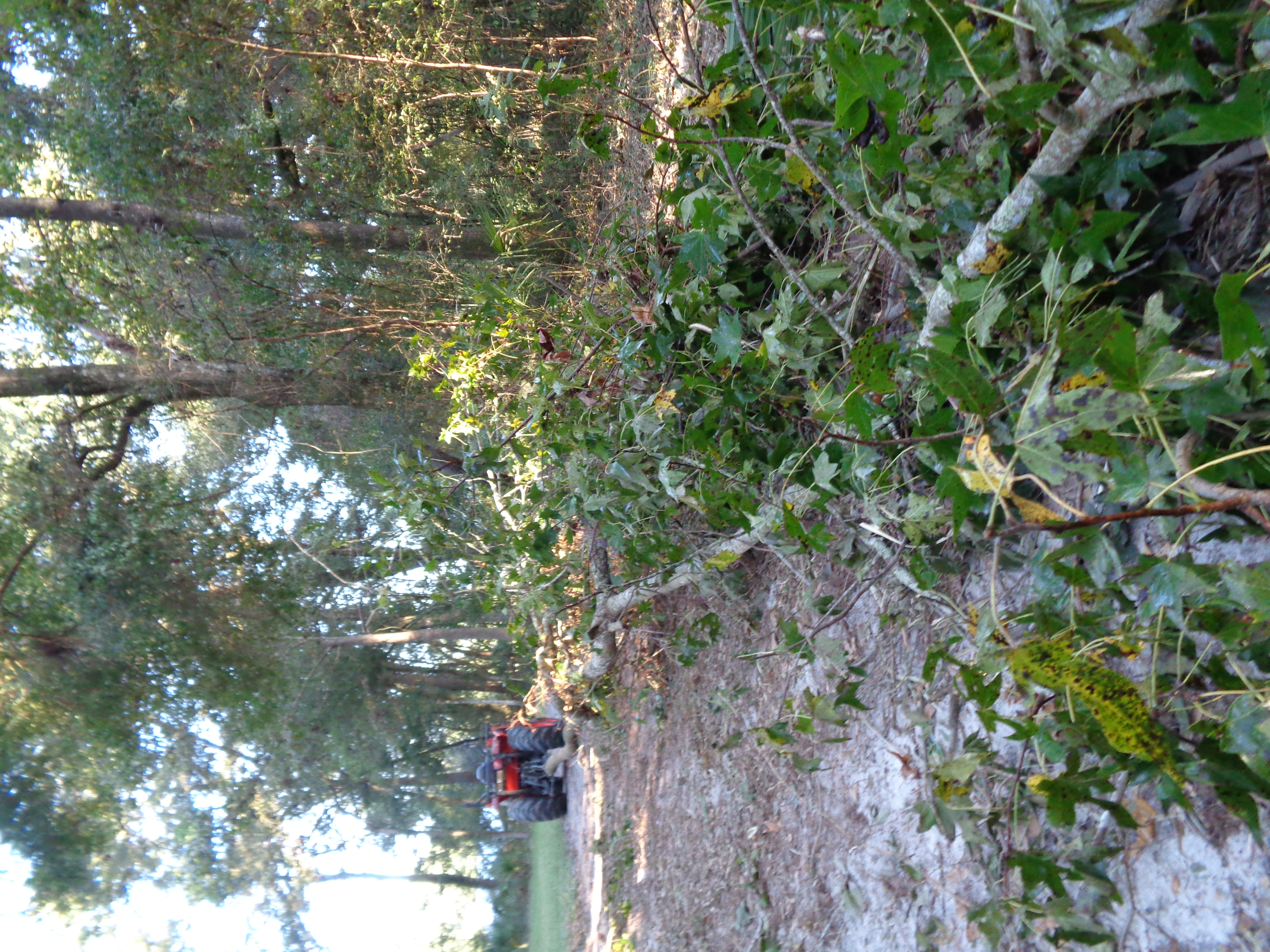

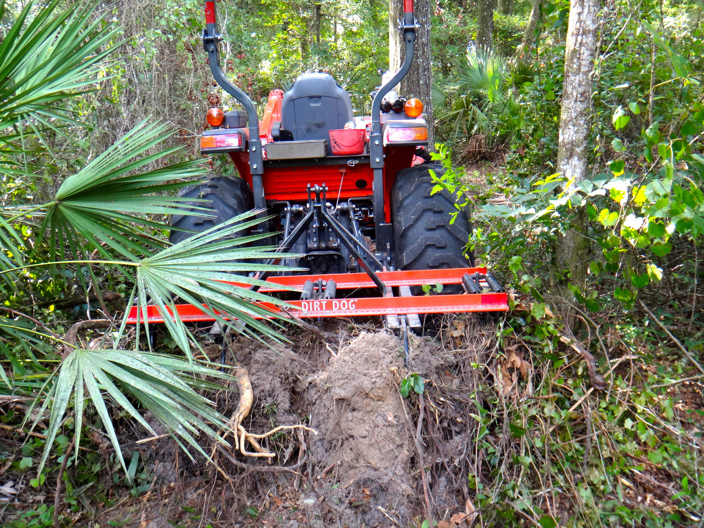

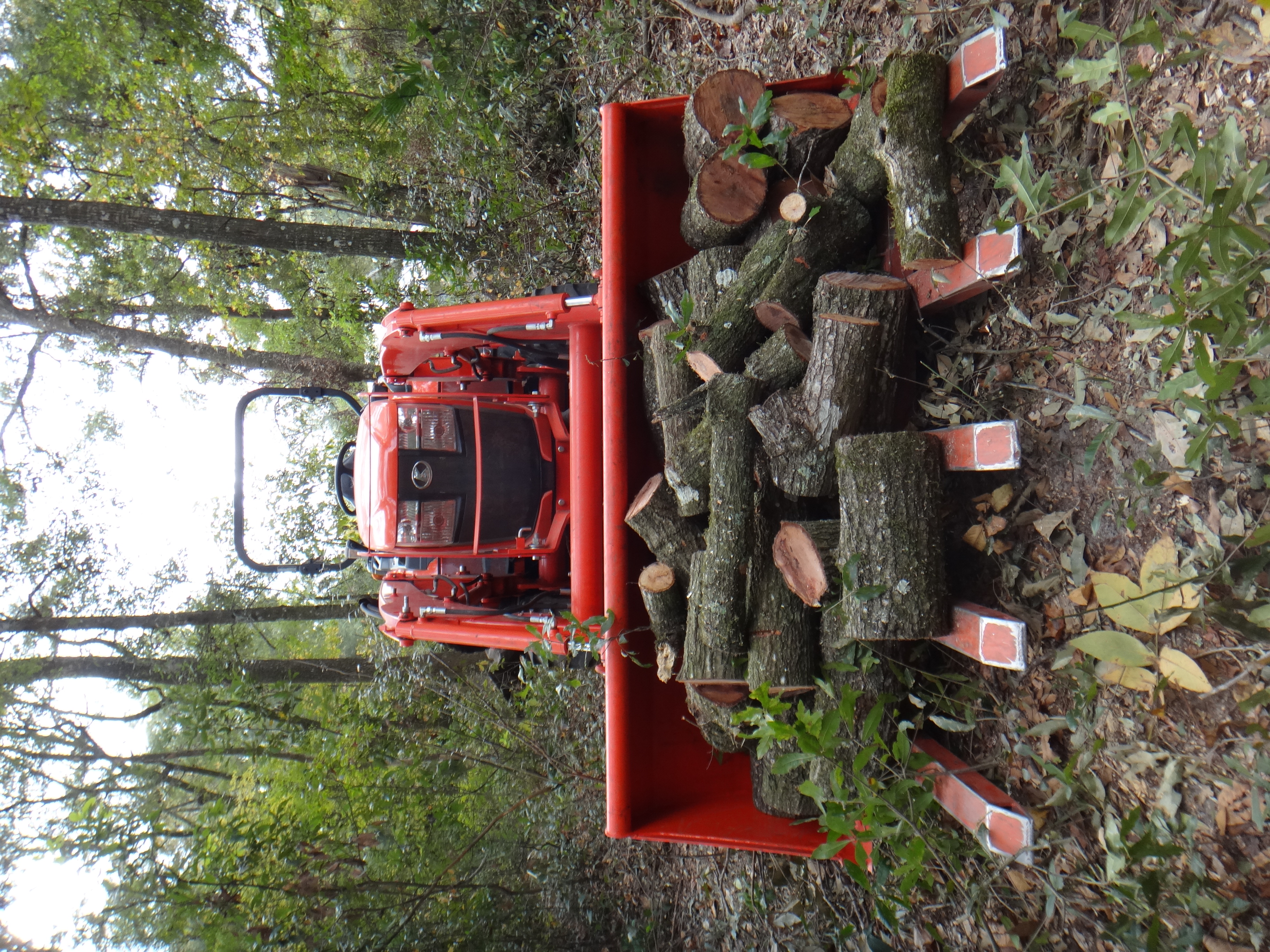

L4060. The L3901 has the same chassis as the 3301, and I consider the L3301 underweight for it's hp. If you really need to stay narrow, L3560.
L3301/L3901 = 2,770 pounds bare tractor.
'Grand L' L3560 = 3,495 pounds bare tractor.
My L3560 is 62" wide with factory R4/industrial tires.
Kubota Web Site: https://www.kubotausa.com/docs/default-source/brochure-sheets/l60.pdf?sfvrsn=bad1e991_6
'Grand L' L4060/L4760 = 3,570 pounds bare tractor.
The fundamental importance of TRACTOR WEIGHT eludes many tractor shoppers.
The built in adjustable widths for all rear wheels/tires on the Grand Ls may be a very important feature for you. Spreading rear wheels for a wider tractor stance is the first step in improving tractor stability on slopes.
L3301/L3901 increase rear wheel width with R4/industrial tires only with aftermarket wheel spacers.
My land being steep and wooded I have limited places to operate and often in tight quarters. I took advice from this board to go around my land with a piece of 1-1/4" PVC pipe cut to the width of the potential tractor plus a bit to see if it'd fit (keeping in mind that the front tires take wider path on turns).
What is the altitude on your property? If your property is over 4,000 feet you may wish to consider a turbocharged engine. If your property is 5,000 feet or higher you should seriously contemplate a model with a turbocharged engine.
When considering a tractor purchase, bare tractor weight first, tractor horsepower second and (narrowly) rear ballast third.
In your situation, probably as many tractor owners upgrade for additional Loader lift capacity as upgrade for additional tractor weight. Consider optional Kubota L2296 heavy duty loader bucket for your tough conditions. Indestructible.
Your property sounds divine. My congratulations.
Your opening post is extremely well thought out. How nice.
Well worth shopping Kioti and Branson in addition to Kubota.
Shop your weight range within tractor brands. Collect a dealer brochure for each tractor model in your weight range. I spreadsheet tractor and implement specs, often a revealing exercise. I have a column for cost per pound.

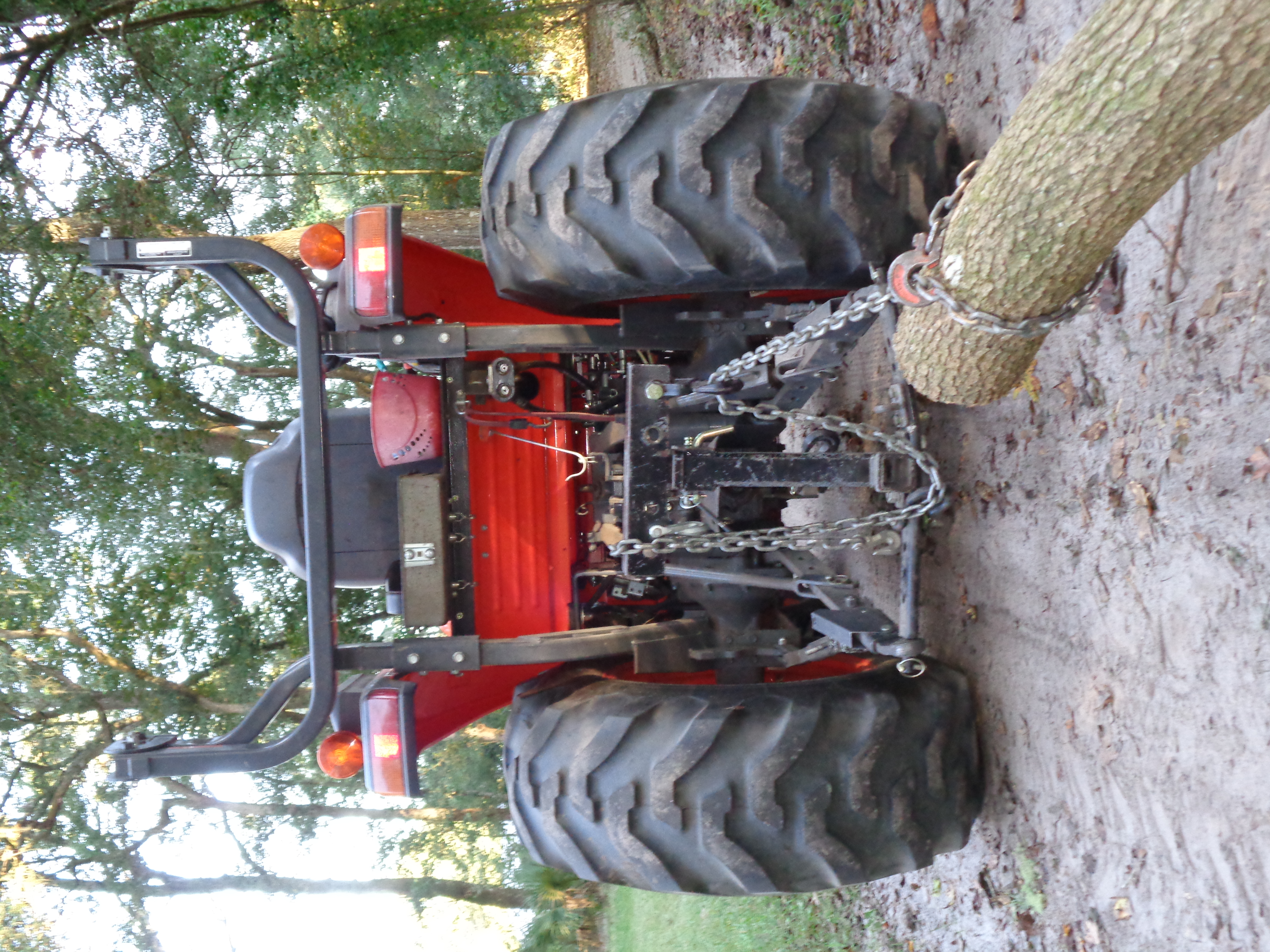

Get the heavier tractor. If you can afford it, remote hydraulics, suspension seat and filled tires go a very long way. If I could do it over again, I would have spent another $5000 and purchased the Massey 1742. Much heavier, and completely loaded versus my Economy series 1734. Whatever you pick, the heavier the better. My 1734 never runs out of power; it runs out of traction from lack of weight. Even with the loader, and loaded tires, it weighs about 3800 lbs.
