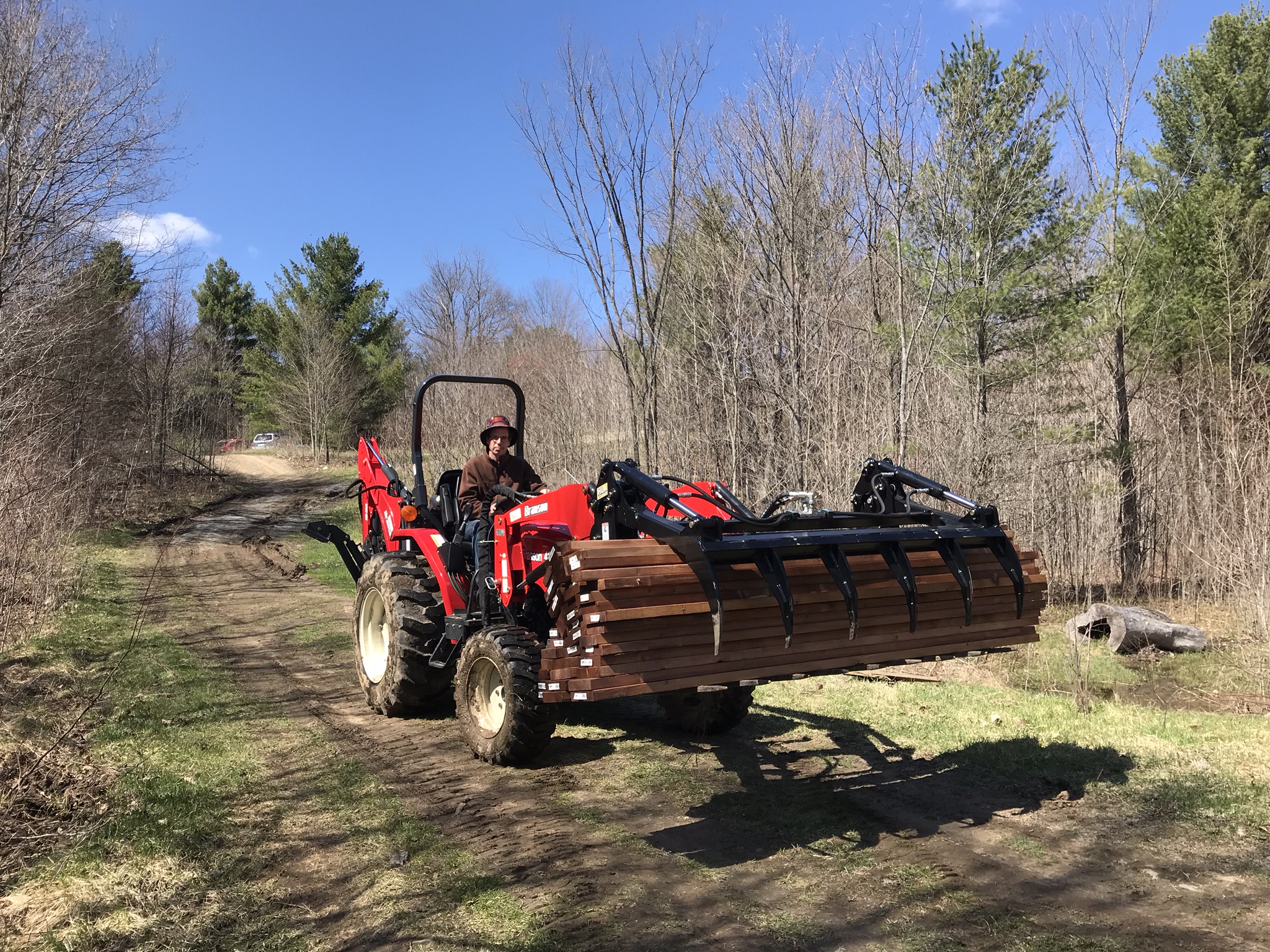

Well, we have pulled the trigger on a Branson 4225h with loader, backhoe, and grapple. To be delivered in April. Thanks for all the advice in this thread.
(By the way, I appreciated all the feedback above also on what to do myself vs outsource, tractor vs ATV vs miniex etc. I didn't reply to all of it directly, and some of it just reflected differences how people interpreted my description of our needs. But it all helped in our thinking, including just helping us become clearer on what we do and don't want to do right off the bat!)
Well, just to close the loop, I hereby announce the arrival of Josephine (named by a family member), who was delivered last Friday and is already making herself useful. At 5 hours on the meter, she's run several loads of PT lumber down a wet trail, moved some brush and a pile of rocks, and dug out a stump with the backhoe (pretty slowly and with many unnecessary movements, as I was learning backhoe controls...).
And made a soggy wet forest road temporarily worse (cause we really should have waited another week for it to dry out but were impatient), thereby creating more work for herself for the next few days.

This board is great. I posted that picture this morning after breakfast, then went out a did some backhoe work. I'm sorta getting the hang of it, except -- me too -- that touchy boom cylinder! I just came back thinking that's one of the things I'll have to ask my dealer about, and whaddya know, you guys are talking about it in *my* thread :)
It's sort of like going to the pub with a thought on your mind, plopping yourself on the bar stool and discovering your mates are talking about that very thing!
