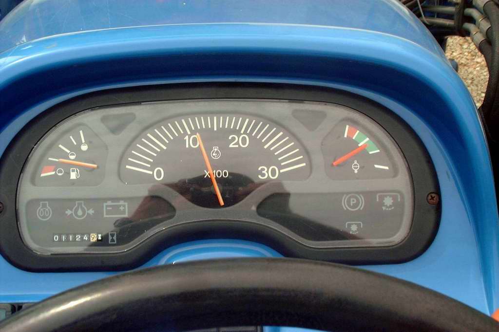

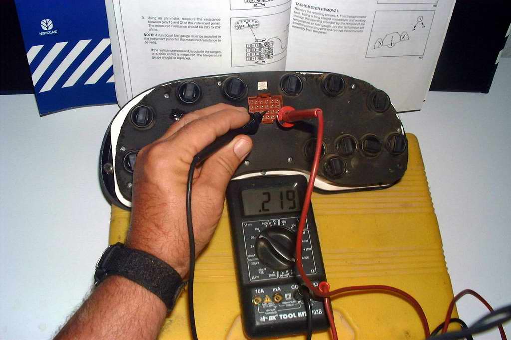

I fixed (replaced) my failing temperature gage last Saturday. It was a bit of a task to get the replacement gage. The first one arrived at my dealership in a box that looked like it had come from the landfill. To no surprise, the new gage inside was also crumpled. All my dealer could do was order me another one. Luckily, that showed up in about four days. $44 later, I had my new gage.
Before replacing the meter, I decided to follow the troubleshooting procedure in the Repair Manual to find out which test would show a faulty gage. I had determined the gage was bad by grounding the lead going to the temperature probe and seeing the gage only read half-scale. If you do this, the gage should go full-scale to the hot region.

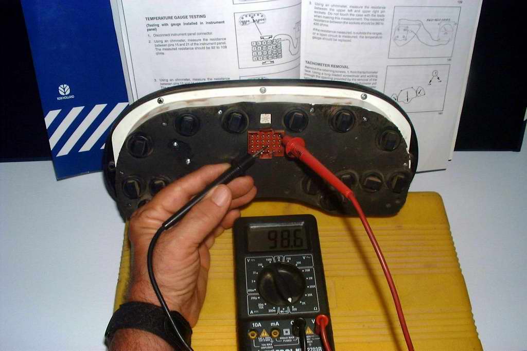

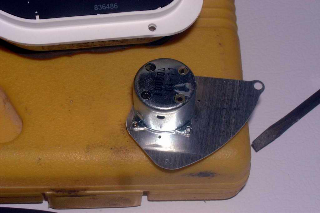

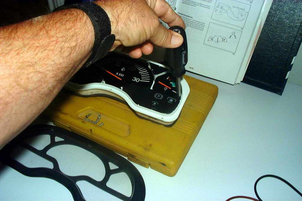

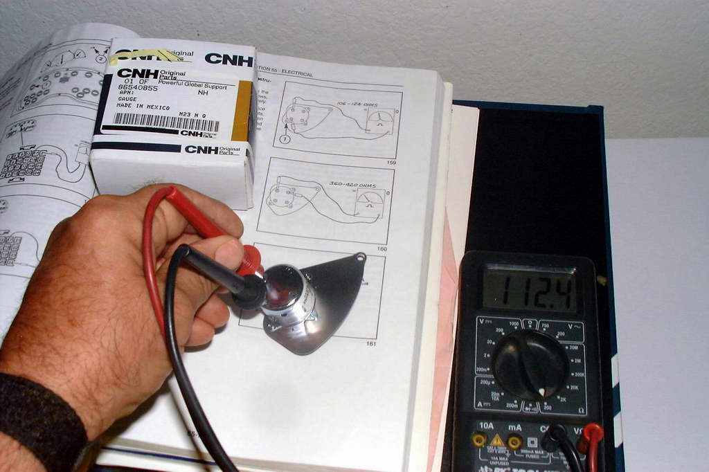

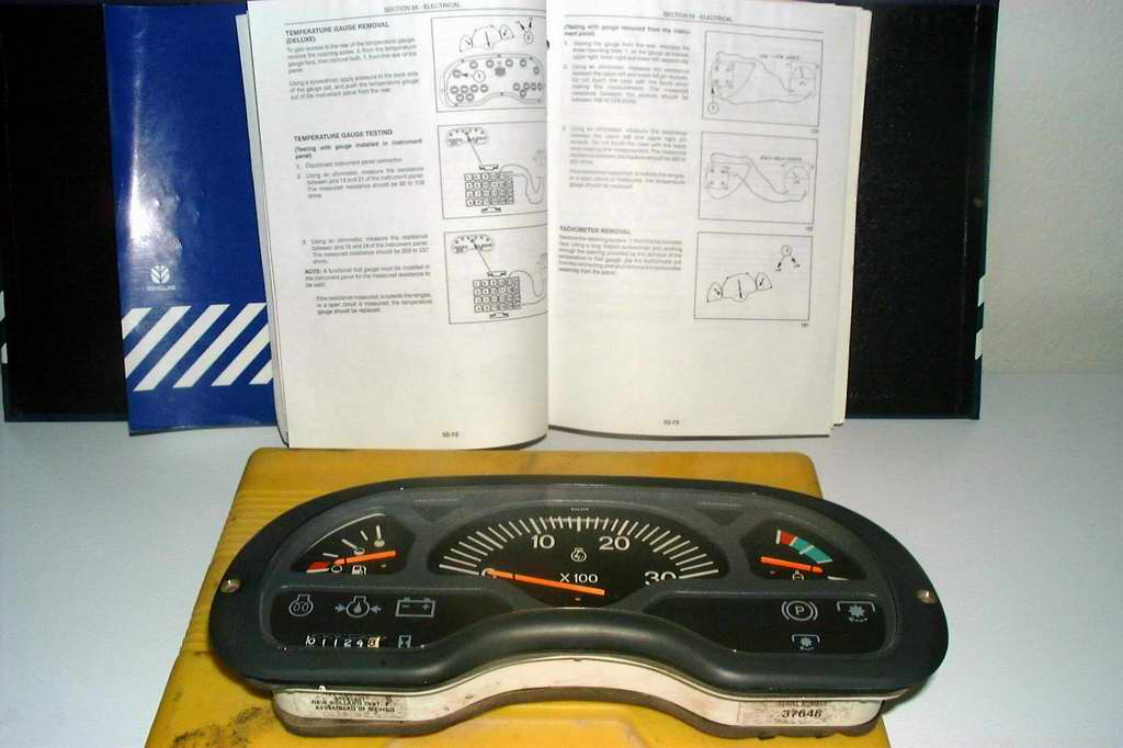

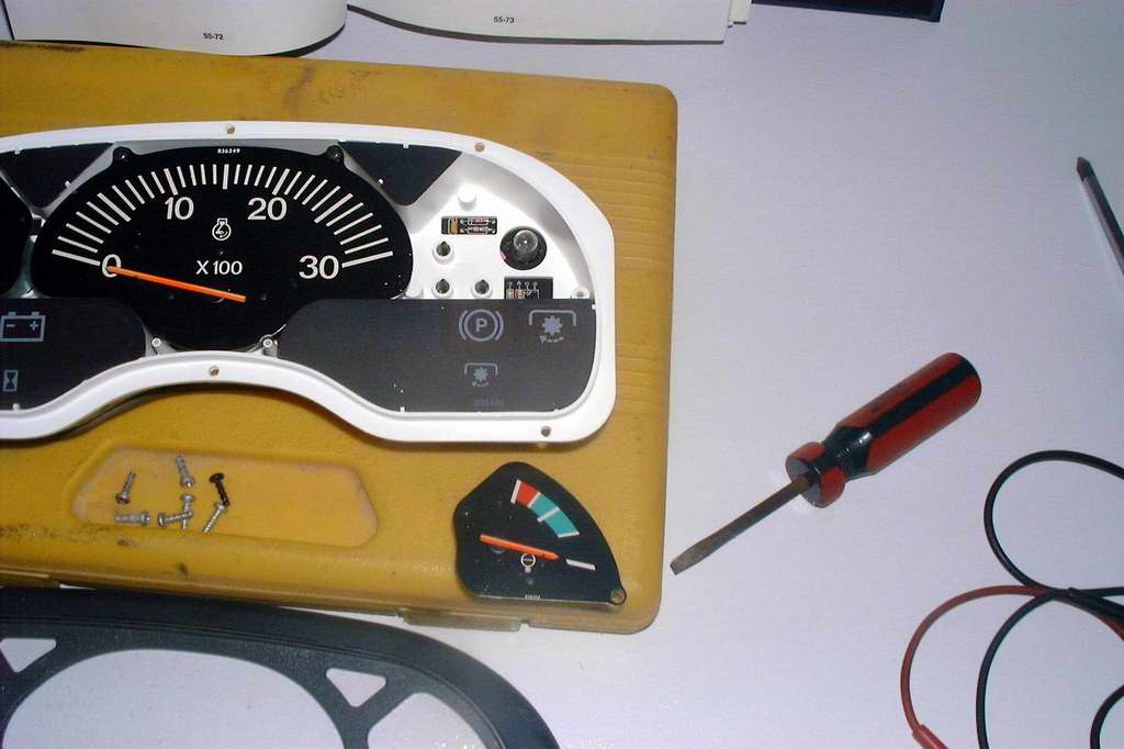

I removed the instrument panel (photo 01) and then turned it over for the first resistance test. Test one (photo 02) was to check between pins 15 and 21 for 92-106 ohms. Mine tested at 98.6 ohms. The second check (photo 03) was between pins 15 and 24 for 203-237 ohms. Mine tested at 219 ohms. Everything looks good here. It's time to disassemble for more tests (photos 04,05, 06). You have to be careful when removing the gage if you don't want to bend the face. Severel tweeks with a screwdriver around the perimeter and the gage popped out of its socket.

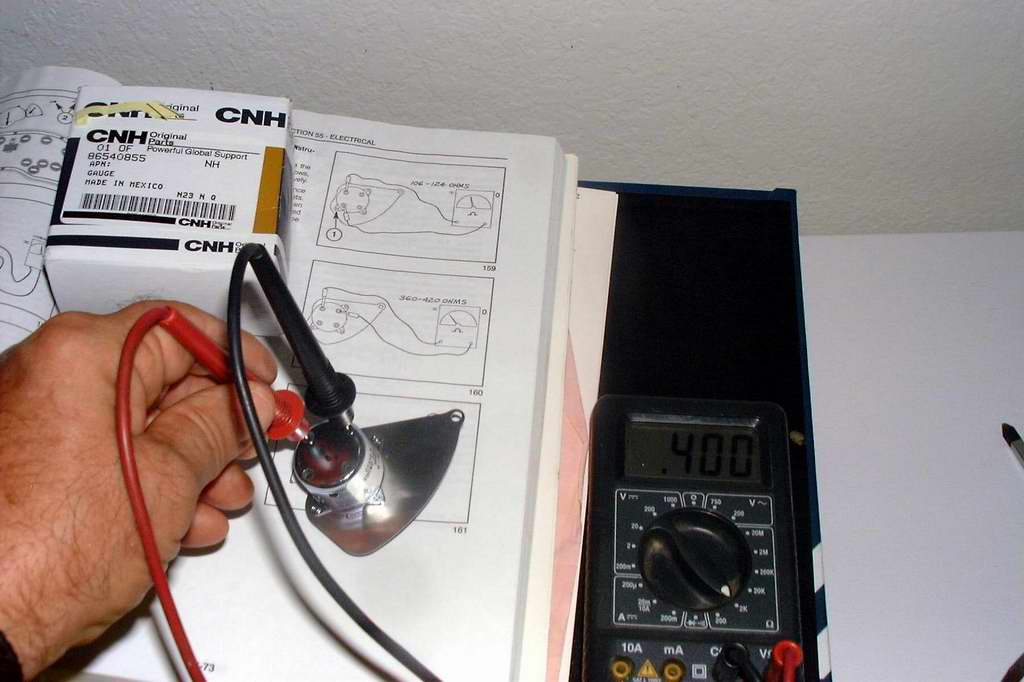

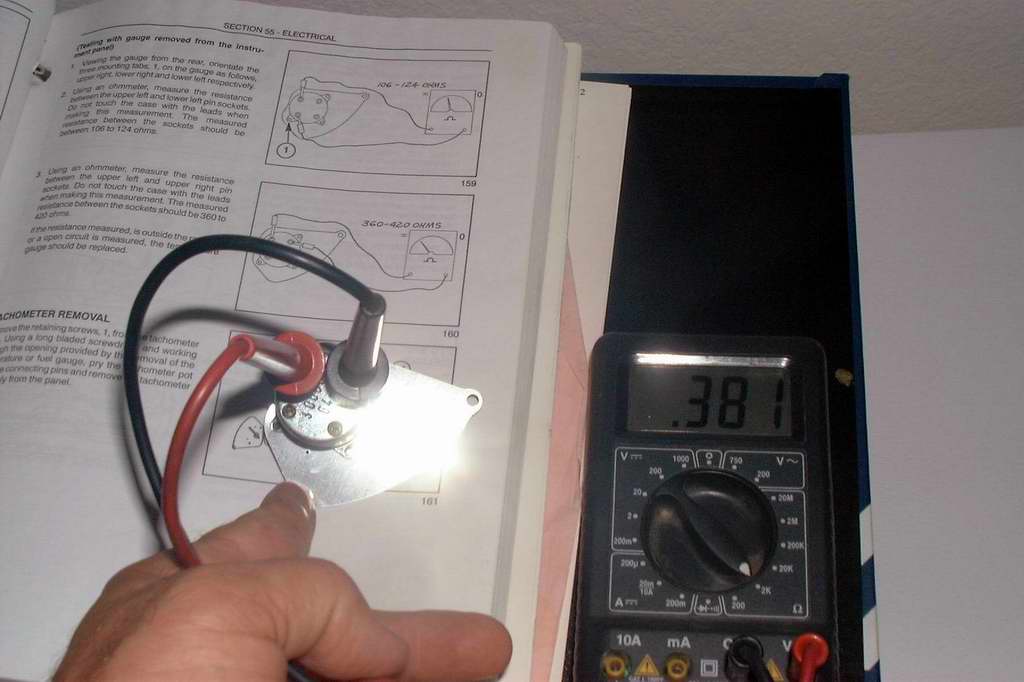

Turning the gage over, I continued the tests (photo 07). Test three (photo 08) yielded 381 ohms, satisfactory. Finally, test four (photo 09) also yielded good results at 111.5 ohms. Everything about the old gage tests good, but it did not function properly. What's up with that? To be sure the new gage would have similar readings I did test three and four on it (photos 10, 11). I installed the gage carefully and re-assembled the instrument panel. Now the moment arrives where we'll find out if the gage works or I've wasted $44.

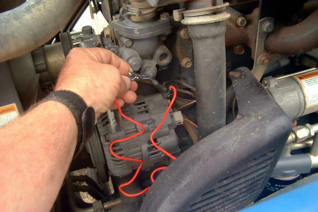

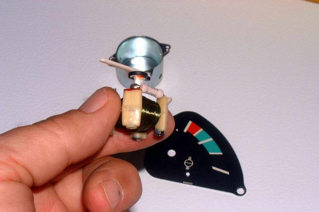

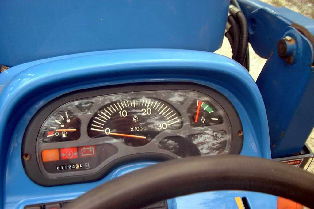

With the the instrument panel in the tractor and the ignition key off, I jumpered between the temperature probe and a convenient ground (photo 12). I turned on the key for just a couple of seconds and the gage read full scale. Success! (photo 13). I let the tractor warm up for about 10 minutes and my temperature gage read normal range (photo 14).:) So even though the old gage tested good, it was bad.:rolleyes: To see how the old gage was made, I did further disassembly. Everything is buried in a coil of wire (photo 15). The only thing I can imagine that might be wrong is residue from condensation caused the meter needle to have more friction internally within the windings. Anyhow, I'm just happy my $44 wasn't wasted.:cool::D

Glad you were able to get your gage working again Jim. 44 bucks sounds a lot better than the 300+ dollar cost for a new cluster.

Did you try removing and reinstalling the old gage? My guess is a bad connection on the plug-in, gage was ok??

I believe a bad connection is what the resistance checks would show up. Since they all read in a satisfactory range, the bad connection was eliminated. I did keep the old gage because I could apply some lube to the needle pin, but I have to be very careful with that since many lubes could also dissolve the wire's insulation varnish.
