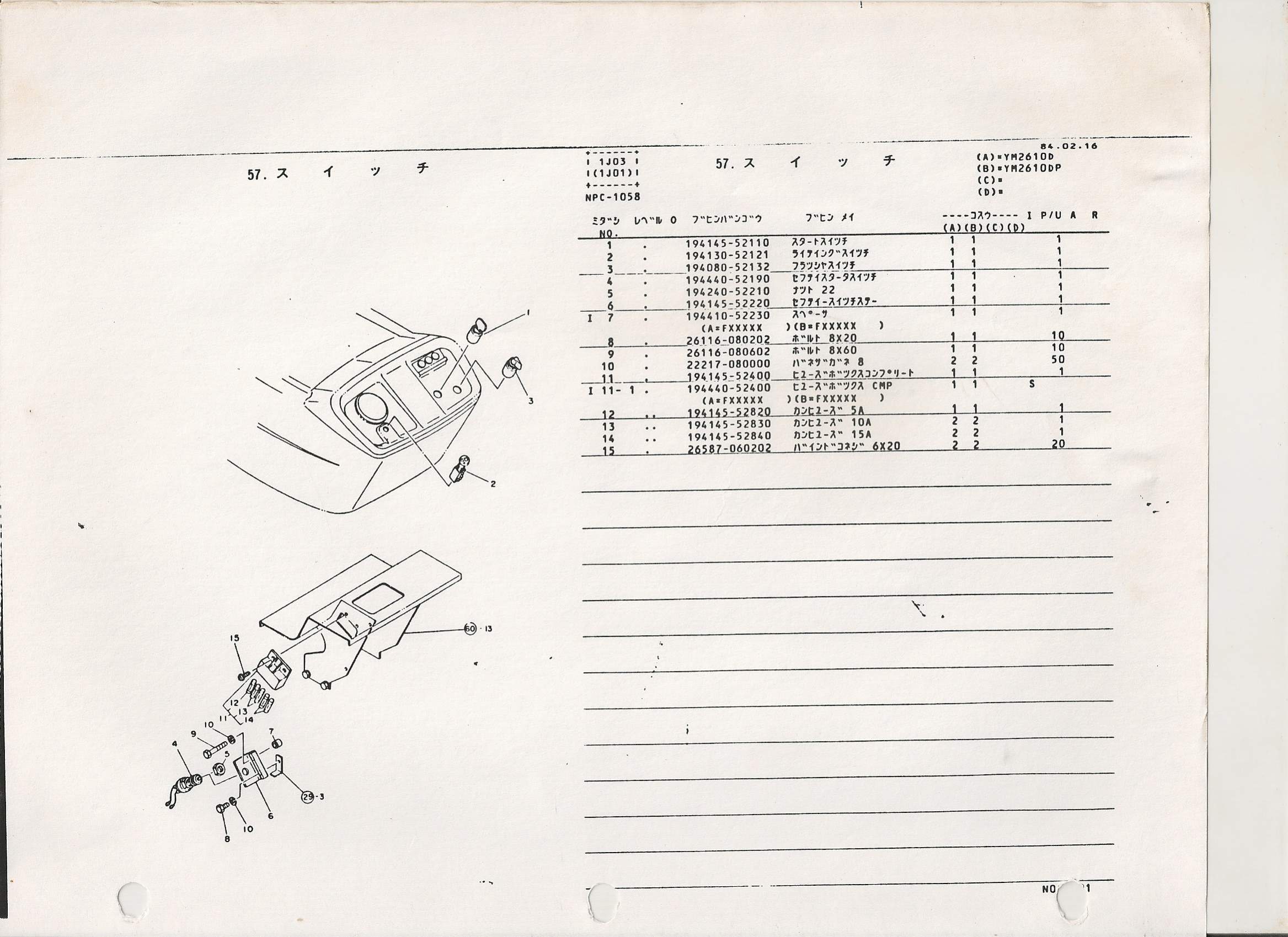

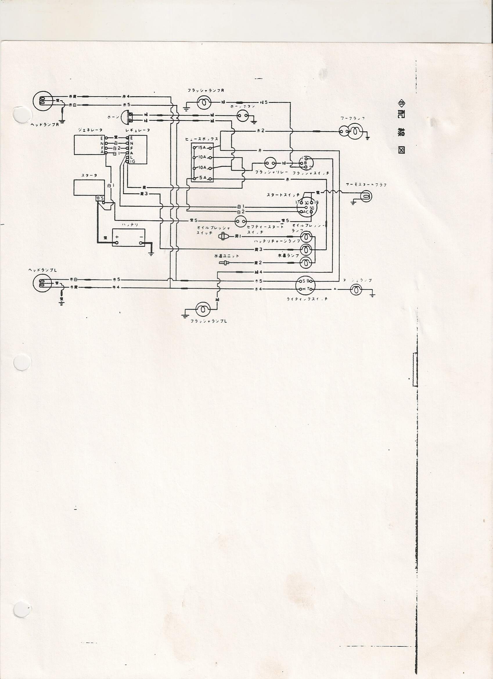

Winston, since the fuse box was talked about, do you know the fuse box positions for a YM2500/YM2610 maybe?
Also, I've booked marked your thread for the gauge too. It should fit my gauge panel too.
RUMBLON, You horn switch cover looks in bad shape. I've looked around the web for a replacement for mine, but Hoye, Fredricks and other places no longer offer them. I did find something really close in comparison being a marine horn button or a Club Cart horn button. It costs more than a new shiny penny though.
Here is the fuse box parts page and electrical schematic from the 2610 parts manual.
