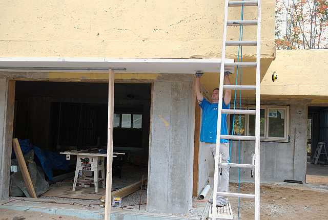

Looks like a little better job on your concrete (than ours) Sam. We don't have any bad spots that are structural, our skylight is a bit rough and one of the retaining walls doesn't look so hot.
I thought I had a shot of the exterior stucco. We really like how it came out. I'll get one and post it later.
There are inevitably going to be a lot of passers-by curious about what's going on, especially after the first time you show up in a local news article. We're taking the opportunity to show people the advantages of this type of construction.
Steve

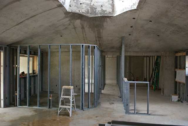

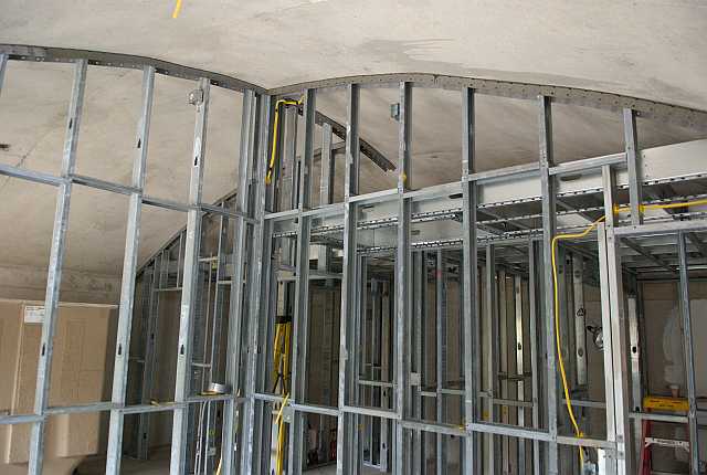

I see a lot of progress Steve, I would have liked to sub more of our build but we simply just couldn't afford too. We have had some progress but not like employing a crew or more.
We live a half mile off a private road and our drive way is posted multiple times around and after the gate. I guess we must keep our gate closed at all times. We have avoided and news exposure because we like to keep in private on the local level.
Please post more pictures. I like the way the steel framing bends with the ceiling line!

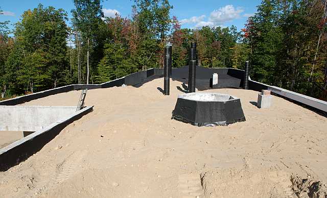

Steve
Steve, is that soil or stucco or something else on your roof in the first pic?
Glad to see you are making progress there. Do you have a move in target date?
Dave.
That's what passes for dirt in Maine. You'd probably call it sand. Topsoil is known as "loom", spelled loam. You can probably tell, I'm 'from away' as they say here. We moved from Colorado six years ago.
