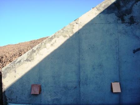

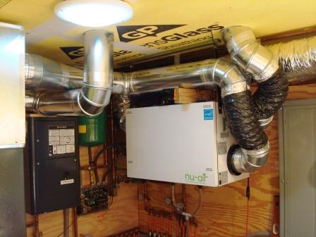

Are these ventilation tubes based on the earth tube idea? I have been reading about them and considering using them for our ventilation. Anybody else have any experience with them? Terra Dome is recomending the heat exchangers.
   / Terra-Dome Earth Shelter Build #670
The earth tubes serve to temper the fresh air to the HRV unit improving its efficiency . TD recommends a central de-humidifier with fresh air inlet. The earth tube/HRV arrangement has worked well. John Hiat's book Improving the Earth Shelter gives a comprehensive guide on the passive use of earth tubes.
Bob
