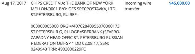

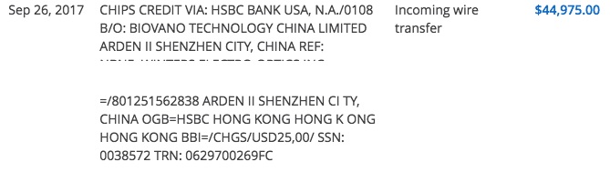

The conspiracy continues to grow.
Have you started receiving your payoffs yet? I get mine from China at the end of every month. Go AGW!
Sometimes the Russians toss in a bonus if I post enough on online forums.
