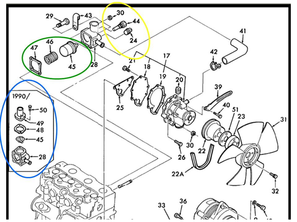

JC/JIM, I don't think the water temp ever gets hot enough to tell the temp sender to to give a temp reading to the gauge and that's why the gauge always remains on cold, even if the t-start bypass plug jammed the t-start partly open it would not be held open enough to keep it from getting hot enough because the t-stat is always wide open in this case. I think that's the problem? of course there is away's the chance there is a dual problem and the temp sensor is at fault also.?Am going to start by first replacing the t-stat $37+ dollars and see if that fixes it first if you agree with me. I can't thank you and Jim for helping me get my head on straight and hanging in with me on this problem I sure understand the system a lot better.INFO: By the way one of the things I found that their wasn't any information on that I could find was the location of the low water sender to the dash board warning light. it's on the bottom of the water overflow tank. Will keep in touch, Paul

HI" Jim,
Do you think that dingle can hold the t-stat open enough to give a full or almost full flow to cool the eng. As is in my case? Paul
/ testing temp gauge #52
"If Paul takes out the thermostat and the little dangle is holding it open, he can just cut the dangle off with a set of diagonal pliers and put the thermostat back into his tractor without spending the big bucks for a new one. Once he gets the coolant to the proper temperature, then he can analyze the proper function of the sending unit and gage. "

/ testing temp gauge #54
HI" Jim,
The simple answer is just yes, that is the normal response to the dangle holding the thermostat open. The engine temperature never rises. There have been probably a dozen of us with this problem reported on TBN. In every case the temperature stays literally at cold. Some of us with Boomers have had a simple drain line hose also bypass the thermostat. Even that small amount of uncontrolled coolant caused a huge lowering of temperature. People like me with that problem also fixed it by installing a cutoff valve in the engine block drain hose. The radiator on these compacts seems to be way overengineered probably due to the fact that tractors often get dirt/lint clogs when working. When everything is clean and clear, a small opening of the thermostat will have a huge effect on engine operating temperature.

JIM
Ok' I will stay with the original plan of attack and start with the t-stat. Will have to make the tip to town first' Will let you know as soon as I open it and don't want to start tlll I have the parts in case we need the tractor. Be in touch, Paul
