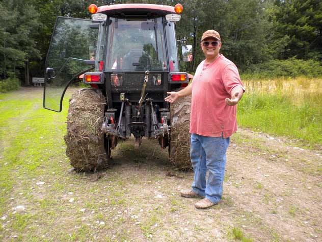

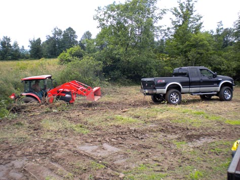

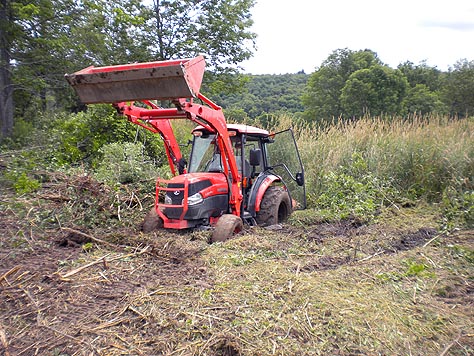

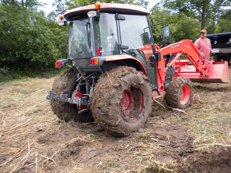

Don't go into the pond!!! :eek:
Be afraid. Be very afraid...:shocked:
I speak from personal experience.
See the pictures below.

Wow! The ground around your tractor doesn't even look that bad (wet or swampy, that is)! I'd have fallen for it ... I mean into it ... too :eek: I Most of my acres is wetlands that look similar. Maybe I'll be posting similar pics someday. At least that big ol' pickup was able to help pull you out.

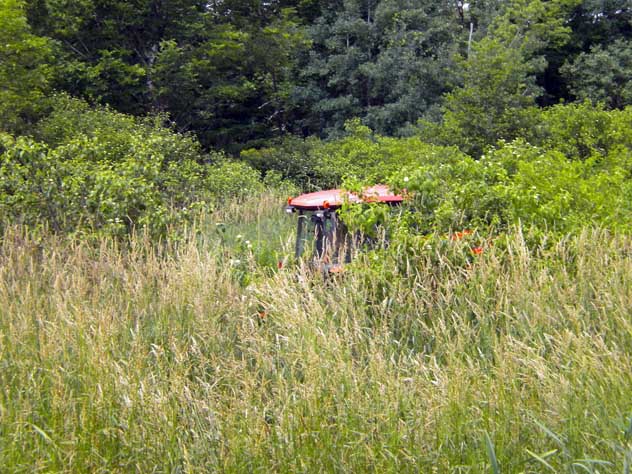

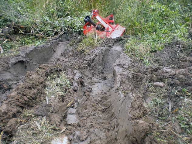

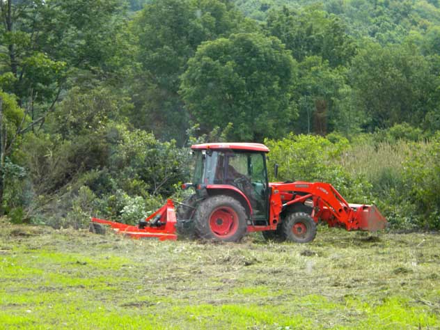

It started out very overgrown. I was in the midst of brush hogging the brush. I had been over the same area several times when...... the bottom falls out from under me. :confused3:
I ended up hiring a guy with a BIG dozer and a track excavator that can practically reach across the pond. Now I'll have a pond 3 times the size and 20 feet deep in the middle. I could never have done what he did with my L3240. I tried, but it was beating up the tractor more than I care to. Money well spent. :thumbsup:
I'll put in a few pictures when he completes the job. He's still roughing the pond in. I'll do the landscaping after he's done. A man's gotta know his limits (and his tractors limits). :tractor:
Plenty more to do within the capacity of my tractor. :cool:
