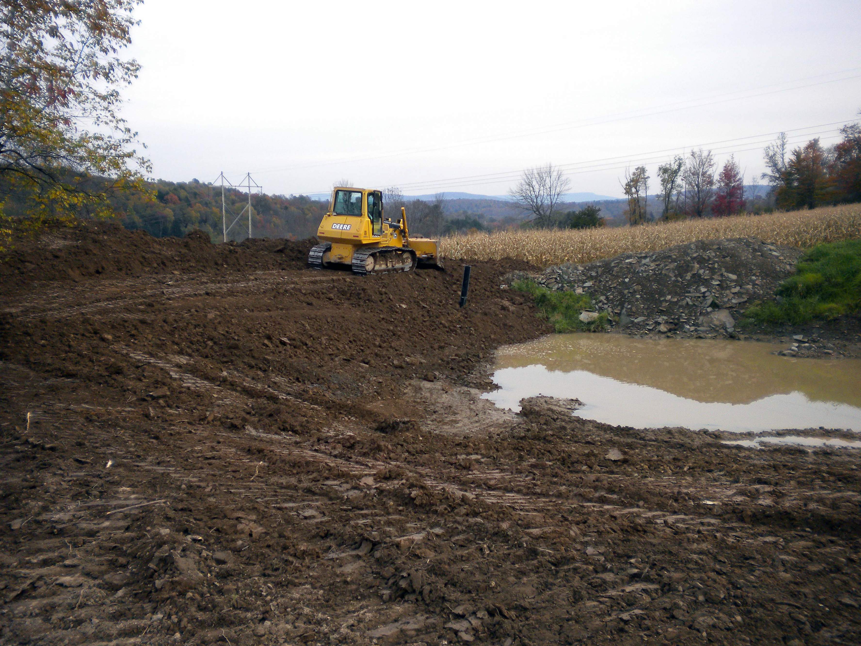

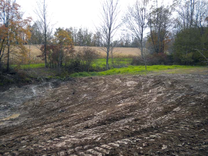

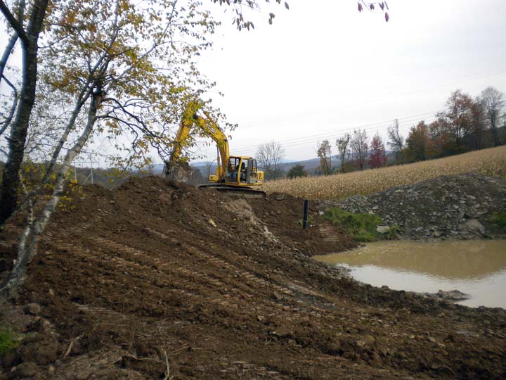

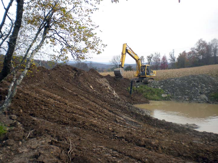

Here's what I ended up doing. Way to much for my TLB to handle.
Looks good. There's really no substitute for using the right tool to achieve the right result. :thumbsup:

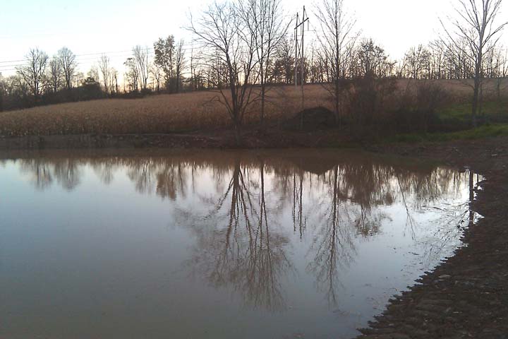

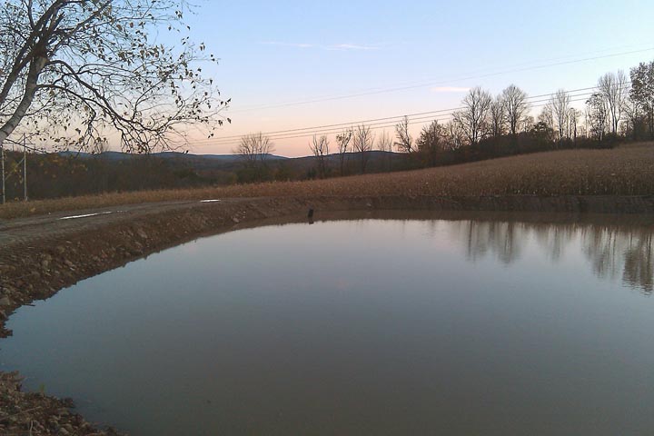

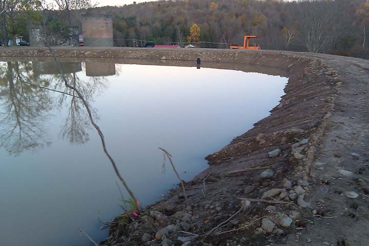

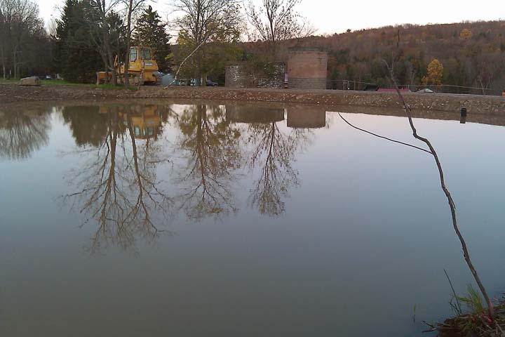

To think I would even try and dig out the mud with an L3240. :confused2:
Stay out of deep mud.
I'll be doing the landscaping now, which is well within the capacity of me and my L3240. I hope I can start the grass before the snow comes. :thumbsup:
It's funny how getting stuck a couple of times improves our foresight. There's nothing like having to step up to get off the tractor to make you realize it ain't the right tool for the job.:ashamed:
That's a very nice pond Mark. Do you have an emergency spillway or will you just rely on overflow pipes? I can't tell from your pictures. It sure looks like it is going to be a beautiful body of water, but the freeboard of your dam above the water worries me a bit since it is newly compressed soil.
