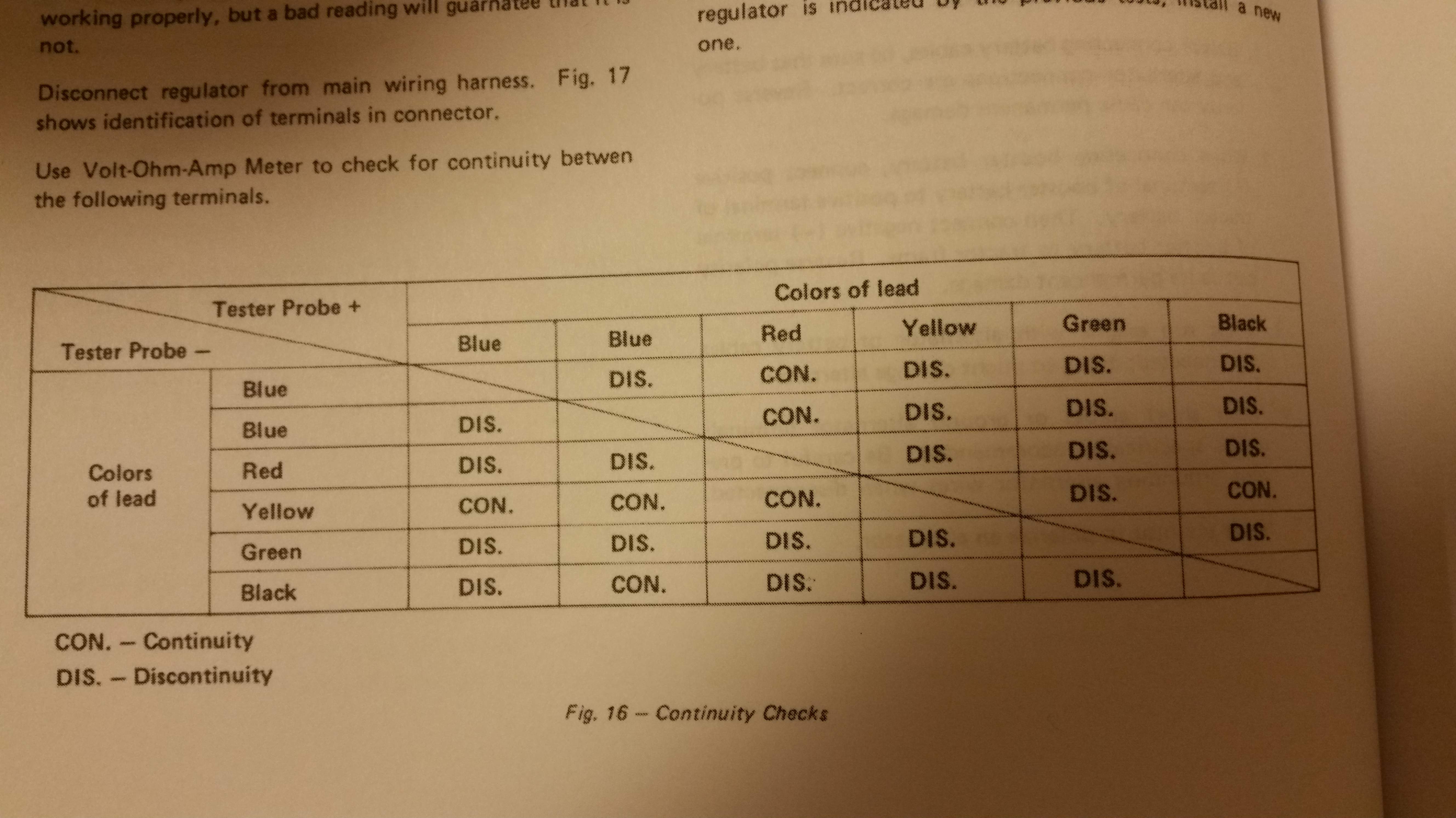

My tractor isn't charging its battery. I tested the alternator and it seems to be working. How do you test the voltage regulator? What are the other likely culprits? I hate to just start replacing parts. What about wiring or connectors?
The little alternator light on the dash is on.
The tractor is a ym2010.
Thanks
/ Testing Voltage Regulator #2
Start with the simple first. Check ground wire as well as positive connections. Test the voltage going into and out of the voltage regulator.
Should be around 12.8 to 13.7 volts coming out of the regulator. If you can read the label on the regulator it should tell you what the output should be.
Measure the voltage on the battery terminals while the tractor is running. If less than 12v then the problem is most likely the regulator.
Have you load tested the battery? It may show 12v but with a bad cell cannot put out the amps.
Anyone try this procedure? I did and it looks like the voltage regulator is bad. 1447454948186.jpg

I wish I were that lucky. My regulator shows no conductivity between any of the terminals, i.e. completely dead.
