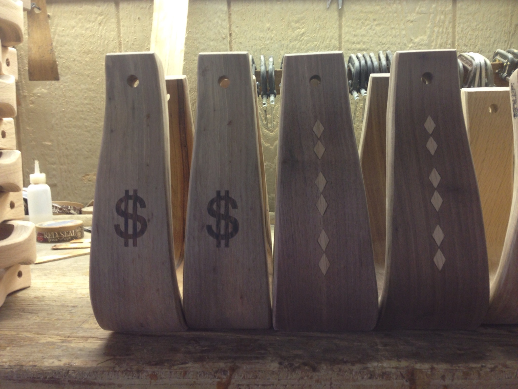

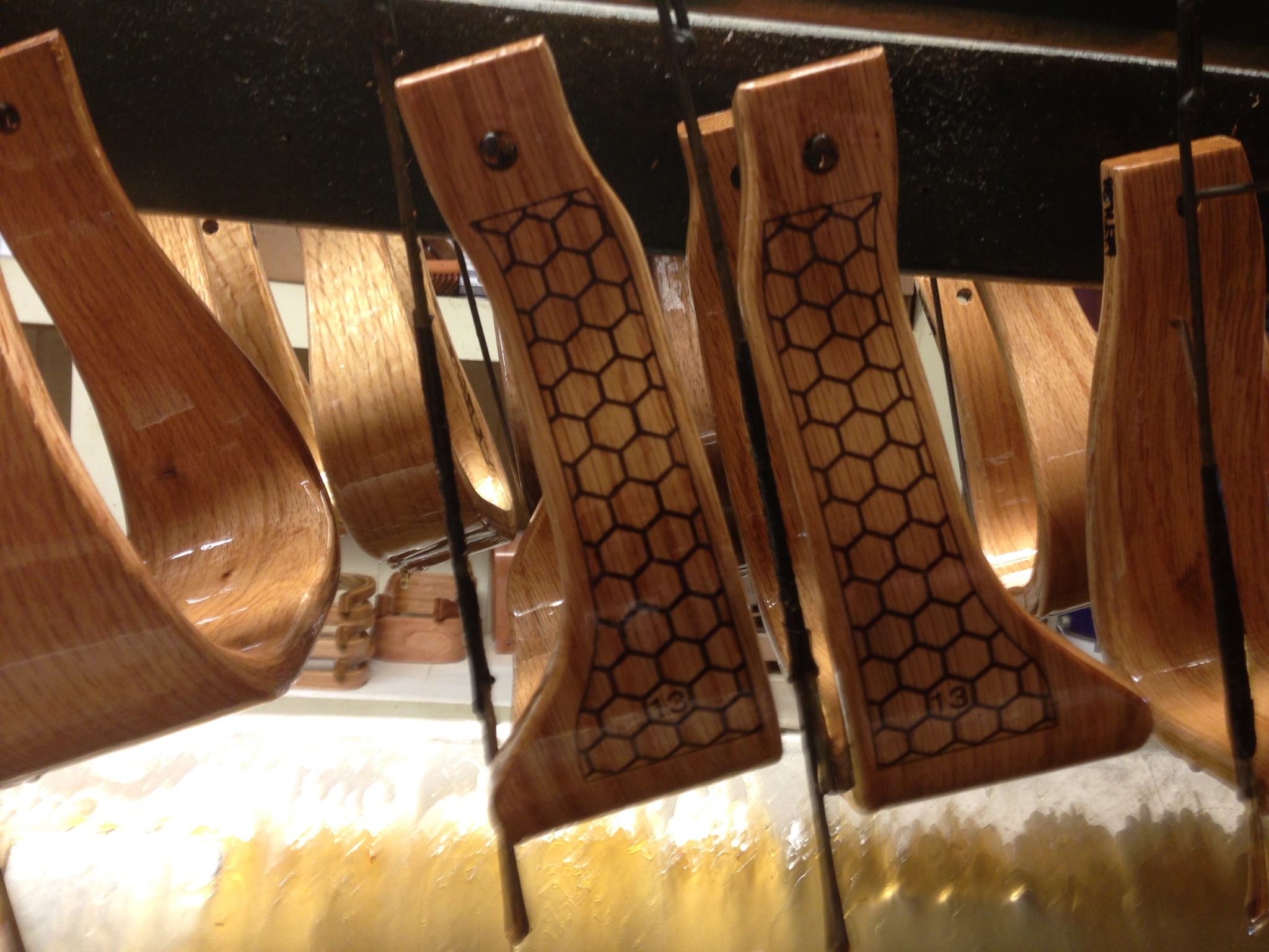

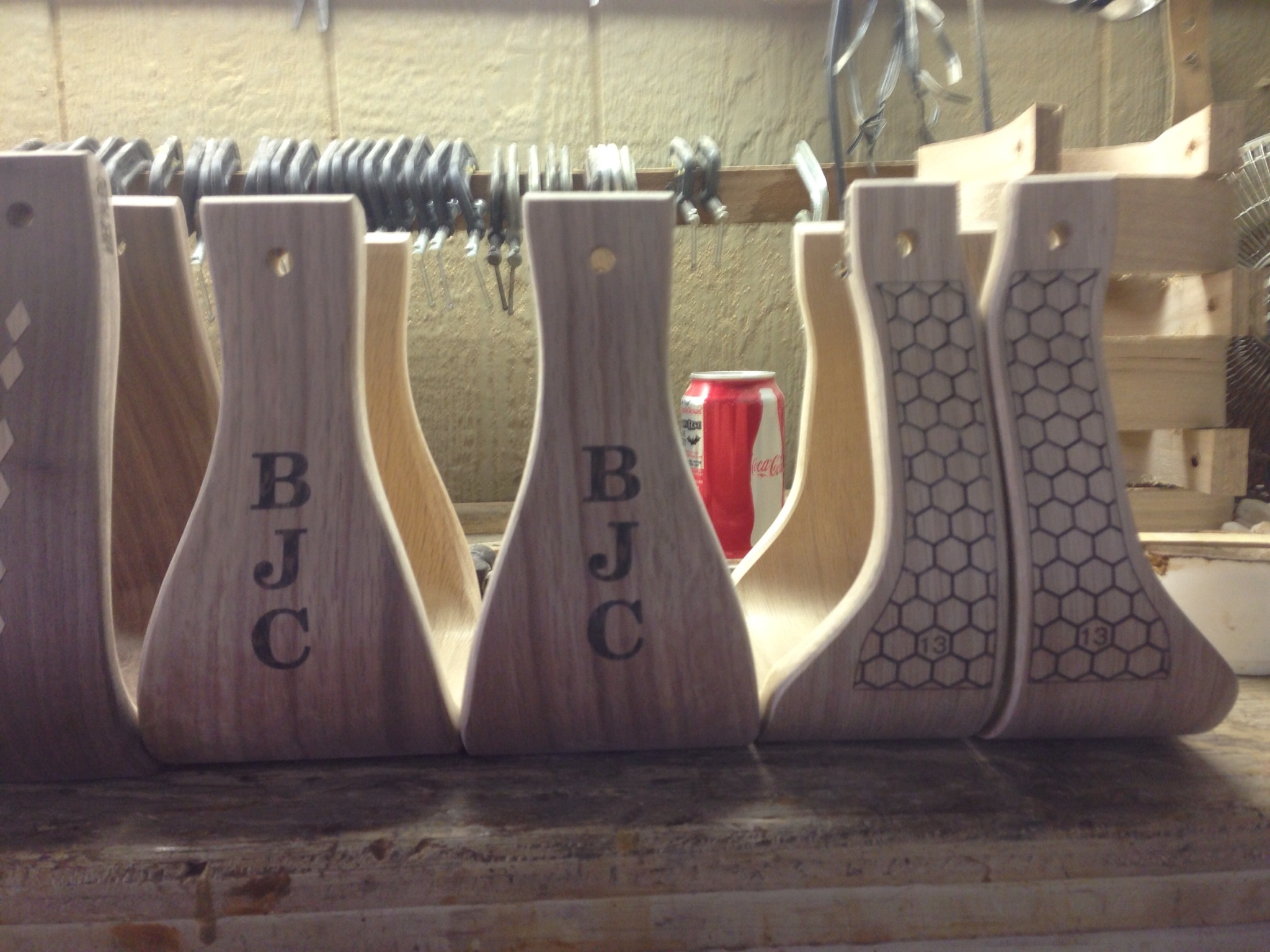

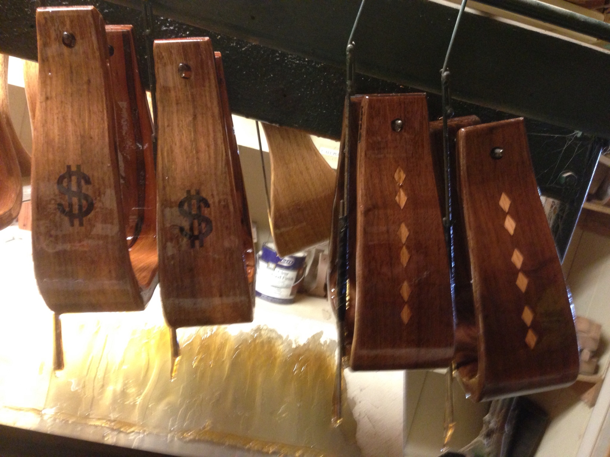

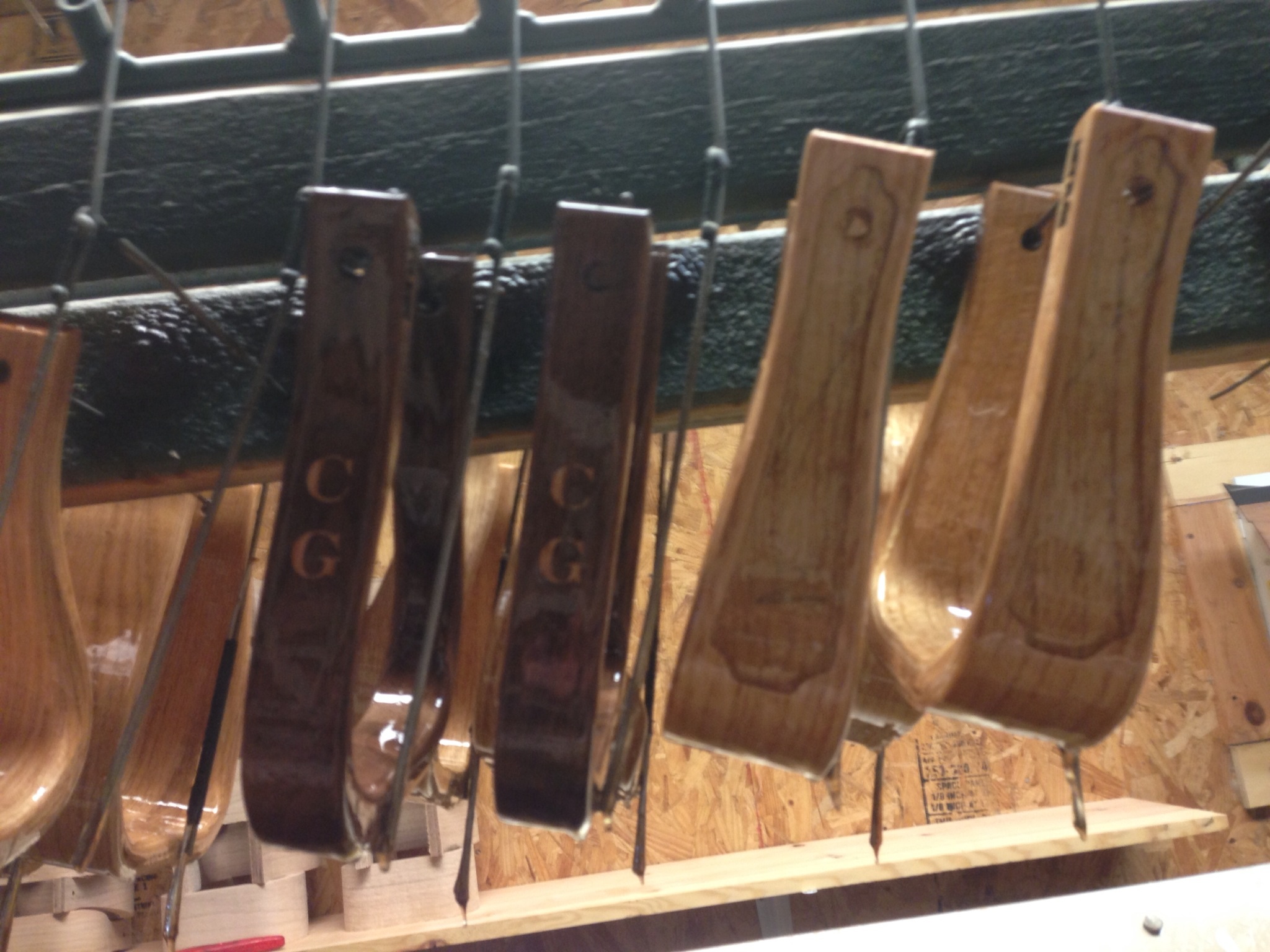

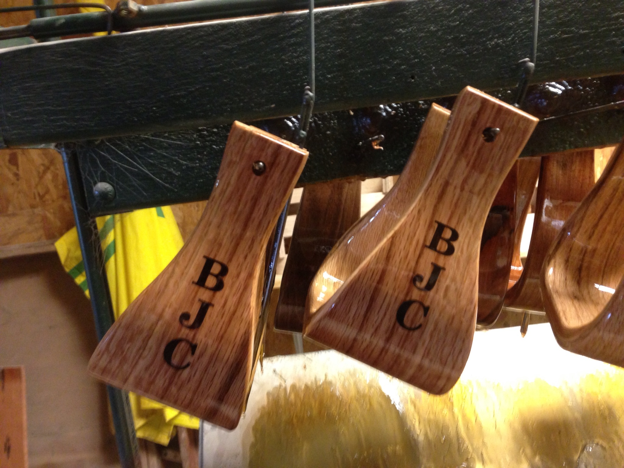

A few more Christmas orders.
Before lacquer.
After lacquer.

Yes .. Absolutely beautiful ... Do you make them year round? A hobby or a profession?
/ Texas Fall/Winter thread! #6,291
I'm still trying to figure out how you bend the wood?????
/ Texas Fall/Winter thread! #6,293
I'm betting all those C clamps in the background have something to do with it. and a steamer oven maybe?
/ Texas Fall/Winter thread! #6,296
Ok, apparently I didn't see the last page when I posted this morning. My dad and cousin go out and cut the trees and bring em in. We have a band saw kinda similar to one Brandi was commenting about while back. The log is sliced in veneers about 1/8" thick which is placed in a stainless cooking pot. Heated then when limber enough it's bent. Then allowed to dry and run thru a glue machine. From there it can be sliced out on a modified radial arm saw to width. Then shaping, sanding, and finishing.
