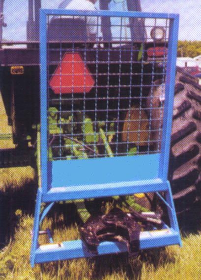

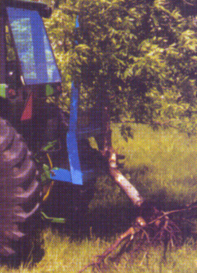

For your honeysuckle a 3 point tree puller and a ratchet-rake might be the fastest way to clear 4 acres.
Remember that the 3 point has more lift power.
From: 200-30 Post And Tree Puller

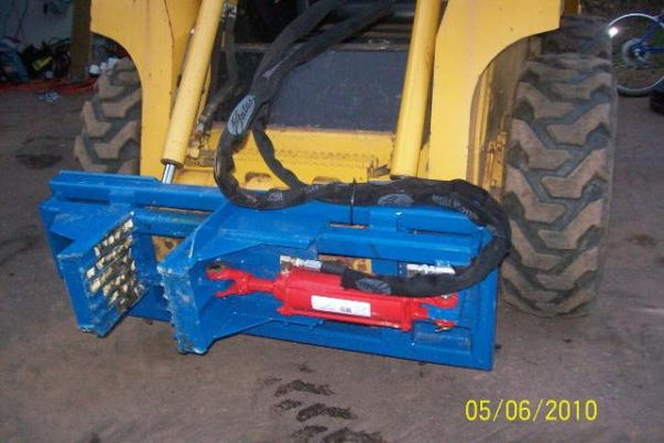

This guy will make them with a 3 point mount.
Buckthorn Puller - Custom built Skid Steer attachments to fit almost any need you may have.
My tree puller thread: http://www.tractorbynet.com/forums/attachments/277824-tree-puller.html

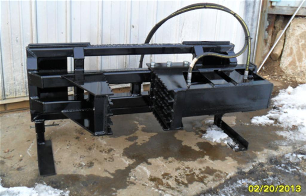

This is the classic problem with Rake grapples. Shorter Lower tines do not allow the rake grapple to pick up much since there is little lower support to the load. Longer lower tines allow the grapple to pick up more load. Longer tines allow deeper penetration into the soil for root removal. Shorter lower tines allow for better back raking since longer lower tines prevent using the lid with FEL float to back rake.
I don't think there is an ideal multipurpose grapple so I have three. A short lower tine Rake, a wide L bottom with tall opening and a narrow L bottom. Each with their own use. When working an area, I take as many as I need and just swap them out during the day.

I also think the Faver design is nice. The lack of cross brace tube reminds me of my Wildkat Deep Penetration grapple. You can use the tips more effectively to penetrate into tree limbs, etc. when picking things up. Faver uses a high quality steel that allows them that long of a lower tine without as much danger of bending the tines which I think is the real reason mild steel grapples have the cross tube out front. I like their narrow 31" model. The upper tines cross over the lower tines in the attached image, making for a very small 12.5" holding area compared to most L bottom grapples.
This is the exact model that I have on order. Should be here in a couple of weeks...
