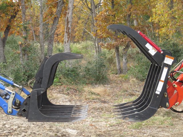

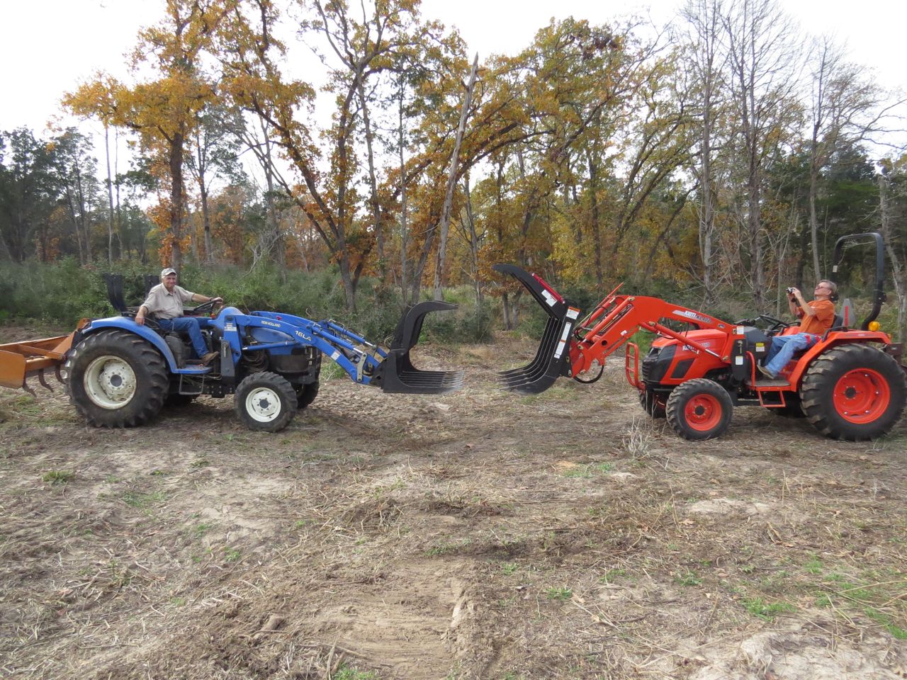

To the rescue Mikim from central Texas and Ronjhall, from Michigan get together for a "Test the grapples day":
Bucket style grapple Vs. Rake style grapple
The Bucket style grapple is on the left and the rake style grapple in on the right below.

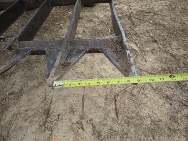

First lets look at the grapples.
The bucket has tines that have an 8.5" space in-between while the rake's is 13.5"
The rake also will open about 1.5' wider than the bucket.
Both are the same width of about 60"
You can tell the bucket bottom is flat and the rake is curved.
The tines on the this particular bucket grapple have a spade shape while the rake is more pointed.

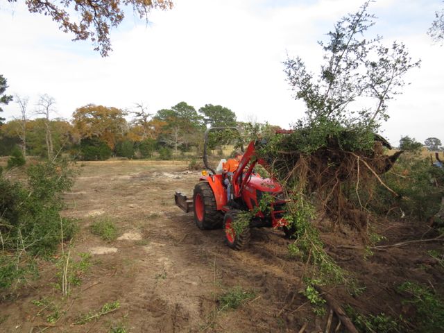

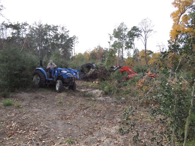

A few pics of removing Yaupon.
/ Texas Grapple Shootout
Evaluation:
Both grapples picked up and hauled the Yaupon effectively. It was a little easier to push the rake grapple without having to adjust for depth corrections and angles. The spaded ends of the bucket grapple did pick up more sand while the large spacing of the rake grapple missed some roots and required a second pass sometimes. The rake grapple with its wider opening did move a large pile of Yaupon easier with one large bite.
I will be looking mostly at a rake style grapple with tines spaced just a bit closer together and maybe a bit longer.
Thanks Mikim for providing the tractors and the grapples. It was a very enjoyable and educational day. Nothing is better than getting together with friends and tractors.

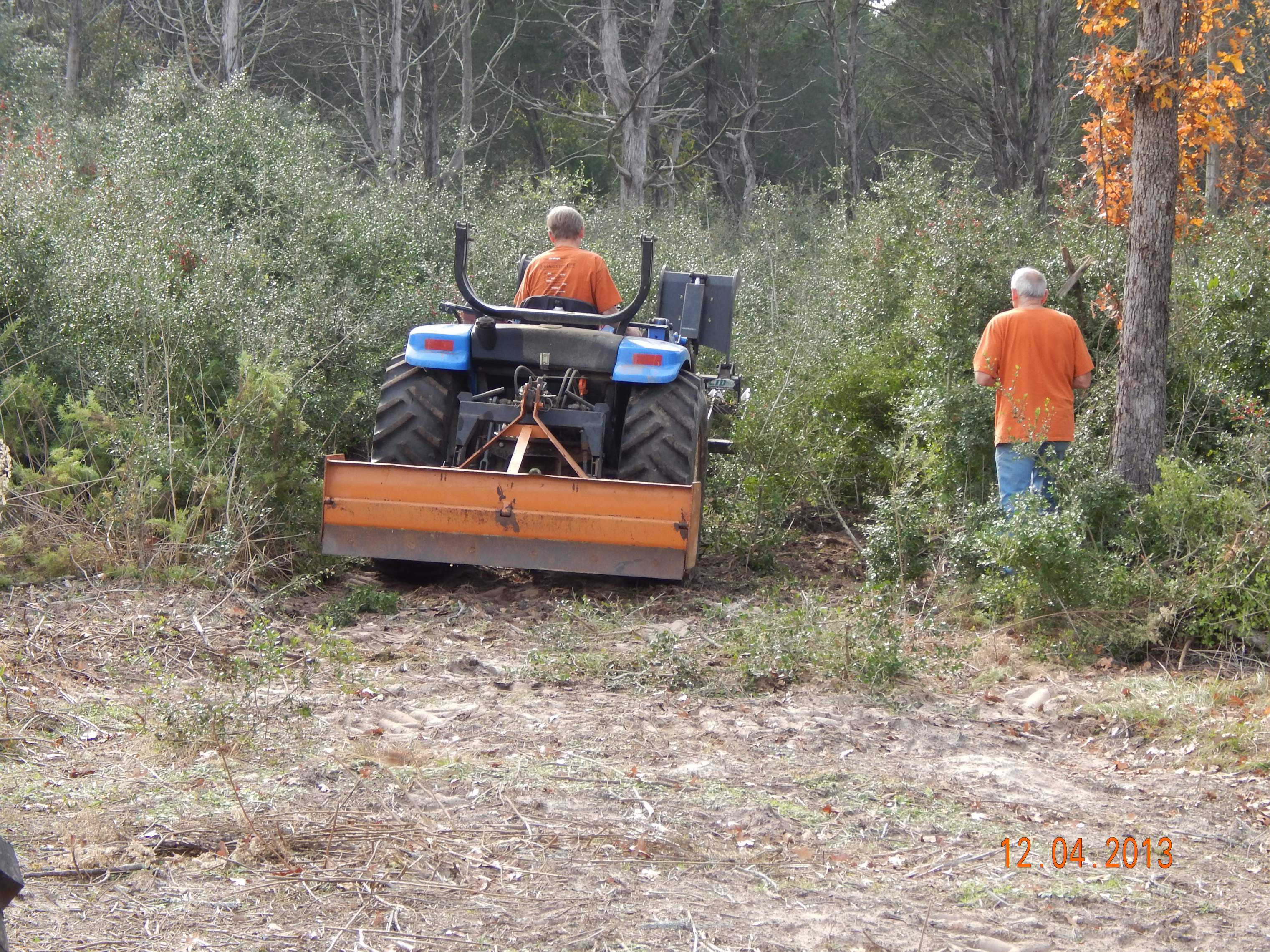

DSCN0045.jpgDSCN0063.jpgI certainly enjoyed it -- and the shiner on the porch after was good too , thank you don. Here's a shot of the brush we were after and do you think Ron looks like he was having a good time?
