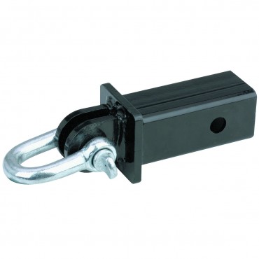

I like a big slide hook in the center and a grab hook on each corner. I lay the chain in the slide hook and grab it at the corner. Quick and easy.
LBT, I wish I'd seen your center setup before I did mine. I have my receiver tube above the slide hook. That setup of yours is way skookum!
   / Thanks for all your chatter! #27

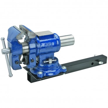

Yeah, I got the receiver idea from another post on TBN. I also got both of these items from Harbor Freight:
Real easy to swap out to whatever you need at the time. Used the vise mount a lot when building the hoses for the diverter install.
