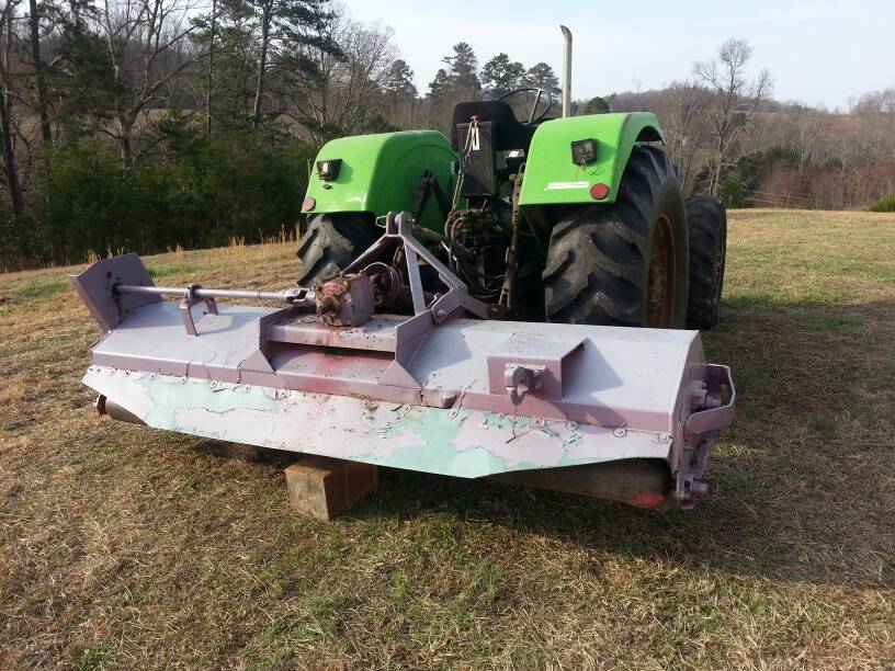

First off, this being my first thread I started, I just want to say this place is great. After reading through 384 pages and 3839 posts, I purchased a DANDL 9 foot flail mower on ebay. Could not find any bad reviews, or good reviews, so will do that once I get it. I have to arrange shipping yet.
Here is the mower I purchased...
9' Dandl Flail Mower
That being said, a little background. My wife and I have a 21 acre homestead in Eastern TN that we are planning to move full time to next June. We have about 15 of those acres in pasture and brush hog 3-4 times a year now. I am hesitant to rotary mow near the house as we have dogs and rotary mowers throw things sometimes. :laughing: I have been looking for a solution to this, which brings me to this recent purchase. I have used a 5', a 7' and a 10' rotary, but don't care for the (winrows?) left behind from mowing. Also with the blackberries that sprout up, I would like to chop them finer than the pieces left behind by the rotary.
I know I should not have purchased the flail without testing it first. I have been assured by the seller that all works as it should, and am mechanically inclined and can repair anything that is broken within reason.

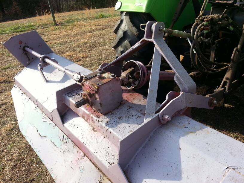

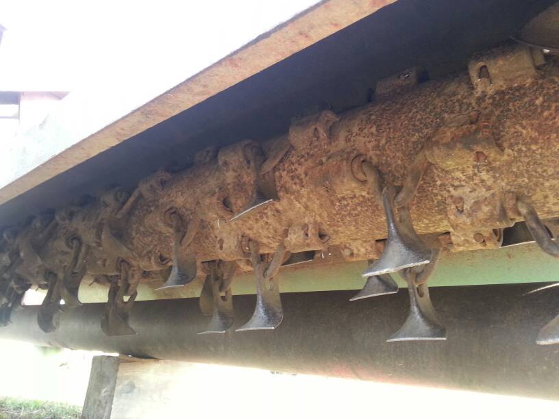

Update - First thing I noticed about the mower is that it can be converted to either rotation rather easily. The PO had the flail running in tire rotation direction, and while it cut, it did not have the air flow sucking in dry leaves as I mowed. This mower has 80 stations with duckfoot blades, though the PO did also provide a bucket of spares and side cutters. I flipped the gearbox to reverse the rotation, input on front and rear of gearbox, (blades cutting opposite tire rotation) and am currently in the middle of reversing the duckfoot blades. Should be done in a couple of hours, after I finish my coffee ;-) .
Couple of observations, the deck is really heavy, approximately 3/16" thickness. Also, it has better eyesight than I, as it found some fence wire I could not even see. Also, barbed wire is more of a pain to remove than steel 2-wire barbless (whatever that really is called). Learned to be even more careful as I can not get those three hours back.
All in all very happy with the mower. Will post pictures later after mowing the new configuration...

Pictures as promised.
