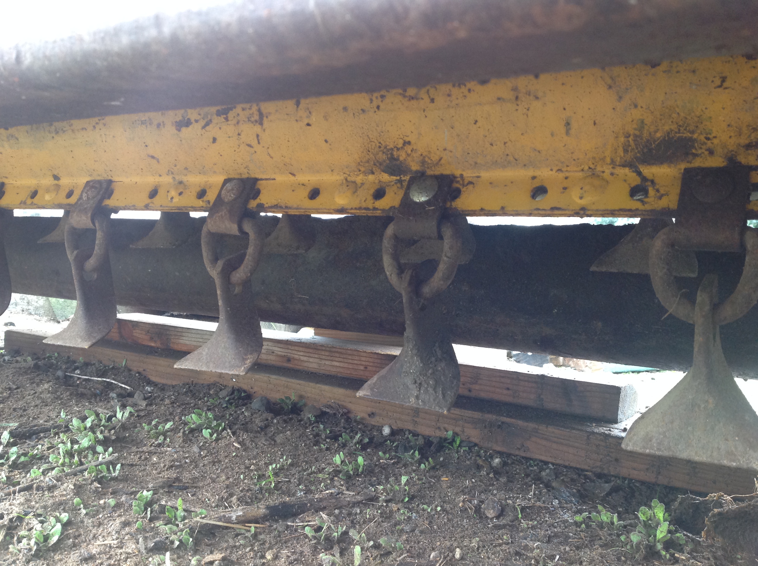

First off, the D rings come in two sizes that I know about... the 7/16" (inch) is one of the two sized
sold at Tractor Supply. I buy the larger/thicker of the two sized, but sometimes it's near impossible to
use the large size without pulling the entire O-ring down, which means pulling the rod(s) out through
the side, and that's certainly no fun. So I buy a mix of both size(s) D-rings and try to use the larger of
the two when i can fit them in/on to the O-ring. Don't let the D-rings wear down or you'll start to
hear the cutters hitting the inside of the mower itself. You'll find the steel of the D-rings is not super
strong or hard and they will wear out fairly fast, you will see a grove where the actual cutter swings.
I buy the D-rings from tractor supply, they run about $1.49 to $1.89 each depending on the size. You
can buy them on line and you can tell them you're a farm/ag and they discount the state tax if your
specific state has a high sales tax rate.
If you have decent scoop or duck foot cutters installed, the thing is a marvel to use and will clear
quite a nice and low path. All flail mowers bog down in high grass, the Dandl handles it better than
most any other. Buy the cutters with the teflon or ceramic cutting tip coating... they will actually
last more than 15 minute when you're chewing a lot of debris in a field.

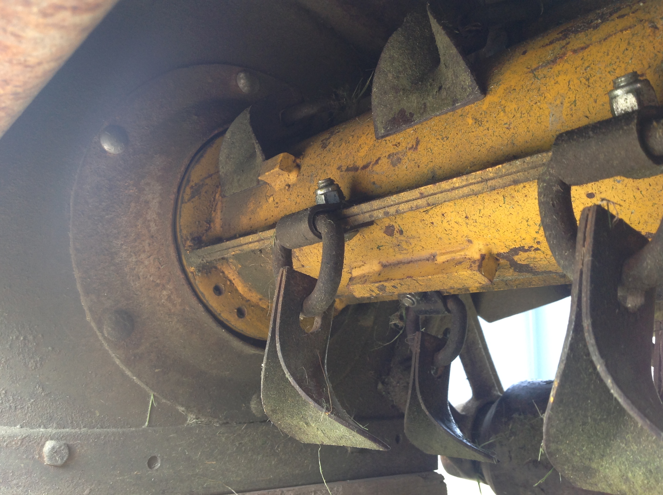

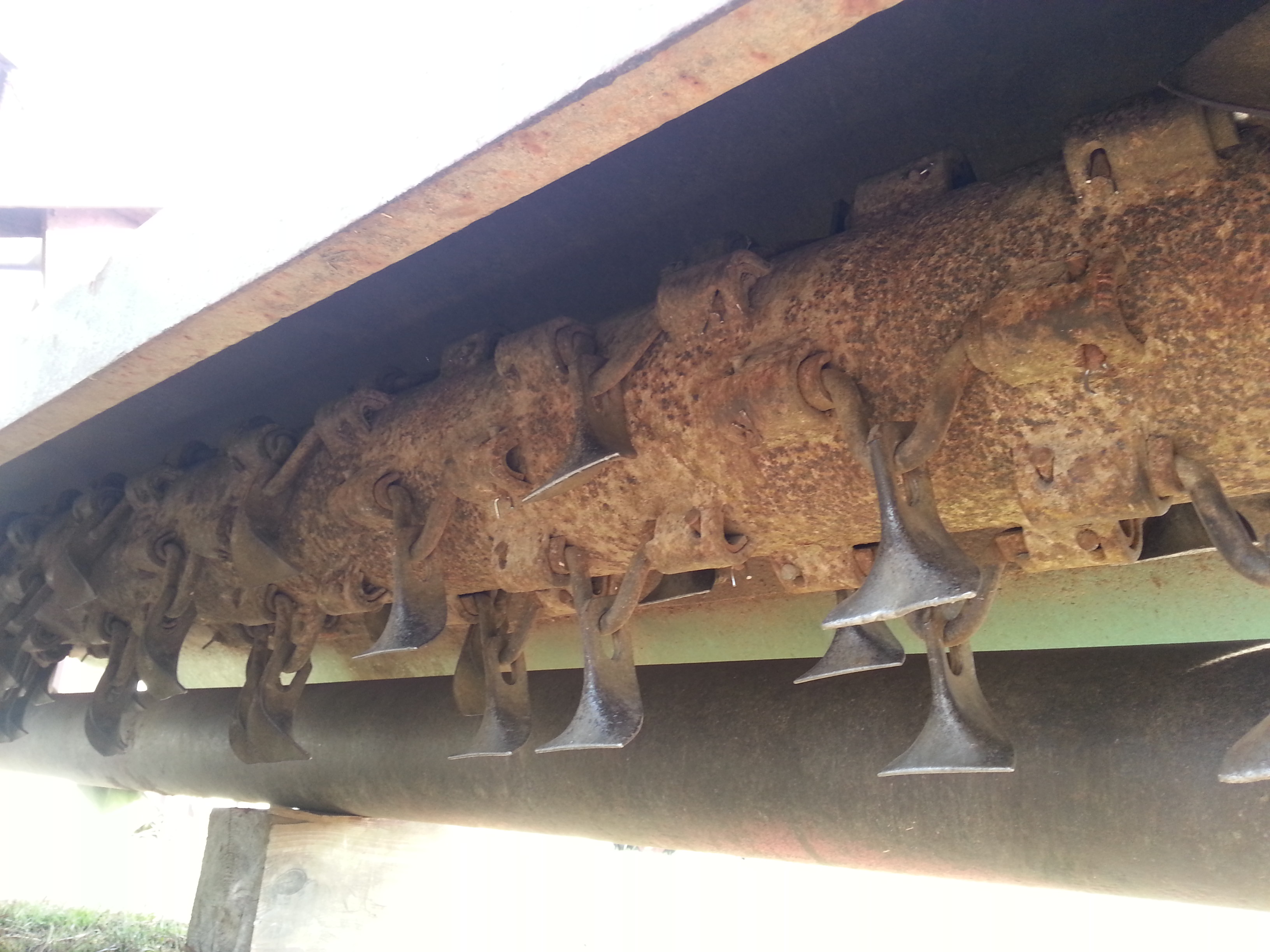

Hello, I just went through the exact same situation with my old bush Hog FM188/ ford 917. The rotor was spinning the same direction as the tires and the blades where on backwards and all I did was reverse the blades because you want the rotor spinning the same direction of your tires so the blades create a suction and lift the grass up that you flattened with your tractor tires. Why did you flip your gearbox over instead of flipping the blades?
Blades installed backwards
Blades installed the correct direction.
If I'm wrong about your brand of flail or missing something others please chime in.
My blades were on correctly for the tire rotation direction but wanted to try to see the difference with the opposite rotation. Here is a picture of the blades while in the process of reversing them.
Changing rotor direction on this flail is a 10 minuted job. Remove 4 mounting bolt from under the gearbox mounting plate, slide the gearbox off the drive shaft, flip and reinstall. Just have to swap the gearbox breather with the plug on the bottom.
The mower cuts great but am switching to the Y blades from Flail Master as I would like to cut more than grass. Also reversing direction would not require flipping blades. The mower is 9' and has 60 stations.
Jwedd and Ink, thanks for the info, funny thing is that I'm doing just the opposite, switching back to the scoop blades because my field is not that thick, just ordered the standard scoop knives from flail-master should be here next week. The y-knives left a lot of fox tails so I need a closer cut.
