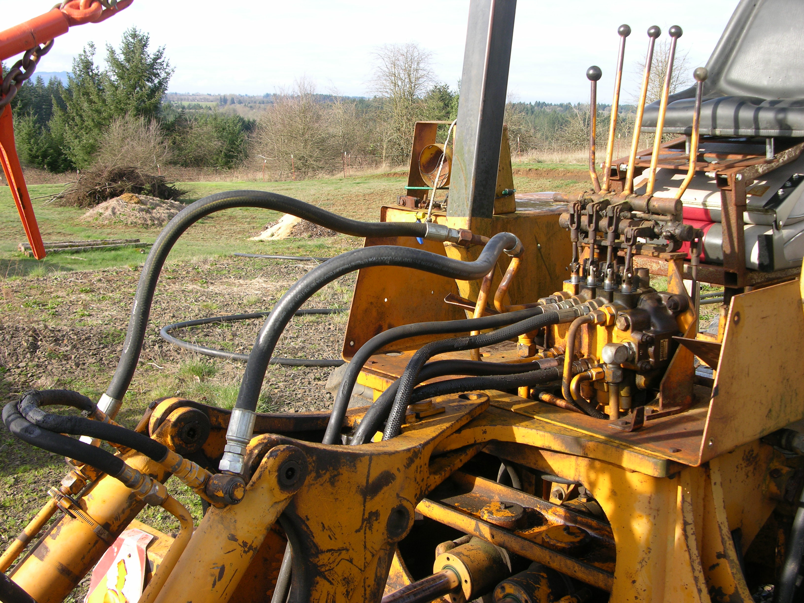

My 580B wasn't too wobbly, but the mechanism was gettin' old and cranky (kinda like me) and about half the time I couldn't get the spring loaded pin to lock in when I reversed/raised/lowerd it - it kept getting MORE irritating, since several of the jobs I do around my place keep me swapping back and forth between driving and hoe-ing - plus, the seat was gettin' long in the tooth, so I threw it away along with the plywood it was upholstered to, dug out an old folding boat seat (new old, that is) and replaced the tractor seat with that - then welded up a frame to support a fairly cheap non-folding replacement tractor seat - like digginit's it ain't purty, but my seat swap time went from a couple minutes to a couple SECONDS - adds up quicker than you might think...
Anyway, found a couple pics from when I was doing a re-hose several years ago (guess I shoulda painted the sucker back then :rolleyes:
If you look about where the controls bend, you can see the hoe seat's hinges -
The one downside - that setup puts the hoe seat 2-3 inches higher than the stock one was, found out the hard way that if I'm tryin' to grub out a stubborn stump, WEAR A HARD HAT - one particular bugger the bucket tooth popped off and the entire hoe bounced back at me - the roof crossbar is at least 3" steel tube, caught me across the forehead :eek: I didn't quite pass out, but almost.
You might be able to do something similar to mine with slightly different geometry, or maybe your rops is different; anyway, something to consider... Steve
