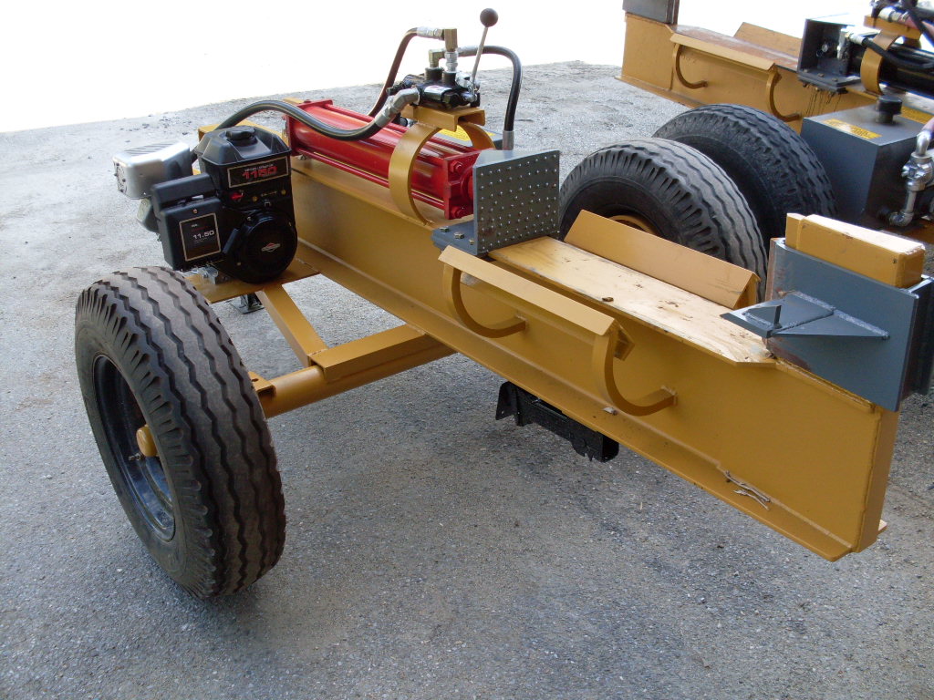

the lenght of the ram is the length of wood I burn I believe I said you should shape the splitter to the length you burn.
log tables are great but you still need to pick up the odd size chunk
heres a few I built and I like the three way best if you dont oh well
   / the absolute best splitter for the money #40
You've built some sweet splitters there. :thumbsup:
