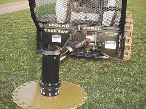

I operated a skid steer with a spinning blade on the front clearing cedar and I was pretty impressed with what it would do, especially for the small stuff you are talking about it might work pretty well. I also liked the ability to cut right at or slightly below grade.. The owner put stump grinder teeth on the blade and just replaced them instead of the whole blade. Looked similar to this.
