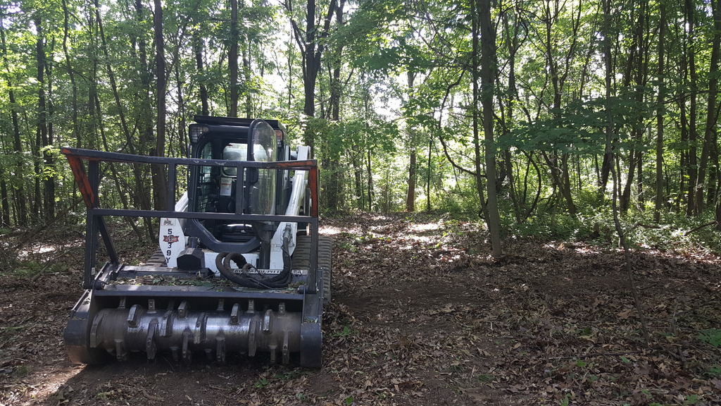

DickFoster has the right idea, I have rented this machine several times. One weekend a mowed 1.5 miles of trail about 12' wide through all types of vegetation. Heavy Heavy brush that my brush hog wouldn't touch up to 5 and 6 inch trees. Fast, efficient, and the only way to go.

Don't know what you have in your area but I rented one from CAT NC Rentals out here in the PNW before I took the plunge. Not a cheap rental but one week or three days was the same price. The reason the rental is not cheap is that they are expensive pieces pf equipment and the tools on the mulching head are pricey as well. They take a beating doing that kind of work.

Hah, good question. I never had a problem renting one. Our Bobcat Dealer rents this unit out and they have always treated me real fair. Ive cleared with all sorts of methods but if you're saving the bigger trees and just want to clean up scrub, small trees, and brush. It's the only way to go. No mess, no burn pits, easy peasy
