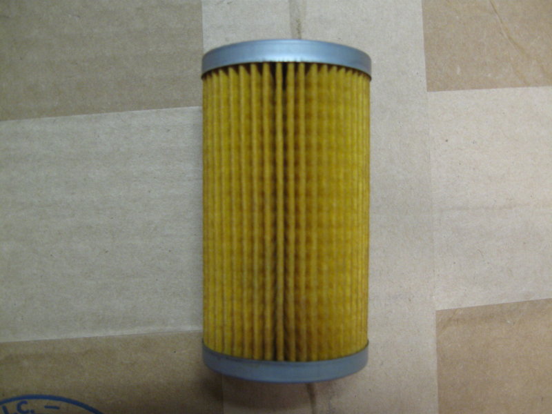

Ah yes a riddle. Now the scenario, then the questions.
For the past year - or better - my 2004 CK30 has had an intermittent, loss of power/erratic RPM issue.
Allow me to explain. This tractor is mostly used for short bursts of time & seldom used in extended time situations(more than 30 minutes continuously). The loss of power/erratic RPM's issue would only surface during continuous use, for greater than 30 minute time periods. Due to the 'characteristics of use' the 'symptoms' would usually 'show' once during a 6 month time period. The unfortunate part is, during an extended snow event was one of the times when the 'symptoms' came to the surface. The tractor has never been used for mowing grass, is kept in either a carport or garage & never stored outside in the elements. The engine has never totally died, if the engine did quit, it would restart....it would continue to run erratically, I never was stranded with a totally dead tractor.
What is the cause of the 'symptoms' and the 'fix'?
The discussion period is officially open!

I'd look at the fuel filter.
   / The Art of Delivery, fuel'd with questions...?
I changed the fuel filter each time the symptoms surfaced. The used fuel filter is pictured below. The engine would run OK with a new fuel filter until an extended use(greater than 30 minutes).
The owners manual states a fuel filter can be cleaned with kerosene. After this happened a couple of times I started soaking the used filters in kerosene and blowing them out with an air gun.

I fished around in the bottom of the fuel tank with a long reach 'claw', could not come up with anything. This is a difficult area to check because of the irregular shape of the fuel tank. After the most recent occurence I did drain the fuel tank and had a good fuel flow from the hose exiting the bottom of the tank.
After draining the fuel tank, I filled the fuel bowl with fresh fuel, replaced the fuel filter with a brand new, not recycled fuel filter and poured some fresh diesel fuel into the tank. The engine started fine and I let the tractor sit with the engine idling for 30 minutes and the engine ran OK. Then I went out to the compost pile to flip some leaves and the problem surfaced again. Using the loader would bog the engine down and the erractic RPM's would continue. Could not move the tractor without the engine bogging down. Even at a stand still the RPM's would flucuate.
Don

I've been concerned about wax, not ear wax, but the parafin kind that's in the diesel fuel. After the most recent occurence, just a couple weeks ago, when I limped the tractor back to the garage, I looked at the fuel bowl and it was only 1/2 full of fuel. This is when I decided to drain the fuel tank and replace the fuel filter with a brand new fuel filter. Were the fuel filters being plugged up with wax from the diesel fuel? I could not visually detect a waxy surface on the fuel filter. I had been soaking the fuel filters in kerosene and blowing them out with the air gun. Was this enough to clean the filters throughly? I took one fuel filter and heated it up in a pan of water to see if any wax residue would show up, after cooling the water down in the fridge I did not detect any wax residue.
Then there's the algae question. Had I developed these live growing organisms in the fuel tank? I could not detect any slime or foreign colors on the fuel filter. After draining the fuel tank completely and refueling with fresh fuel along with a new fuel filter I think I have eliminated algae as the culprit.
