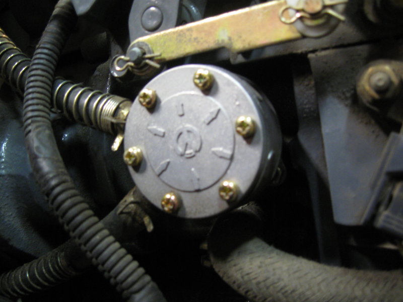

I did take the air gun to the fuel cap, don't know if dirt was dislodged but it did not seem to make any difference.
I think I may have gotten lucky. As wroughtn_harv says, "I'd rather be lucky than good". I made sure I had a replacement fuel pump on site prior to disassembly of the original fuel pump. I went ahead and installed the new pump. Tractor started fine, I let the engine idle for over an hour and a half, setting the throttle at different RPM's. Every thirty minutes I took the tractor out to the compost and moved and flipped the pile with ease and without incident. The fuel bowl stayed full of fuel! So far so good!
The one thing I noted when disassembling the original fuel pump was the six machine screws that hold the pump together were just 'snug'. It took very little pressure on the screwdriver handle to loosen the screws. I expected the screws to be super tight. Perhaps the fuel pump has been sucking air in as it heats up?
If I was good I would have checked those screws prior to dissassembly. Hopefully I've gotten lucky.
I've attached a picture of the new fuel pump installed.

I presume the fuel pump is on the engine side of the fuel bowl. If that is the case than I don't see how a malfunctioning fuel pump could be causing the fuel bowl to half empty. I can envision that a working fuel pump could suck fuel out of the bowl which could be replaced by air if fuel is not freely flowing from the tank into the bowl however. I vote with Michigan Iron. Why don't you put some real strain on the motor (flipping compost is like warm up exercises for a Kioti. Go chase a few Deere around the acres at PTO speed while mowing or tilling;)) and then see if the problem is solved. If so then maybe blowing out the fuel tank cap was the solution.

You know what happens when you presume things. :rolleyes: The fuel pump is inbetween the fuel tank and the fuel bowl. So the fuel pump is gravity fed from the fuel tank and pumps to the fuel bowl.......fuel passes through the fuel bowl/with filter then forwards in the direction of the engine, so the fuel bowl was really only half full of fuel that comes directly from the fuel pump. :)

So you are thinking that air was being sucked into the fuel pump and that is how it collects in the fuel bowl? Did you need to refill the bowl every time you lost power or did the problem resolve itself "overnight"?
I still think you need to test out your repair doing something a bit tougher than flipping compost!:D

So you are thinking that air was being sucked into the fuel pump after the the engine heated up and expanded the fuel pump housing allowing air to be sucked in and that is how it (the air) collects in the fuel bowl? Did you need to refill the bowl every time you lost power or did the problem resolve itself "overnight"? My thought is the problem resolved itself after the engine would cool down. The fuel pump housing would cool and contract enough to cause a good seal until the next extended use when the engine would heat up enough to cause the pump housing to once again expand and suck air in.
The other unknown is, if there is/was an issue with the fuel hose inbetween the fuel pump and fuel bowl.
