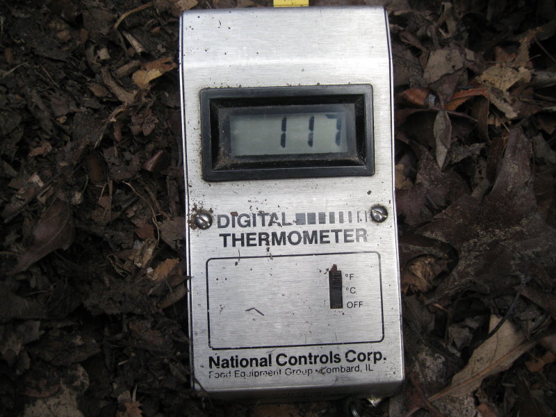

Have you ever thought of running some type of plumbing under that pile and circulating some fluid through it to heat the house?
What do you think the temp in the center of that pile is?
Phill
With an ambient outdoor temperature of 40 degrees today the temperature of the compost pile taken about 2 foot into the pile was 117 degrees. I've added a lot of fresh leaves to the pile over the last couple weeks so it's still in the process of 'heating up'.
The pile has to remain accessable to the tractor to flip ('oxygenate') about once monthly. Pipes under the pile would need to be protected from damage by the tractor/front end loader. The pile also needs to be kept in a moist state.
Most years the compost pile when covered with snow has bare spots showing up from the heat migrating up and out of the pile. I've been known to be out there flipping the pile in mid January to re-oxygenate the pile so it's doesn't compact down.
It would be an interesting project for a supplemental heat source.

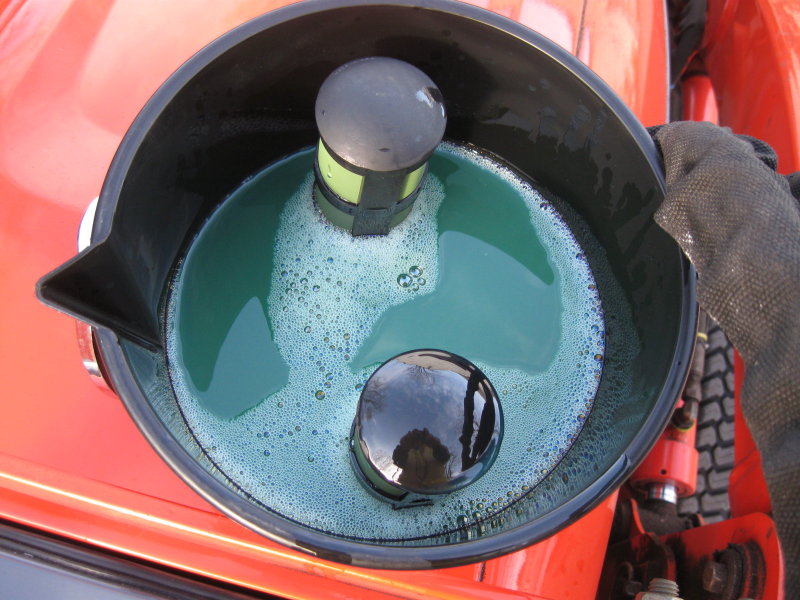

Since this fuel delivery issue has been dogging me I've wanted to purchase a Mr. Funnel (www.mrfunnel.com) to filter the diesel as it's poured into the fuel tank. I finally did and it was delivered the other day. I've read about Mr. Funnel here on TBN and the only concern was that the filter screen slowed down the fuel passing through the funnel. With the fuel cap located through the hood of the CK30 I did not want to extend my time holding a fuel can up over the hood any longer than necessary. I went with the largest size Mr. Funnel offers which has a dual screen for faster fuel delivery. The screens are off the bottom of the funnel about 1/4" to collect any water/debri that may be present. This 'sump' will also hold 1/4" of fuel if no water or contaminates are present. My thoughts are, if the fuel in the sump looks clean to pour it back into the fuel can for next use. The best price I found was at Amazon.com See the pic's.

You were smart to get the double filter model. I have the single and it slows me down as well as requiring constant monitoring. I now use a rotary pump from a thirty gallon drum so it is not easy to just pour back the half ounce that remains. I 'discard' it into a jar I keep for cleaning greasy stuff.
