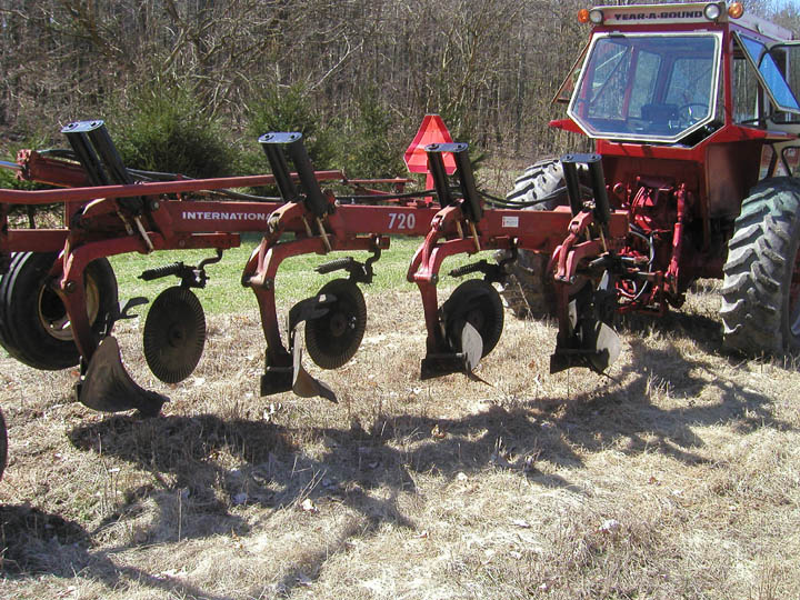

By the early 1960's, semi-mounted plows FAR outsold mounted or drawn plows. A semi-mounted plow gives the best of all worlds. It is EXTREMELY easy to "plow out" a dead furrow or the "lands" (headlands) with a semi-mounted plow. Just drop the front of the plow to normal operating depth, then leave the tail wheel at transport position, and you have NO dead furrow. Even a GOOD hydraulic controlled drawn plow is capable of the same results. The more bottoms, the easier and better the results.
In large scale farming, 3-point plows were obsolete for the most part by the early '60's. In most cases, size (# of bottoms) was too limited with 3-point plows.
   / The art of plowing #48
Here is a pic of my semimount IH. It's a very easy plow to use, much easier than the small two bottom Howse that I have. To me it's a thrill to look back and see about 6 ft of ground being turned over.:)

Man Oleozz. Your making me jealous. I have not pulled a big plow in AGES. Last time I did was about 7 years ago when I was helping a guy out during the evenings one summer. Real picky guy and he even let me fill the dead furrows myself. Like FWJ says... if done right you can never tell they are there.
