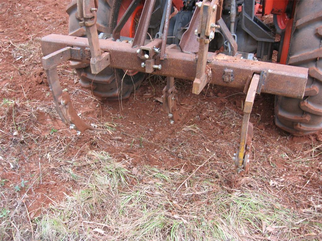

Rob, I don't know what you'd call that thing but it looks cool and it looks perfect for the job. I guess that it loosens things up enough to allow the disk to really dig in well. When I first started doing food plots I just used the rippers on my boxblade and it did a pretty good job. But grass and weeds was still a problem.

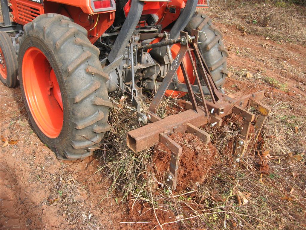

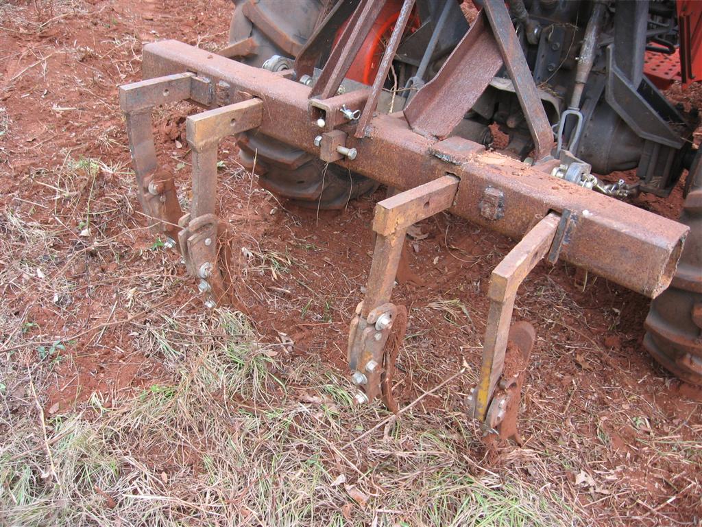

OK this is perfect...I call it a contraption because...
The plows are simple chisels
But it isn't spring loaded so it will tend to stay in the gound instead of spring out, so more of a subsoiler
the 4" tube is my unility bar version 1.0
The wild things on top are actually wheel guided/floating cultivators/sweepers. They are upside down. the 2 holes would be where the wheel mounted, above that is the mount for the chisel.
Or look at Shirleys husband pic and see what they were before. I simply use them as weights, they slide right off the bar (actually for row adjustment width)...as you can see in shirleys picture. Good picture to see.

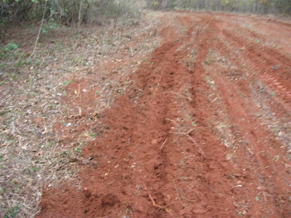

Another pic of mine and they make a good rake...then to break up the ground for a new plot.
