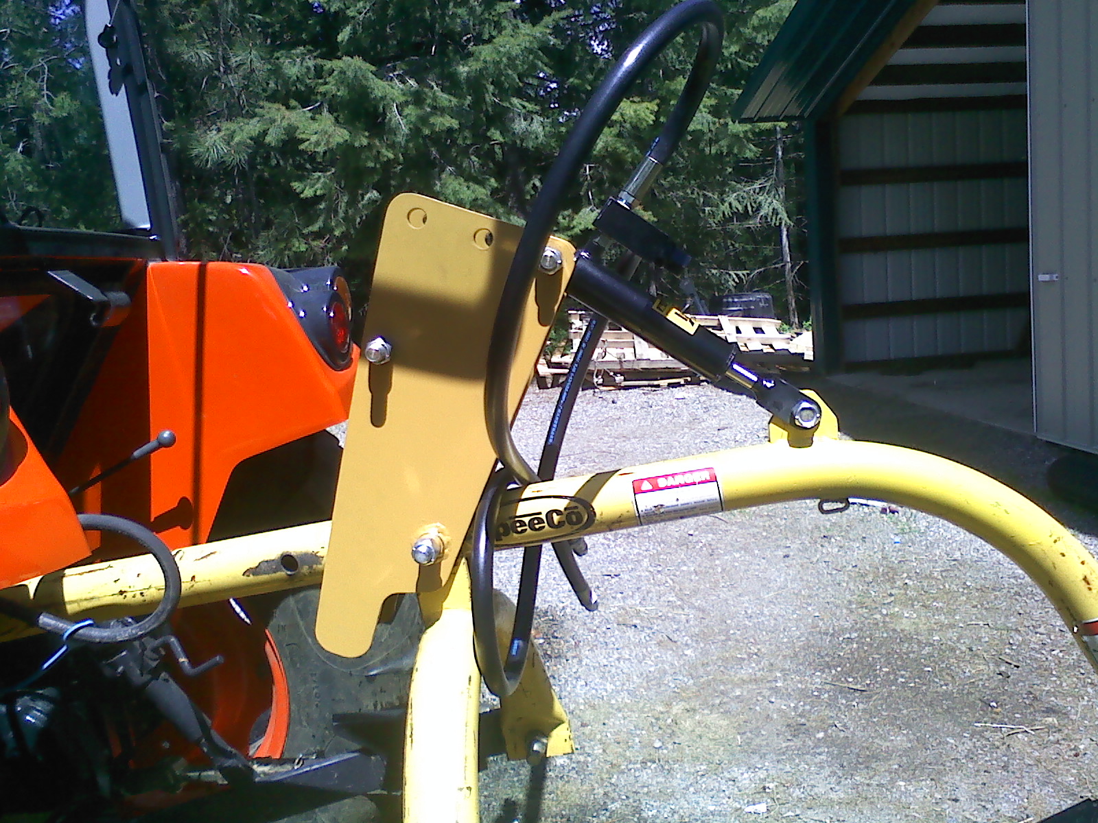

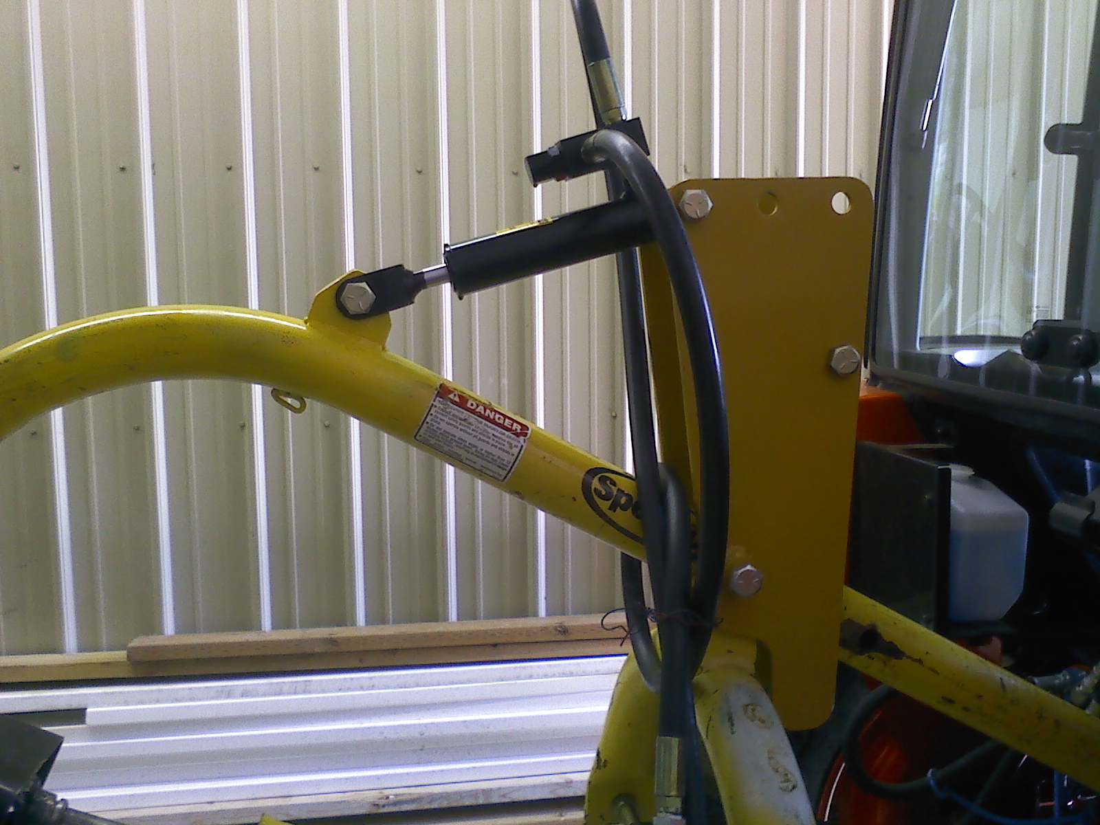

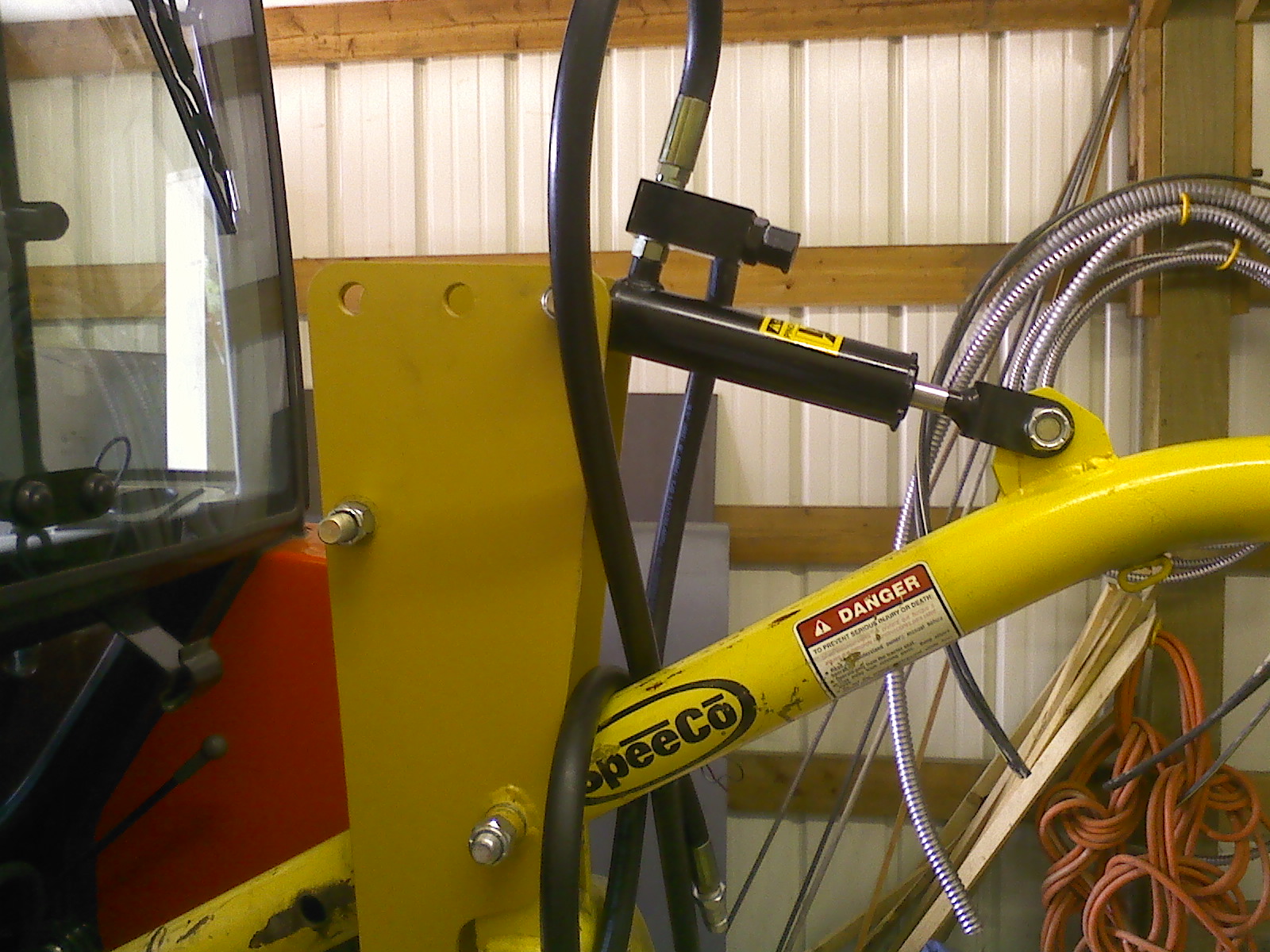

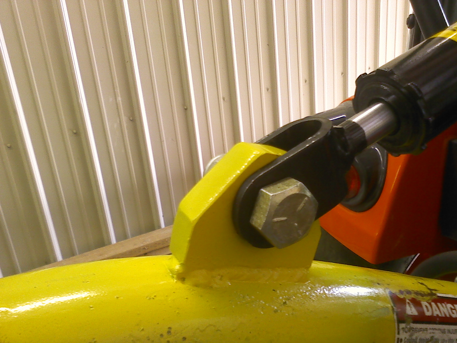

I have a Speeco unit and mine quit digging 2 seasons ago. I have decomposed granite and digging is a chore at any time. I ended up replacing the entire auger when i noticed that the entire end of the cutting area (ie the first 6-8" from the tip) had been worn down so much as to be an inch narrower that the rest of the flighting.
It started to dig alot better after that, but still sucked overall. I added a power down assist unit to mine, but Speeco didn't have the exact model to fit my 10 YO auger so i had to modify it. But MAN does this baby dig now. Its a single acting down assist so i don't have to worry about burying the thing. All i have to do is lift the 3 point and the down assist quits.
I was told it adds about 300# of down pressure (and can be adjusted for more/less) . It drills a hole FAST.
