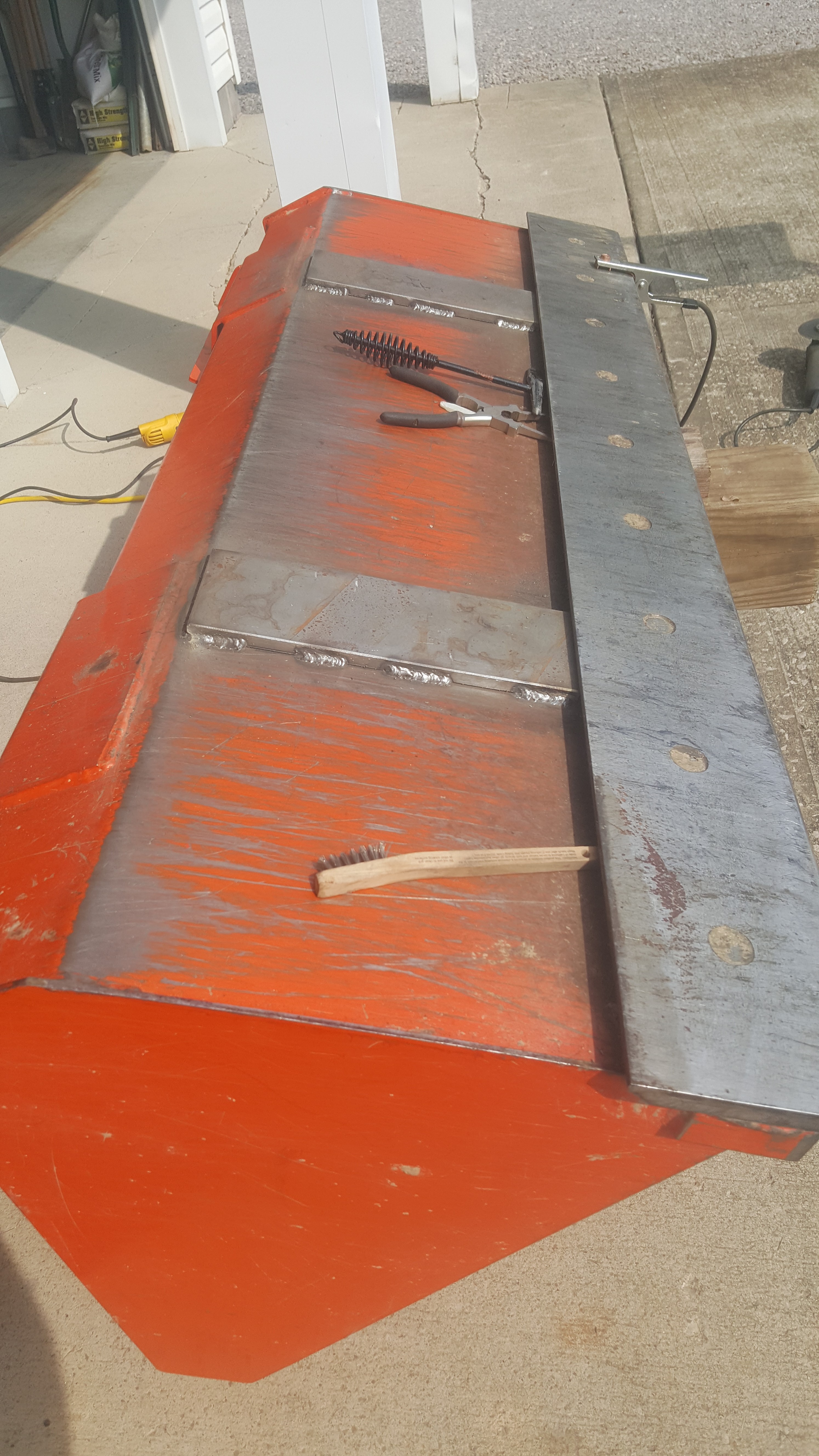

This is a really good way to beef up your bucket with a 5/8" bolt on cutting edge, and a pair of 1/2" wear strips welded on the bottom. Really takes the wear and strengthens the bucket.

That is a nice addition you have there. The outside of the vertical side plates on mine is really getting gouged up as well, I am getting triaxle loads of demolished concrete buildings and as I push into the edges of the pile the sides are plowing concrete away and taking on deep gouges. I think I am going to just do the old fashioned tried and true method of using the welder to law down stripes of beed along there to give a wear layer that I can replace as needed. It's not pretty, but it has been working on commercial equipment for longer than I have been alive.
I am planning to get the piranha bar from BXpanded, I'll have to heat and straighten my factory bucket to get it on, I've already bent the center down pretty good :laughing:
I'm not upset about bending the bucket or gouging it, I realize why I bought the machine and what I am doing. They make new buckets every day. That said, with some weld bead and the piranha bar it should at least last a few years before I need to look at buying a replacement. Loader buckets used in doing what I am going to do are considered a wear item. At some point you make the call to start welding plate to it or to replace it. Lucky for you and me... we have the ability to make that choice and weld up as we please at home.
