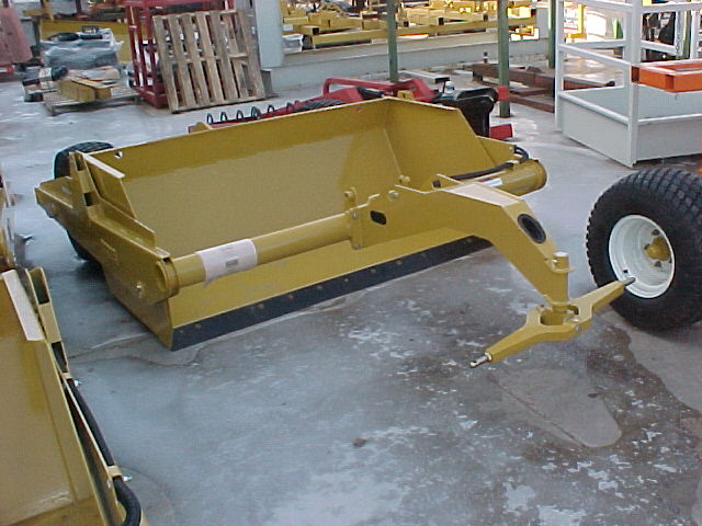

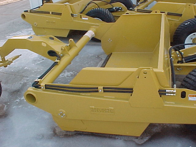

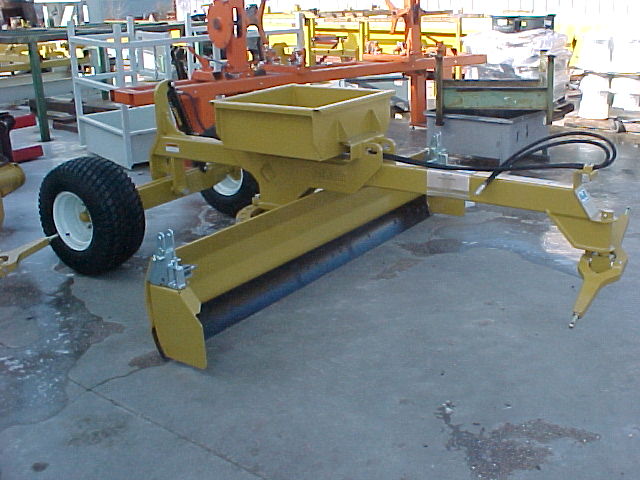

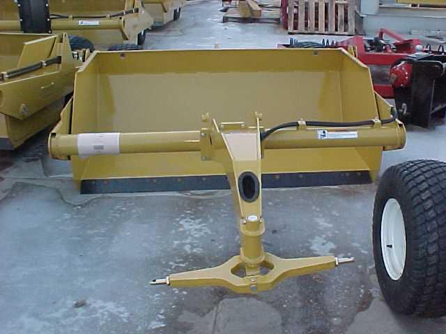

WVBartMan, I do not mean to hijack your post. I went out to meet him and learn a little. As much dirt work as I do I am getting one. He does not belive in under cutting the dealers. But will sell to any one at list price. He said he will be a the big farm show in CA. and Lousville KY after that. I took some close ups to share.
