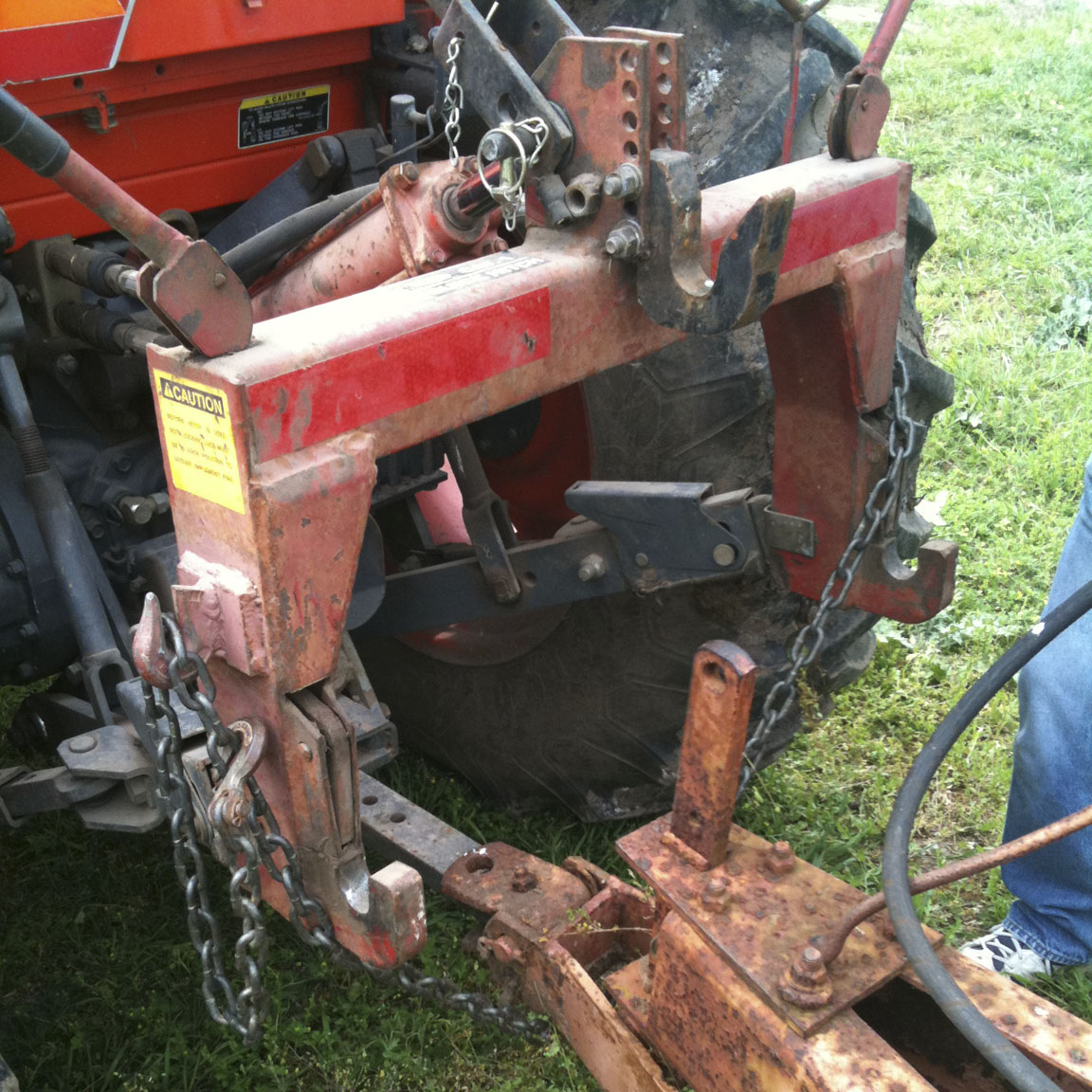

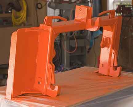

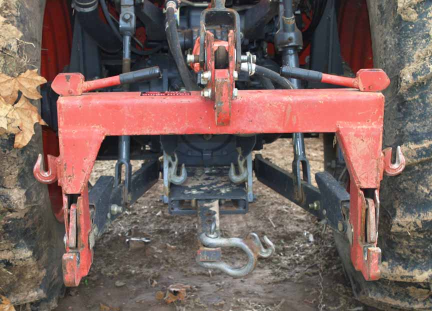

I have the Speeco and also a John Deere iMatch and love them. We live in farmer country and all the farmers here use the big CAT 3 quick hitch. They can back up to the equipment, lift and go, without leaving the cab. Seriously. I can do this on some of my equipment, and on some, like my shredder, I have to get off the tractor for the PTO and top link. The time spent adjusting my equipment was well spent.
The hooks welded to the side of the hitch have been very handy. In one photo here I use the quickhitch with a chain to lift the very heavy hitch of a 14' disk up to my draw bar. The orange hitch is a JD iMatch to which I added a Bobtach connection.
