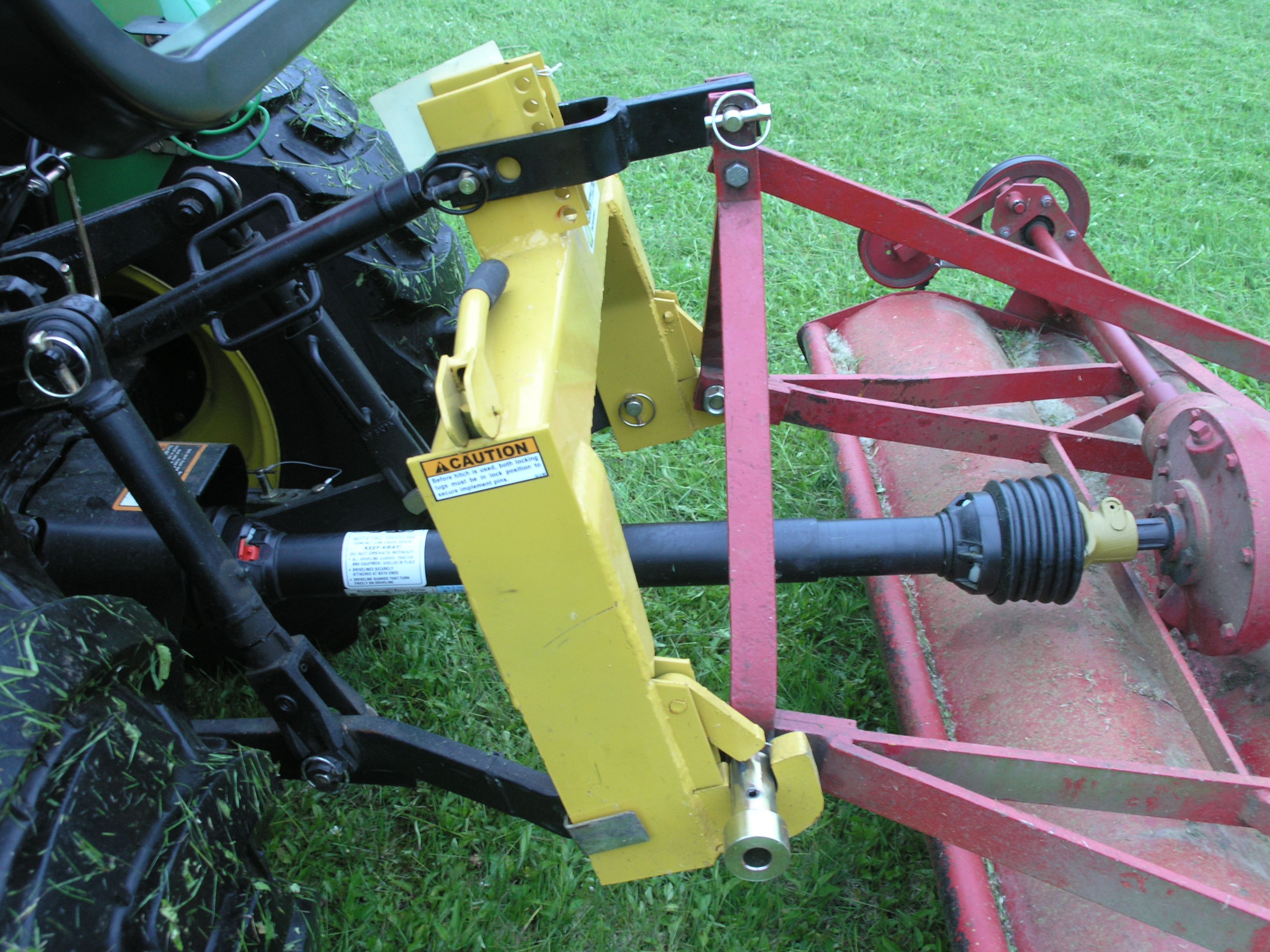

   / The Best Quick Hitch??? #14
Well, I've used them all. I dumped my Pat's in favor of standard extendable links. I like them much better but that's just me. Oh, and my wife likes them better too and she farms more than I do. The cat's meow is the iMatch style actually. However, if you own older equipment if may need to be modified to get the top link hook to work. Alternatively, if you have a landpride or Speeco you can always remove the hook like I did the other day to run my 40+ year old flail mower. I will be modifying the top link pin to work with the hook but really needed the flail the other day. See below

   / The Best Quick Hitch??? #15
Waaay off topic but, charleyfarmall is that an old Alamo flail? I've been having trouble finding a belt and bearings for mine. Any source?
Got the blades and belt pulleys.
