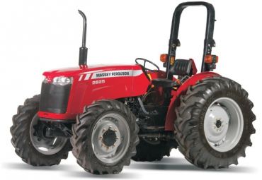

Mahindra 4035 (CUT), Mahindra 5035 (UT)
Kioti DK45S (CUT), Kioti DK55 (UT)

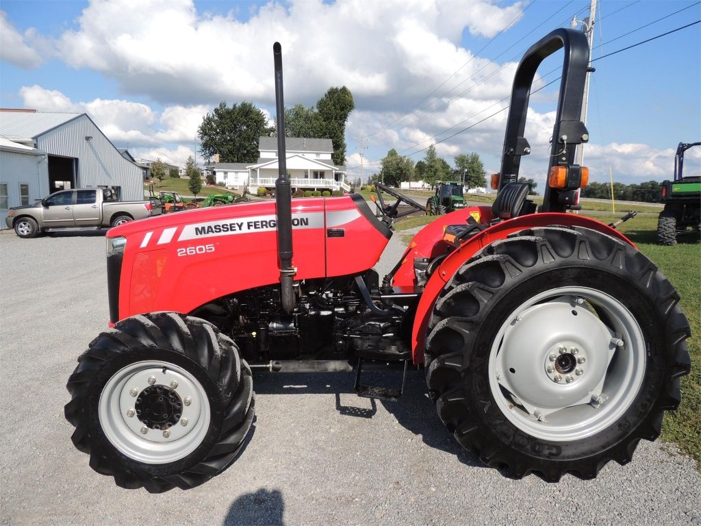

And perhaps there is one exception to the rule (you always need an exception). Someone previously mentioned the MF2600 series. Well the 2615 and larger have 24" front tires in 4wd. But the 2605 has little what look like 16" up front (on edit: after closer inspection of pictures they look closer to 20") and only weighs a shade over 4000 pounds. This is splitting hairs but I'm going to say UT only because it sits on the same frame as the 2615 which is clearly a UT.

Sorry, I was typing stream of thought on my iPhone. So how would you classify the 2605? After all, I have no special tractor classifying credentials. I could easily flip flop on the 2605. for the sake of consistency I probably should.�� Ok, u talked me into it
   / The blurry line between CUT and UT??? #59
Before classifying it, I would want to confirm front tire size. Massey don't list it and I couldn't find a spec anywhere else.
Hard to believe they would make a huge jump in sizevs the other tractors on the same platfom. Would need different gearing to make 4wd work.

I couldn't find it either. Here are pictures of the 2605 and 2615. The 2605 doesn't have 24" rims up front but they do look larger than 16". Might be 20's. Guess someone who is close to a real 2605 can verify.
