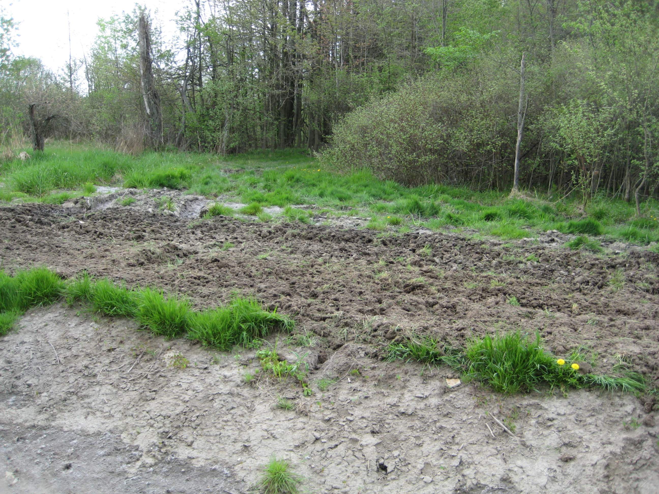

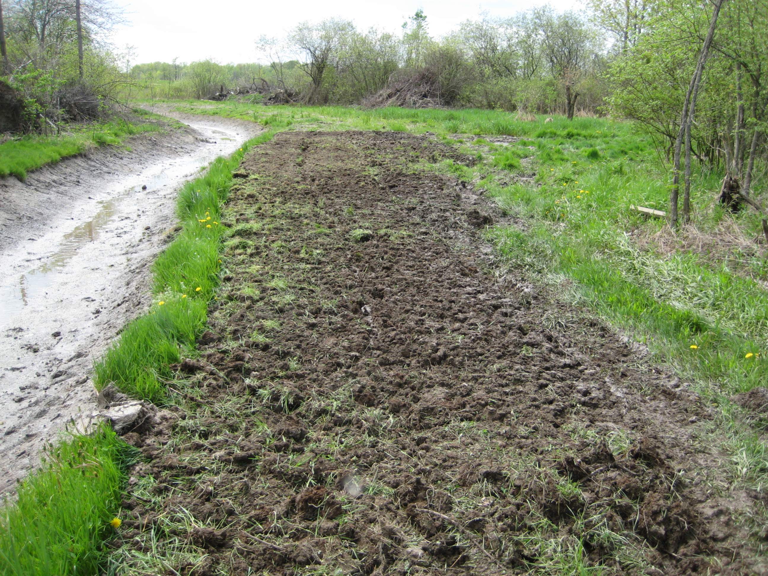

This week, I started tilling next to the creek, hoping to drag the loose stuff away with a back blade on the bigger tractor. The tilling went fine, except for finding rocks and logs, but the International won't stay running long enough to take it any further. I need to drain out both sides of the gas tank; There's a 1/4" line that's supposed to keep the fuel level equal on both sides, but it must be clogged with debris so it takes about 10 minutes after it runs out of gas for it to start back up again. I've blown the line out before, so next week I'll be taking the petcocks out of both sides to clear them.
We'll see how things go next week!
Thanks for your comments, and any suggestions.

I guess I would wait until later in the summer to do that work, I am assuming it dries out then.

They did a pretty good job on the ditch, but the operator did you no favors by spreading out the excavated soil, grass and weeds. He changed the natural flow of the surrounding area and the organic, poorly drained material makes grading much more difficult...as I'm sure you've realized by now.
Leave it to a municipality to fail in an attempt to let water flow downhill.
