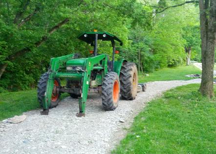

I did a bunch of looking around for a set of tires (at a decent price) that would have deeper tread and better flotation than my current set. Eventually I got pretty lucky on a set of 18.4-26 R2 (rice and cane) tires and wheels that had come off the back of a JD combine. I drove about an hour, plunked down $600, and drove home with a set of basically new tires...no measurable tread wear at all!
Do these tires match the required ratio for the 4 wheel drive?
They do now! Yesterday afternoon, good ol' Spider Tractor was looking a bit hungry. A couple hours later I found that he had eaten a neighbor's Kubota...and kept it's rear tires as trophies.
Haha, what was a Kubota rear tire/wheel is now my front tire/wheel. Must have been a cute little tractor. ;)
Now I just need to add some loops to the rims and paint them a proper color. :D
Fronts are now 12.4-24 Goodyear Dyna Torque II R1s on 10" wide rims.
Big step up from the old 9.3-24 Treadura tires that the tractor came with!
