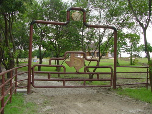

The hole in the bottom is for the camera. It, the hole, is two and half inches across and three inches deep. The camera is two inches in diameter and two and a half inches deep. In the back of the rock a rectangle is cut out for a weathertite electrical box. And there's a five eighths hole between them.
I've still got to color the star rock with the torch so it'll look like the Texas one. I was lucky to get it up before the water came down. The place is a muddy mess.
It was a little bit of a challenge to install it by myself. But Lucy was there and she's so willing and capable. /forums/images/graemlins/grin.gif

Here's the star after I "Painted" the surrounding surfaces and left the star out of the fun.

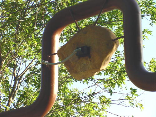

The other day I ran the coax and power cable from the cabinet to the star. I used some liquid tite between the overhead where I'd welded on a nipple. And a weather tite box that I'd screwed and siliconed in.
Here's the north end of the southbound star.

This is the southend of the southbound.
I had two bags of grout from tiling our bathrooms, different colors. A little of this one and a little of that one, some water, and I love being lucky more than anything. Don't ask me how but the color came out close.
What I did was use some packing foam to position the camera in the cavity. Then I grouted in the part that would show.
This way if there's a problem it will be easy for the security crew to chip out the old grout and free the camera.
